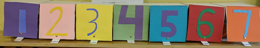

Step 6: Decorate the Museum Room Doors
  1. Cut construction paper to cover each door on the outside.
  2. Create labels for each door to indicate the theme of that room. Glue them in place.
  3. Add "Lift" tabs at the bottom of each door.

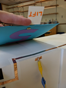

  3. Wire the museum room doors: run the tape on the inside part of the front door of each museum room, starting at the bottom and working the tape up into the “ceiling” of each room. Have that tape extend to the back of the room, covering the length of the ceiling. At the end of the ceiling, continue to press the tape down about 1” from the ceiling. Leave a “tail” copper tape that can be slipped through a hole in the back of the museum room and folded over the hole (that is where the alligator clip will be attached to the back of each museum room).
  4. On each museum room door, make a hole where the tape begins, and poke a copper brad clip through it so that the brad “button” is on the outside of the door. Open the brad so that it is touching the copper tape on the inside of the door. Make sure that there is contact, adding additional copper tape as needed.

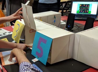

Step 9: Connect the Makey Makey
  1. Clip alligator clip to flap on “ground” copper tape
  2. Use alligator clips and jumper wires to connect the Makey Makey to the back of each museum room
  3. Use the back of the Makey Makey and jumper wires to have enough connection points for the inputs
  4. Connect the Makey Makey to the laptop or computer
  5. Check your Scratch program to make sure that the event block type matches the Makey Makey connection point (eg. space, up arrow, w, etc.)
  6. Open a museum door wide, press down the door’s brad against the copper tape on top of the room and test it out!
