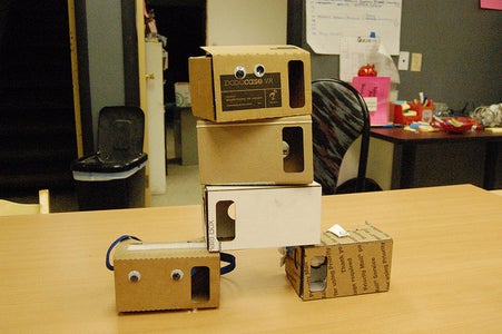

I decided it would be fun to build on one of the limitations I found during our previous Buildnight with Dodocases Google Cardboard VR, Some apps want a magnetic switch or a screen tap to advance. which didn't work well on some phones, and on my upgraded ColorCross Android Phone Virtual Reality Rig and also on my Retro "Brass"Viewer

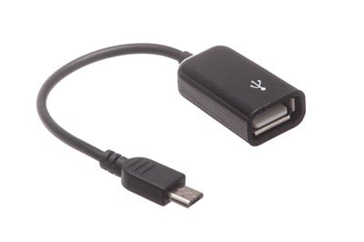

  • 1 OTG Usb cable. (easy to get on amazon), Mine has a power pass through its nice but not needed for this!
  • 1 Android phone that supports USB OTG (a google search for your model and USB OTG, will likely tell you, most phones in the last 2 years or so support it, although some tablets and older phones have a different cable. (mini usb, or samsung 30pin)

USB OTG plugs into the USB/Charging port on most phones/tablets (a very few have a special OTG port already built in with a full sized usb plug, for flash drives or mouses/keyboards. In that case its already ready)
A great way to test it, is to connect a usb optical mouse to it, if it powers it up, your good! you should see a little mouse pointer popup and you can do anything that would take a touch input by mousing over the items and clicking, or clicking and dragging.

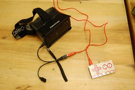

Next Connect the Makey Makey's Usb cord (mine was red) to the OTG adapter, and see if you get the mouse cursor again when you hold the conductive "earth" strip and tap the 'Click" circle. If so its working!

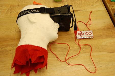

You can load the Google cardboard app, and try using the makey makey to simulate tapping on the screen to launch the mini applets inside, most want a double click, Google earth(tap to start/stop flying), photospheres(photo advance)
When you are in Virtual reality its good to have inputs close at hand, so now that we have a way to make anything that will conduct a teeny bit of signal from the Makey Makey's ground, to one of the switches, or (mouse /arrow key input plugins on the front and back of the Makey Makey.

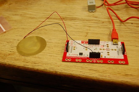

Another Thought on inputs we found that Piezoelectric speaker, could also be used to make tap inputs. might allow for tapping on a table, punch or poke or tap targets using the makey makey.
