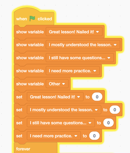

Once you've created variables, make sure you've set all the variables to "0" and have each variable show by adding these blocks to a "when the green flag clicked" block.
Educator Tip:
If you are teaching students how to make these, make sure you talk to them about triggering events and setting the variable to zero when starting a game. Ask them questions about creating these variables.
Example Questions:
"If you don't set each variable to 0, what do you think will happen?"
"What are other events that might set the variable to 0?"
"How else could you use a variable in a game?" (Hint:This is how you create scoring in Scratch!)
