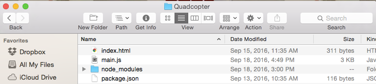

Step 2: Create Project
First, create the folder where you will be keeping the project. To make the guide easier to follow, name the project "Quadcopter" and place it on your desktop.

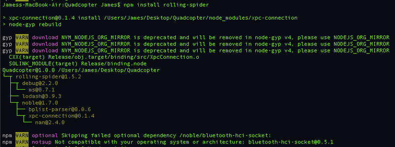

Now you should be able to install the rolling-spider library.
In the terminal, enter the command:
npm install rolling-spider
And then:
npm install keypress
If these commands are successful, your project folder is now set up and ready to be programmed.

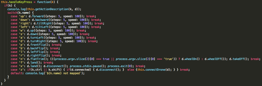

Step 3: Create Commands
To get a simple version of the controller, go to https://github.com/James-Hynes/SimpleDroneController and click
Clone or download -> Download ZIP
After it downloads, unpack the file and copy the "main.js" file into your project folder which should be already set up.
To run the program, simply go into the terminal, navigate back to your project folder using the "cd" command, and then run the command
node main.js
The terminal should find the nearest drone and immediately connect to it. You can look in the "main.js" file to find the controls and manipulate them as you like.

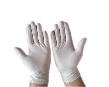

Step 4: Step 4: the Glove
We used a 5mm thick rubber glove for our left side controller. We recommend using a thicker glove like a gardening glove to avoid frustration. This controlled the drone’s altitude and rotation. The controls were as follows:
Thumb: “Earth”
Index: Raise Drone
Middle: Lower Drone
Ring: Turn left
Pinky: Turn right
When the thumb touches any of the other fingers the makey makey circuit is complete and the corresponding action is translated through the computer to the drone. The glove is made by first cutting a hole in the thumb for the makeymakey’s “earth.” Next attach a piece of tin foil to each remaining finger. To each piece of tin foil, attach an alligator clip and clip the other end to the makeymakey.
