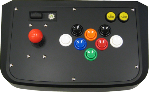

Step 2: Step 2: Development of a Robot Control Panel
Once we had the breadboard concept tested, we decided to mock up what a real control board could look like using computer aided design (CAD). We used Autodesk Inventor Pro 2015 to design a potential control board and a screen shot of the design appears above.
