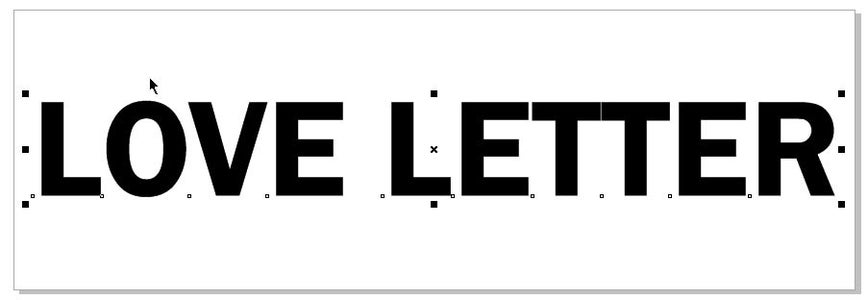

Decide on a cool message. We're using the text 'Love letter'. Hey, you never know.
If a letter is used more than once you need to design a file that connects the two letters somehow.
Design Workflow (Corel Draw X5)
1. Type your message .
2. Convert to curves.

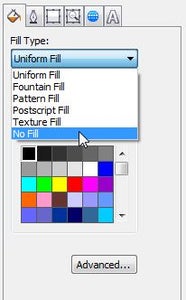

3. Change Fill to "No Fill." Change Outline to "Hairline."
4. Connect letters as necessary.
5. Export to .pdf for vinyl cutter.

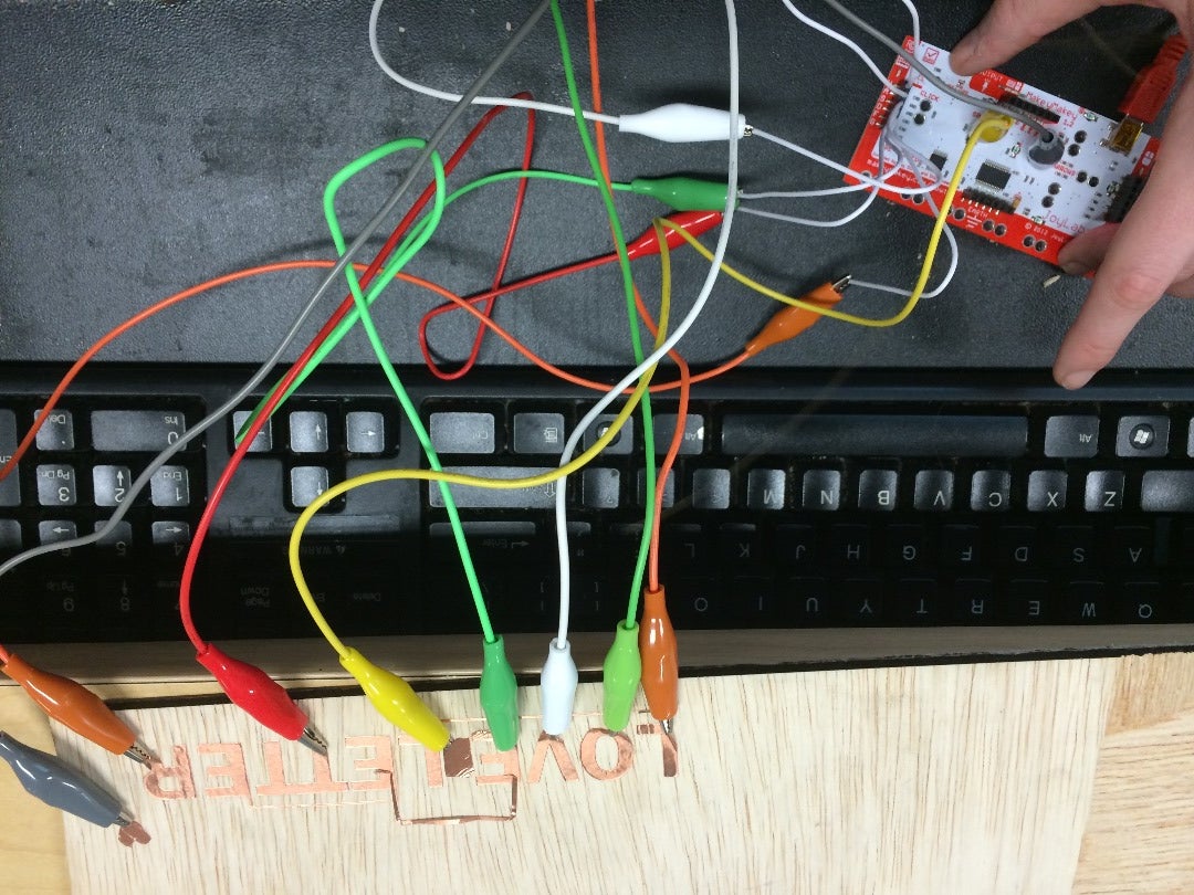

Step 6: Pulling It All Together
Assemble as shown! Bet you can't see where I screwed up ;)
In this case, the little heart at the end is acting as the enter key. Start up Natural Reader and touch each letter while touching "EARTH".
Obviously some improvements could be made so stay tuned for a future Instructable with a more elegant build!
