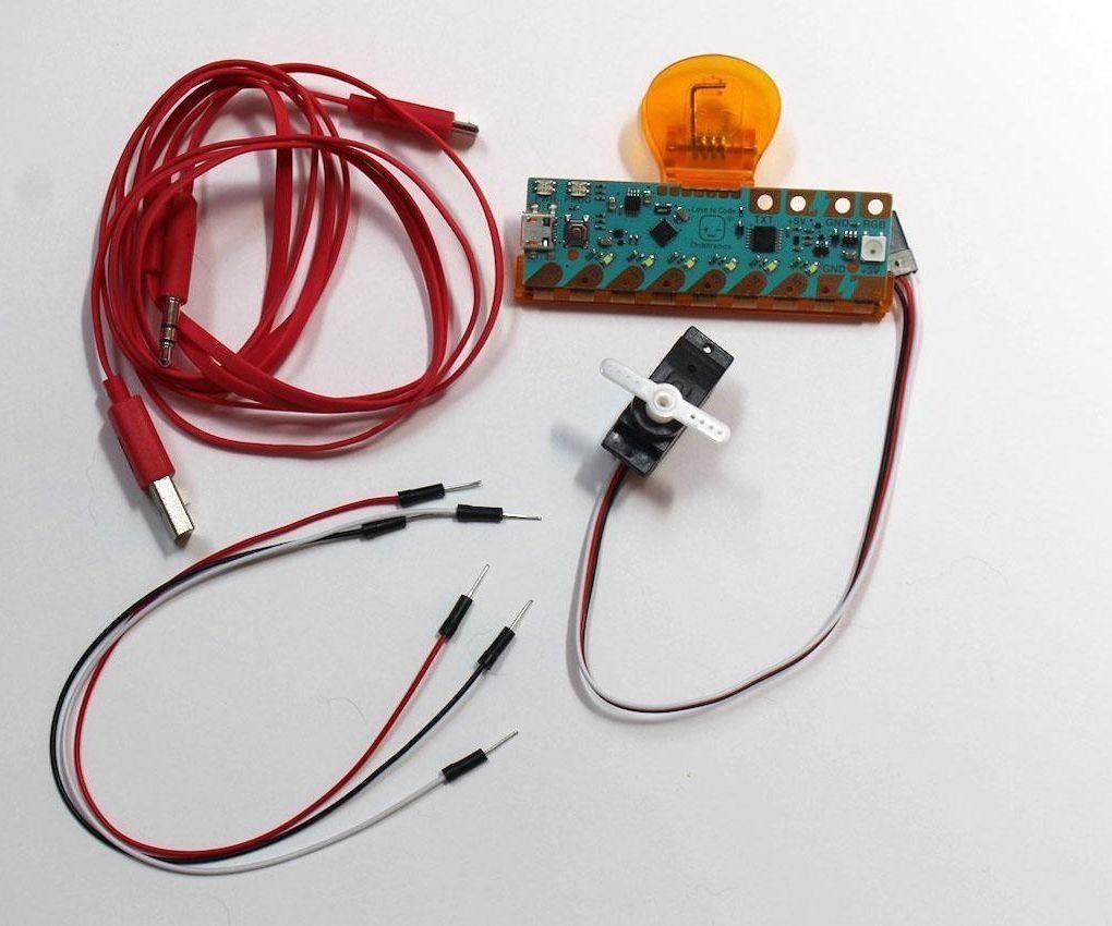

Step 1: Connect Makey:bit to the OLED
Insert the AA batteries into the Makey:bit.
Attach the OLED to the Makey:bit.
There are four pins to connect between the OLED and the Makey:bit. They are marked SDA (which stands for Serial Data, connected by the white wire in the photo), SCL (Serial Clock) (connected by the yellow wire), VCC (red wire), and GND (black wire).
