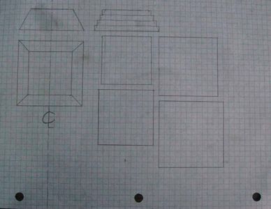

Step 2: Design Your Object
I made a simple flat top pyramid. but you could make other shapes.
Using the pyramid as an example. Lets say your foam is .25 inches thick and your object is one inch thick that means that your object will be four layers thick.
To begin draw steps over your old drawing as in the photograph above.
Measure the distance between each step.
Than draw out the distances between each step to size the layers as in the photograph above.
