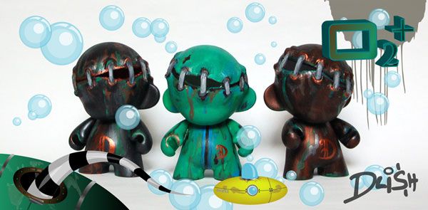

Step 4: Stitchwork
Step 8: Sculpting (part II)
This part is also one of the more fun parts of the project. Roll a bunch of skinny strands of Super Sculpey that are the same thickness as the grooves that you cut out of the hemispheres in Step 5. Essentially, these pieces are going to be made to fit into the stitch grooves made earlier.
Stick the little roles onto the stitches. They will hold in place easily, but it is best to use a tool or your finger to really press the stitch into place. Do every stitch except for the ones covering the incision. On this part, sculpt some drips and place them in the incision. The reason we do this is to allow you to get a good angle at painting the entire drip. The drip is secured by just folding the piece into the inside of the vinyl toy and using a flat tool to ensure good contact with the toy.
Step 9: Curing (part II)
Use the heat gun to blow on all the stitches again for five minutes. Allow them to cool again.
