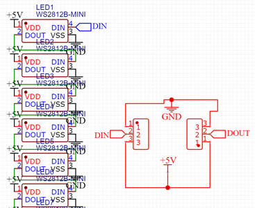

Step 2: LED WS2812B 3030:
I used ws2812 Neo pixel led, which comes with integrated ic so that we can address each segment separately. Not only the LEDs are addressable but also the color can be changed per pixel changing the digital value between 0-255(8-bit value).
This led comes with 4 pins, the configuration of pins can be seen in the picture mentioned above. Also, these Led’s come with Data IN and Data OUT function, which make them more interesting and through this we can join them to show text or data.
Specs: Small, 3.3volts-5volts, 20mA and addressable.

Step 4: Circuit Diagram:
I designed the circuit in EasyEDA for each segment here I am using 3 LED’s. So, a total of 21 led’s per panel is required to make this configuration. I made the connection pins at bottom layer so that the connection and wiring is not visible to second person.

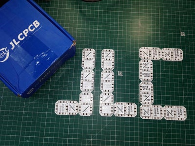

Step 5: PCB and Gerbers:
Here is the designed panel, I displayed my name with JLCPCB as a sponsor and good friend.
https://jlcpcb.com/SSR
White color PCB, 1.6mm thickness and HASL finish is looking pretty damn good with JLCPCB SMT Assembly service. These Boards are fully assembled by JLCPCB, means all the components and soldering work is done by them. Why not to try this offer, JLCPCB SMT assembly service is staring from $8 and if you sign-up using this link, you will get free coupons of worth $30 and newcomer rewards.

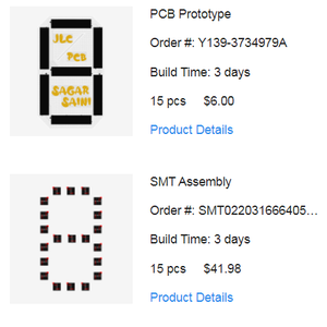

Step 6: Is JLCPCB SMT Assembly Worth:
JLCPCB is the only PCB manufacturer providing SMT service in very cheap, yet the quality of boards is very good. I tested my all the Boards and they are working fine, all the components are okay. The soldering work is outstanding and cost is very less. https://jlcpcb.com/SSR
I ordered 15pcs of these assembled boards just in $48, the cost of components is $27 + cost of PCB ($6 for 15pcs) + Cost of assembly+ stencil+ soldering ($15). Which turns out to $3 per Piece, but if you order the boards in quantity say 30pcs the cost will not be 2x, that will be arranged and the total cost of panel would be near $2.30.

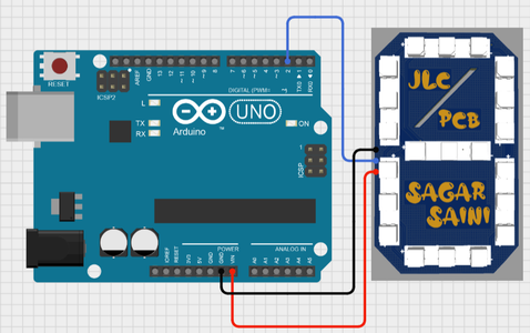

Step 7: Connection With Arduino:
These are the connection of testing purpose only; I paired the panel with Arduino using this schematic here. You can use ESP8266 or Esp32 for bigger projects.
I am using cirkit designer software for along time, I think this is the best way to express and present the circuits. You can use this wire diagram, breadboard circuit along with custom component creating in school and college presentations. Also, Code compilation, BOM and some new components are recently added.
