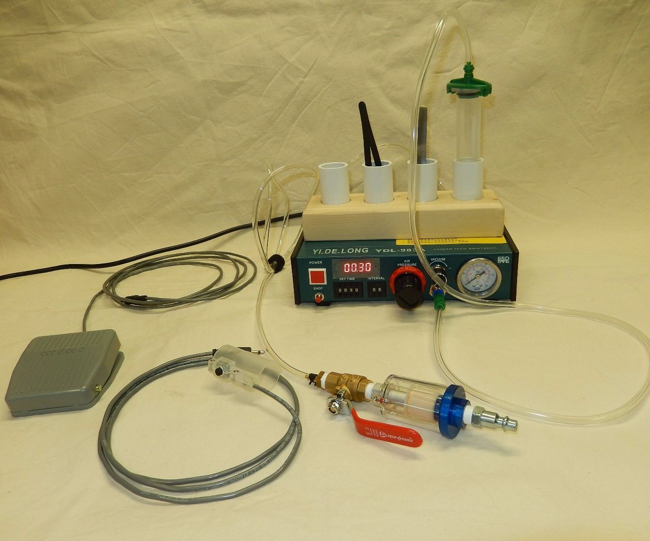

If you are interested in an Instructable on setting up a solder paste dispenser for SMD projects check out this one I just recently published

If you are interested in an Instructable on setting up a solder paste dispenser for SMD projects check out this one I just recently published.
