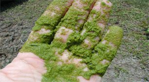

 In a small Petri dish, or any wide-mouth container, take a small amount of algae out of your supply.
  • Add a small amount of water, just enough so the culture “floats”
  • Let the algae sit in a warm, sunny place, on a windowsill for example.
  • Then adding nothing else, watch the culture for a few days.
 Does it grow, or does it die?
  • If it grows and/or doubles in size. Stop. You’ve completed this section.
  • If it dies, try again.

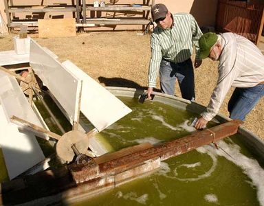

Step 3: Growing Algae for Oil
Once again, attention to detail and keeping good notes is what is going to set you apart from success or failure.
 At this point, we need to assume the following:
  • You have an identified oil bearing species of algae
  • You’ve been able to get it to grow on its own.
 At this stage, we’re concerned with maximizing the growth of the algae. Algae will propagate on its own of course. But our problem to be overcome is to be able to grow enough algae to meet our needs. This is one of the most difficult aspects. Not maximizing the growth of algae, per se, but growing ENOUGH algae to warrant the time, expense, and trouble of growing algae for biodiesel production.

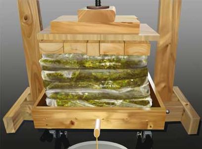

       A handful of dried algae.
       A garlic press
Fold the algae upon itself, and pack it into the garlic press. You don’t need a lot, just keep folding as much algae into the press as you can.
When the garlic press is full, simply slide the plunger over the algae, and press with all your
might. You may need to fold more algae into the press, if so, put more in.
Sometimes, the oil, being vicious, may take awhile to work its way out.
Keep pressing.
If even one drop of oil comes from the press. You’ve succeeded.
In reality, you should have more than that. But even one drop is a success.
