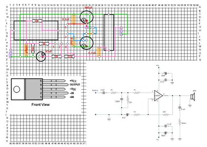

Step 1: Schematics and Parts
As the schematics of the amplifier and power supply circuits in the Elliott Sound Products webpage, it's not a complex amplifier as seen in the drawings above.
With LM1875 and several common RLC components, you can easily make the power amplifier by yourself.
The followings are key and noteworthy parts of the audio amplifier.
-     2.2uF coupling film capacitor (More than 100V)
-     220pF mica (or ceramic) capacitor for bypassing RF interference to ground
-     20K dual-gang potentiometer for volume control
-     0.1uF film capacitors for power supply bypassing and Zobel network support
-     220V input and dual 15V AC output toroidal transformer
-     4,700uF AC power filtering electrolytic capacitors
-     Diode bridge rectifier
-     And other Resistors and Capacitors included in the schematics
-     Universal PCB, metal supporters, bolts/nuts, and Acrylic boards
When comparing other LM1875 amplifier circuits, the schematics I used require relatively less number of components for making the power amplifier.

Step 3: Making Amplifier Circuit
As shown amplifier circuit using TDA2030, the overall wiring diagram is similar for the LM1875 as shown in the previous Instructable.
https://www.instructables.com/Audio-Amplifier-Using-TDA2030A/
The wiring diagram above is used for the amplifier that sound quality is a little bit low than another.
Maybe the reason for the amplifier producing less sound quality is that probably I had used salvaged common RLC components from other old amplifier circuits.
When you look at the YouTube videos about sound quality comparison among TDA2030, TDA2050, and LM1875, usually slight oscillation is created by LM1875 at high note audio signals.
I'm supposing that symptoms are increasing when you use comparatively less quality RLC components for making amplifier.
As shown in the previous Instructable, I'm using the same split (+19/-19V) power supply circuit for both LM1875 amplifiers.
The sound quality of the other LM1875 amplifier is crispier for the high note audio signals and likely heard more dynamically.
For making this better sound supporting amplifier, I had used brand new and higher quality RLC components.
Step 4: Component Wiring Result
The picture above is showing the wiring result of a less performing amplifier.
I remember the Solen coupling capacitors are soldered to a certain amplifier and subsequently desoldered for reuse.
The most of RLC components are salvaged from other old amplifier circuits.
By several times of soldering and desoldering, excessive heat is supposedly degrading the quality of these RLC components.
As a result, the overall sound quality of this amplifier is a little bit less performing than the other.
