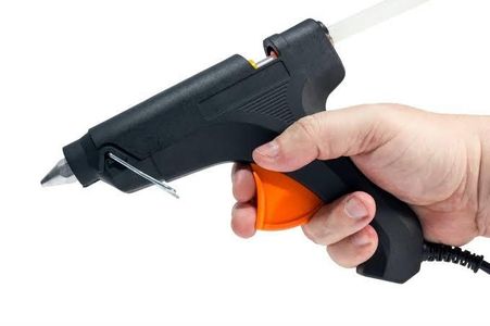

  • Hot glue
  • Super glue

Putting everything together is like assembling a puzzle. You need to be careful with the order of layers you want to make.
In our case, the sighted students were using the glue while the blind were feeling the different textures as the piece was being constructed.
