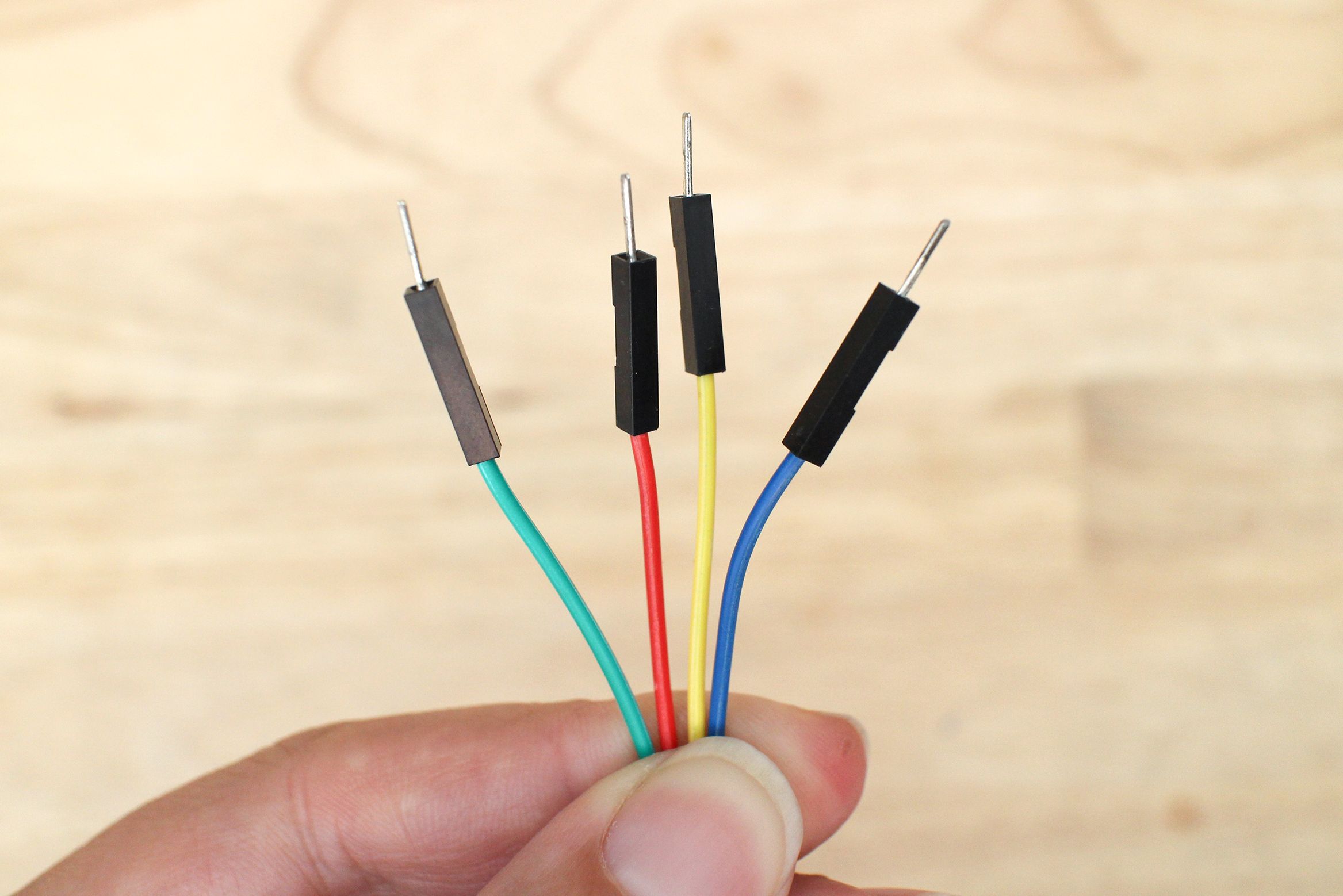

With most Arduino boards, like the Arduino UNO pictured, this is achieved by using a breadboard along with jumper cables that have male headers.

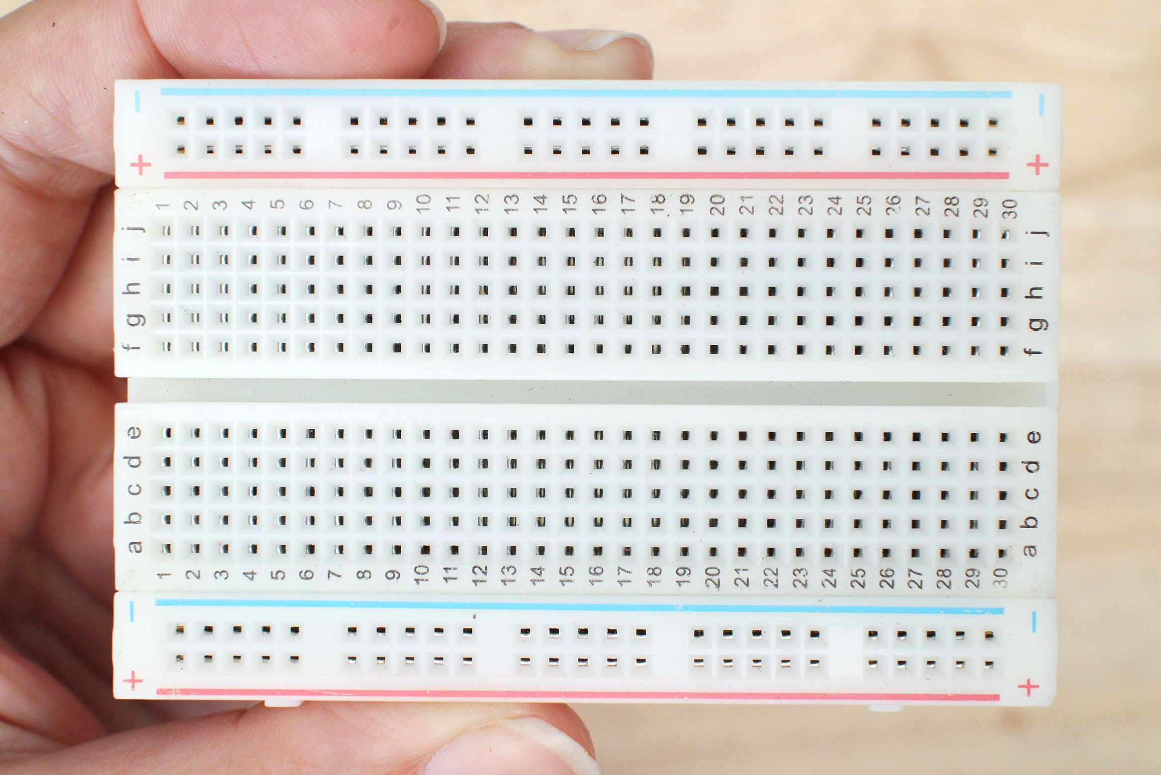

What is a breadboard? It's a board that helps you connect wires. The holes you plug into are connected inside with metal so you can connect two components by plugging them in next to one another. It's an essential tool when experimenting with circuits.
Breadboard

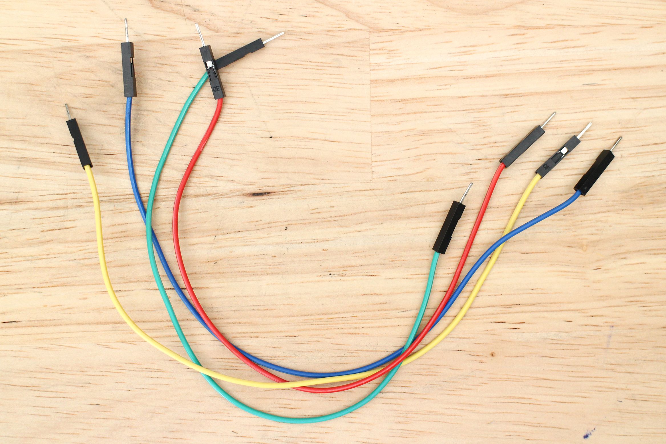

Jumper cables
Male headers on the end of jumper cables.

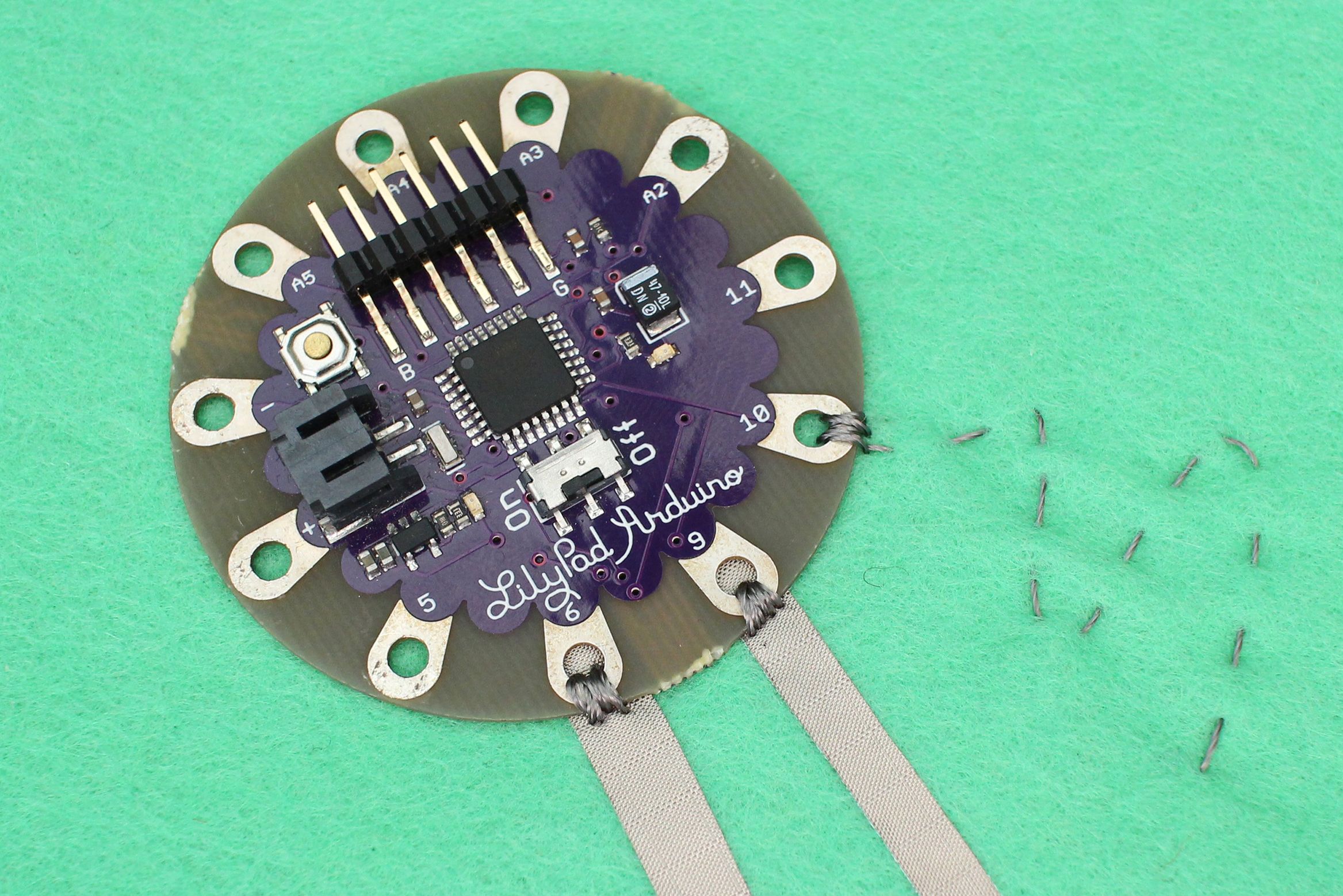

Step 4: Sewing

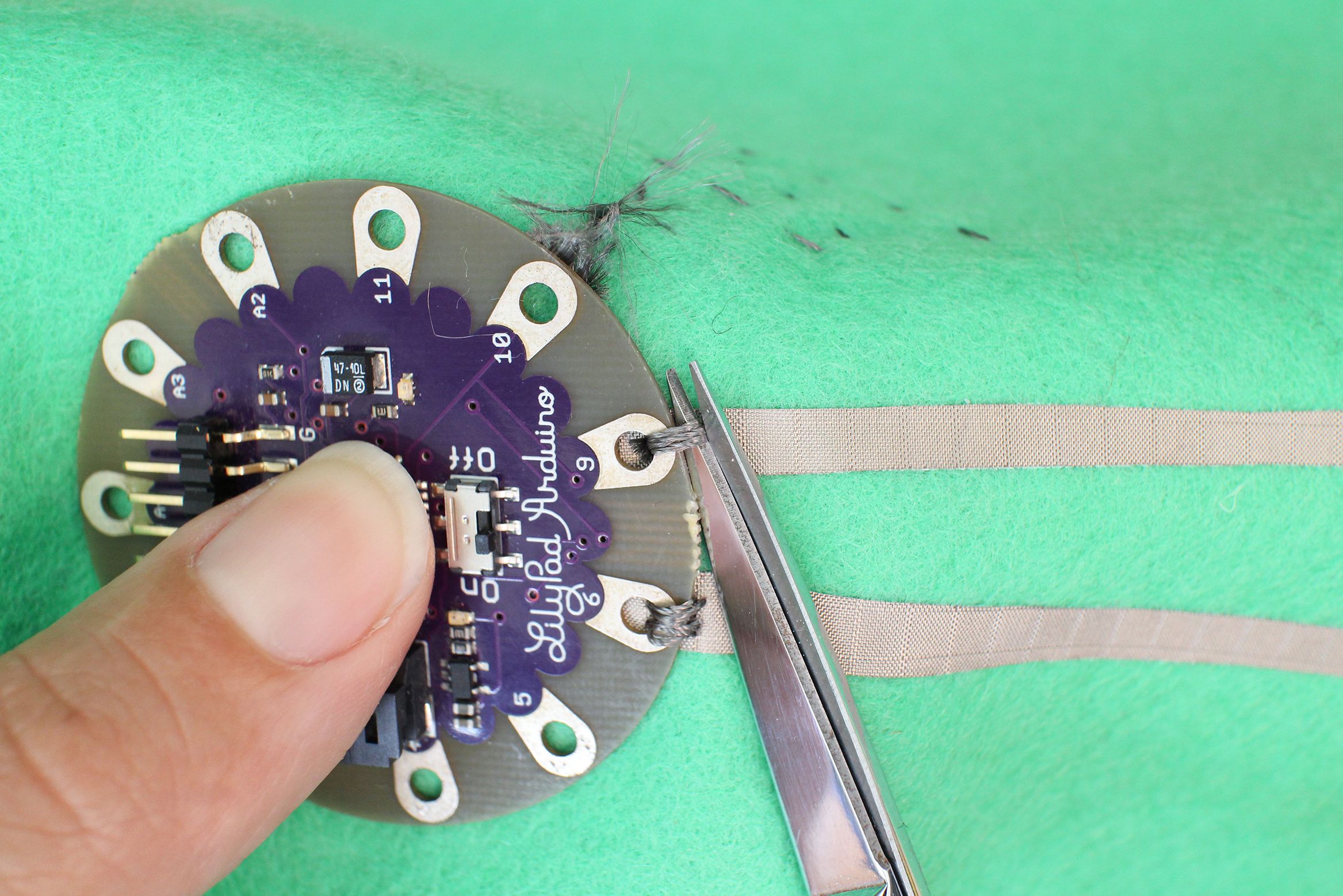

Sewing to the LilyPad and other sewable components are what they are designed for. Conductive thread makes for a strong and flexible connection that naturally integrates with fabric. It's also the best when it comes to strain relief.

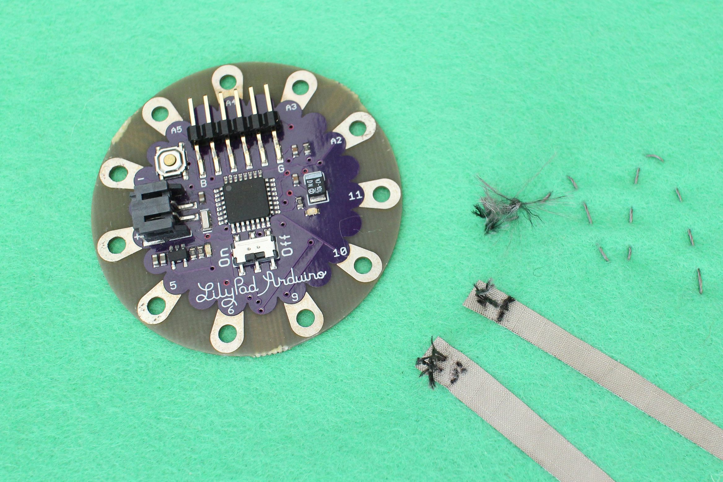

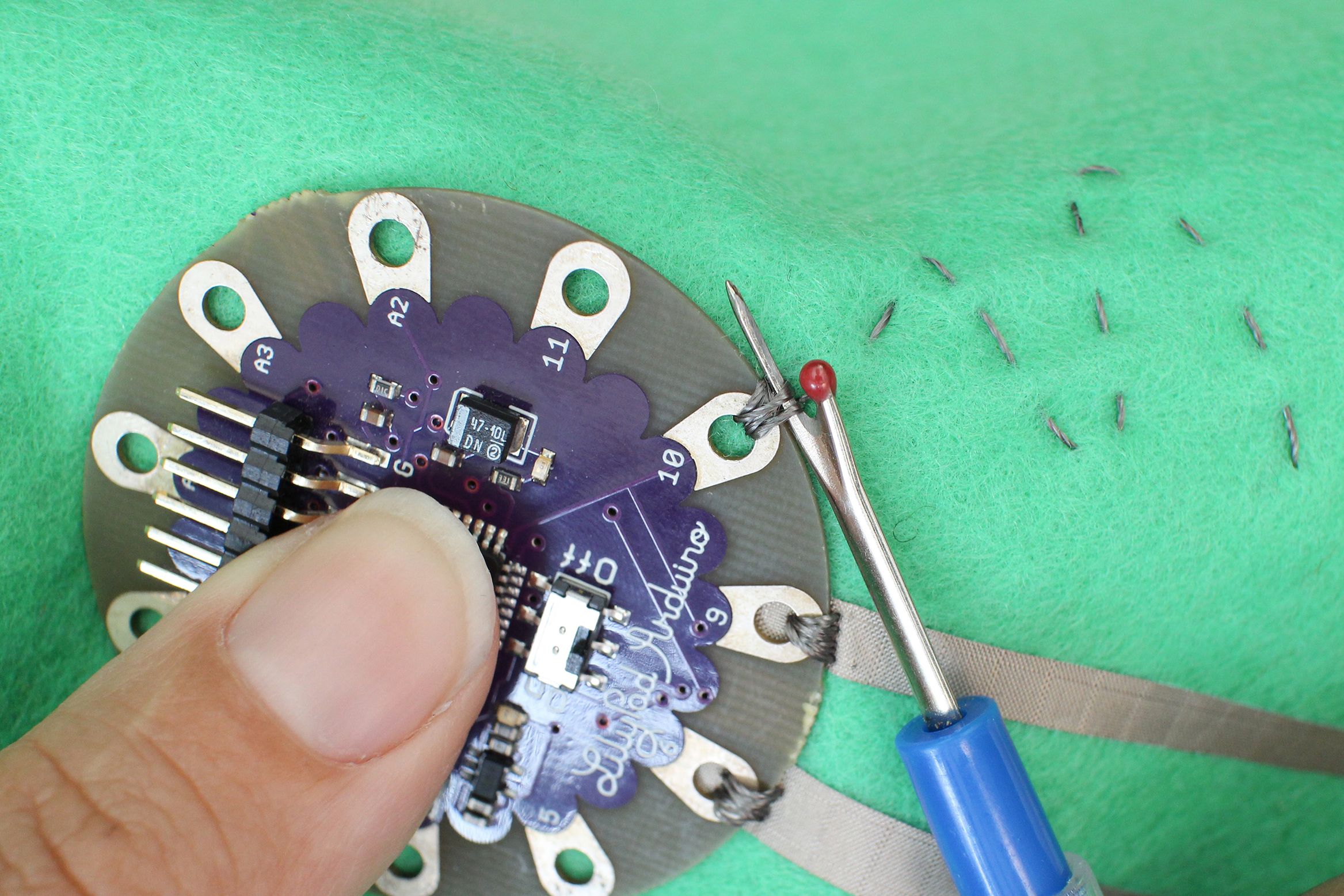

The only downfall of sewing your components with thread is that if you want to use the them again, you need to use a seam ripper or pair of small scissors to cut it off.
Seam ripper
Scissors
This can damage your project and leaves broken connections you made need to make again.

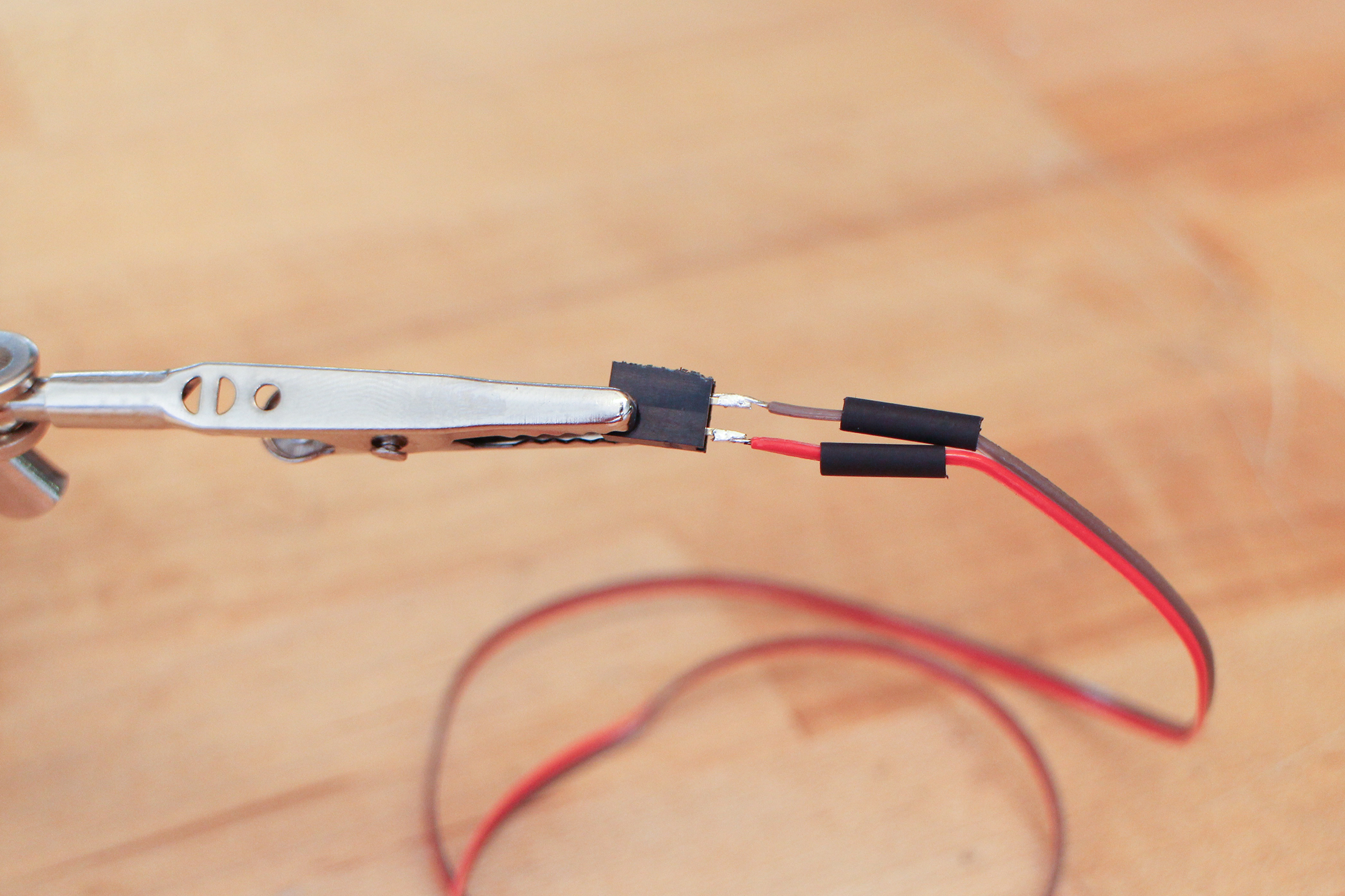

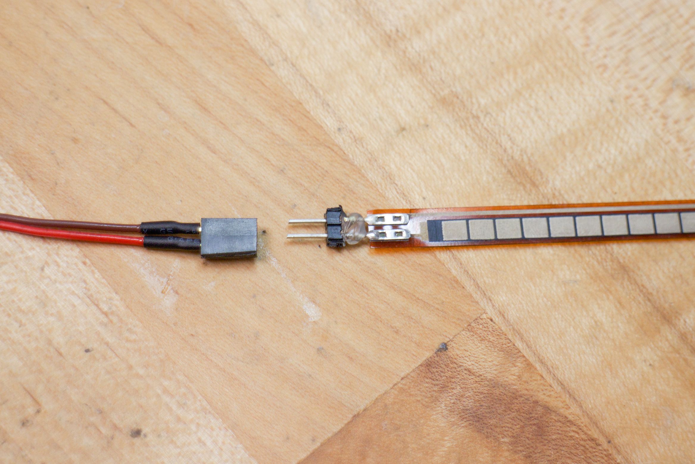

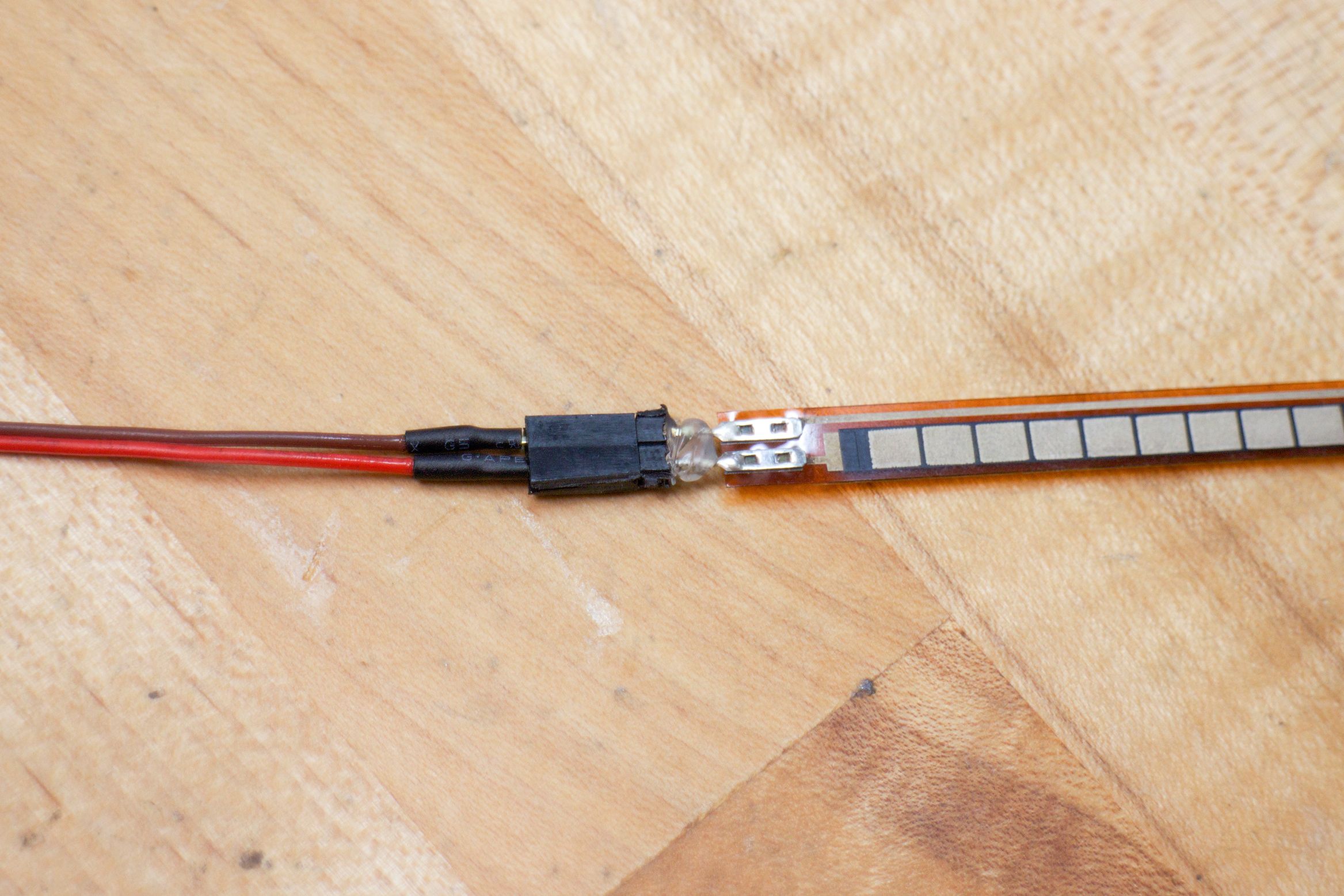

Step 7: Male and Female Headers

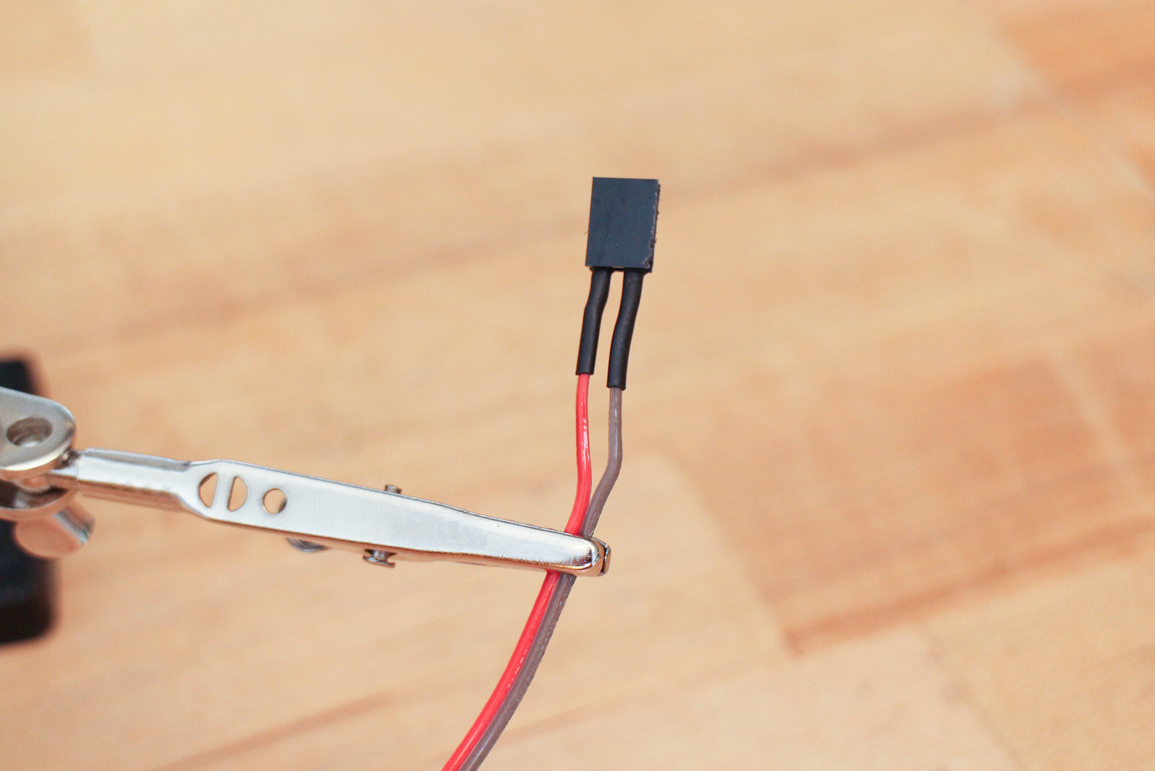

When you start working with electronics, female and male headers become a go-to connector. They take a bit of soldering but are great for making your circuit modular.
Soldering female headers to ribbon wire with heat shrink tubing.
Female headers on ribbon wire.
Soldered male headers on a flex sensor on right, female headers on ribbon wire on left.
The male headers plug into the female headers to make a connection.

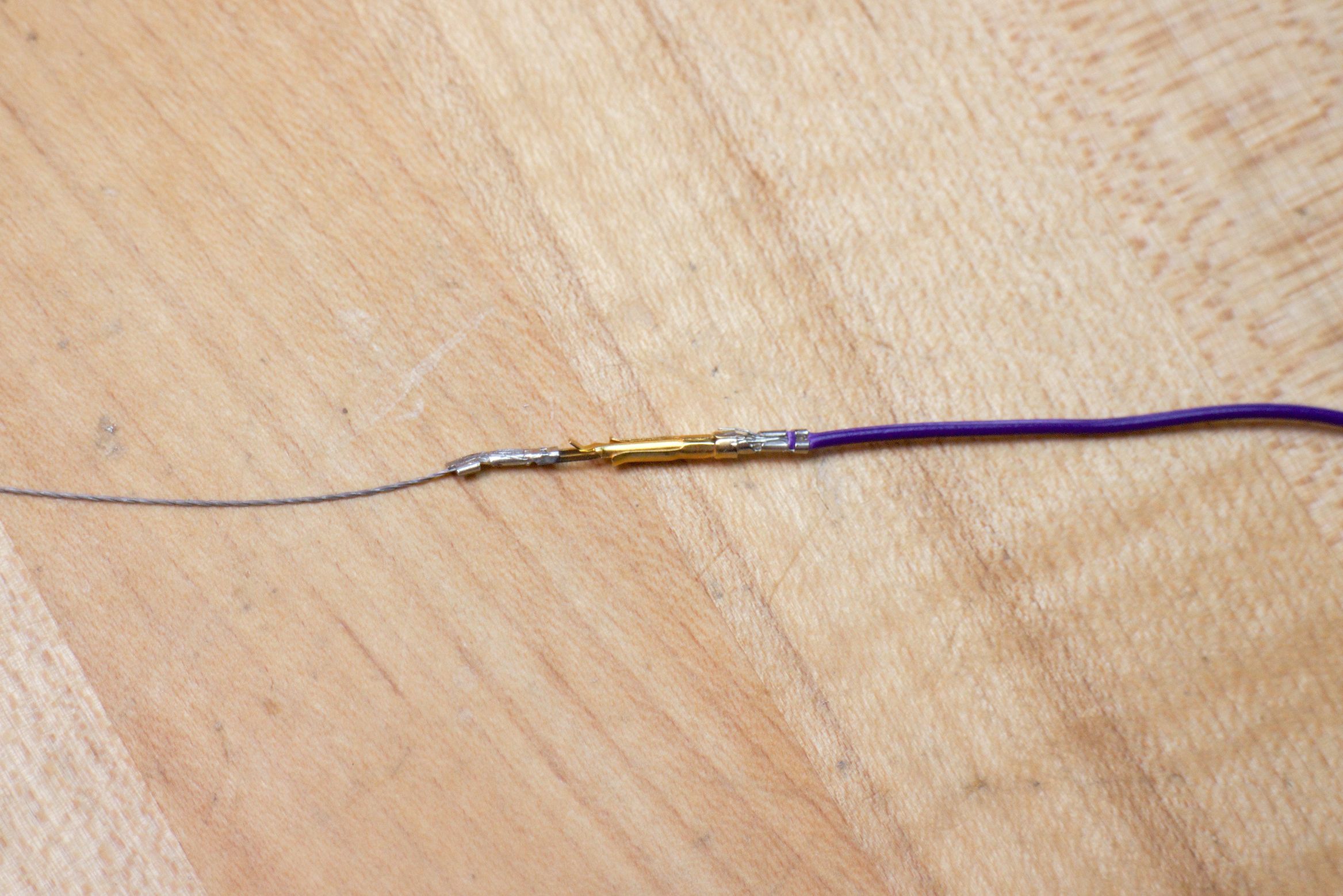

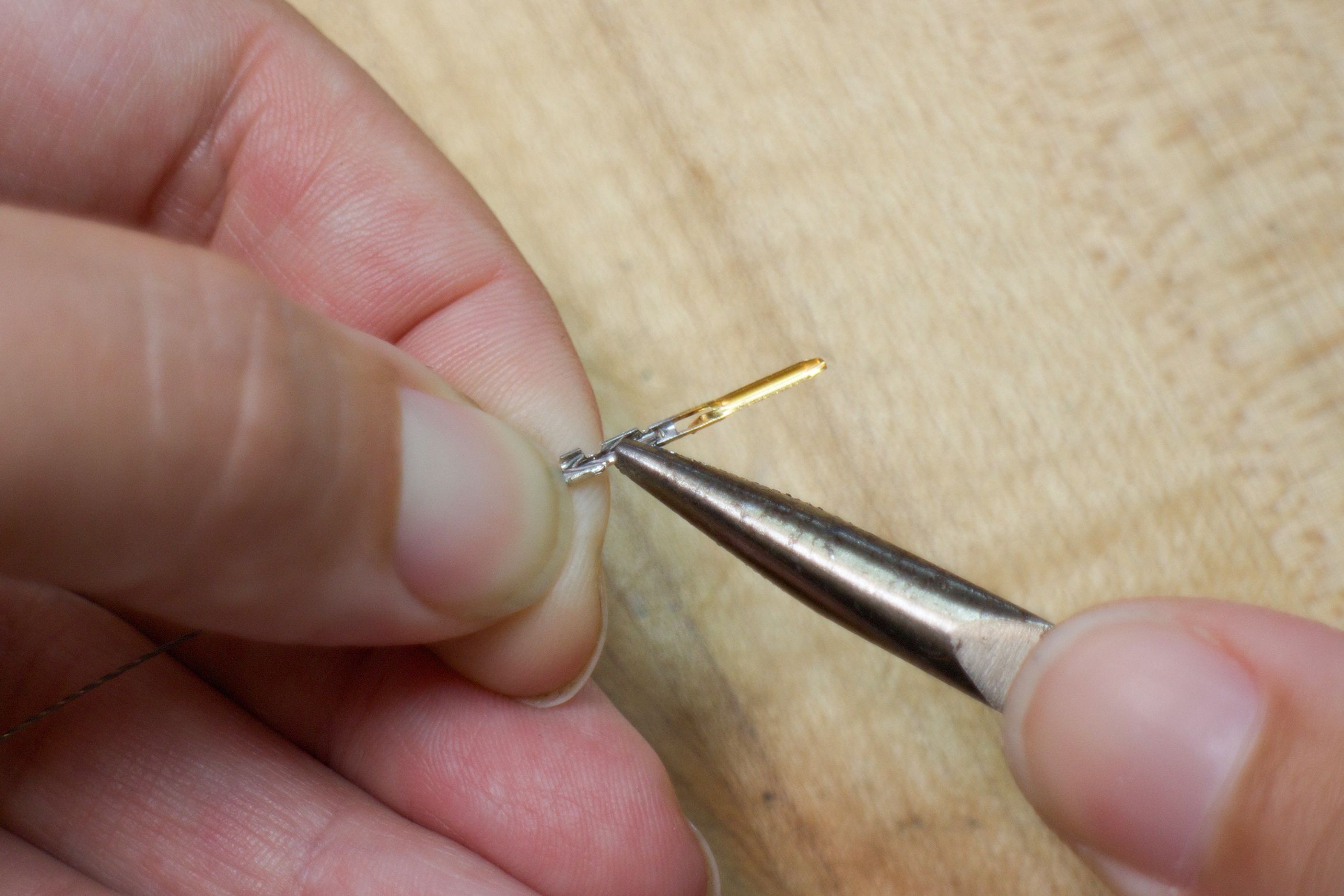

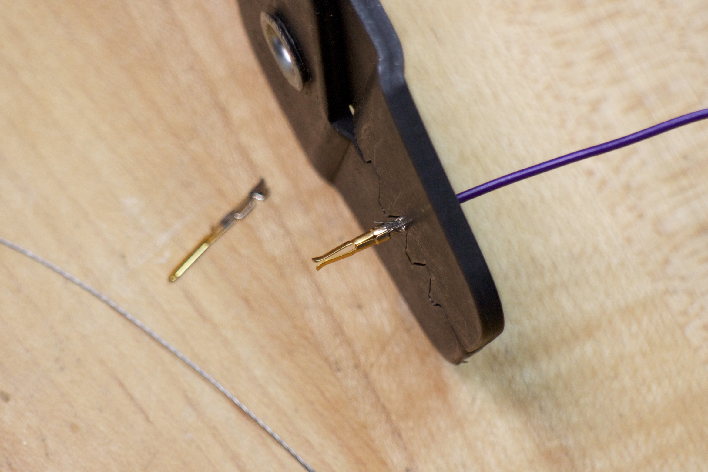

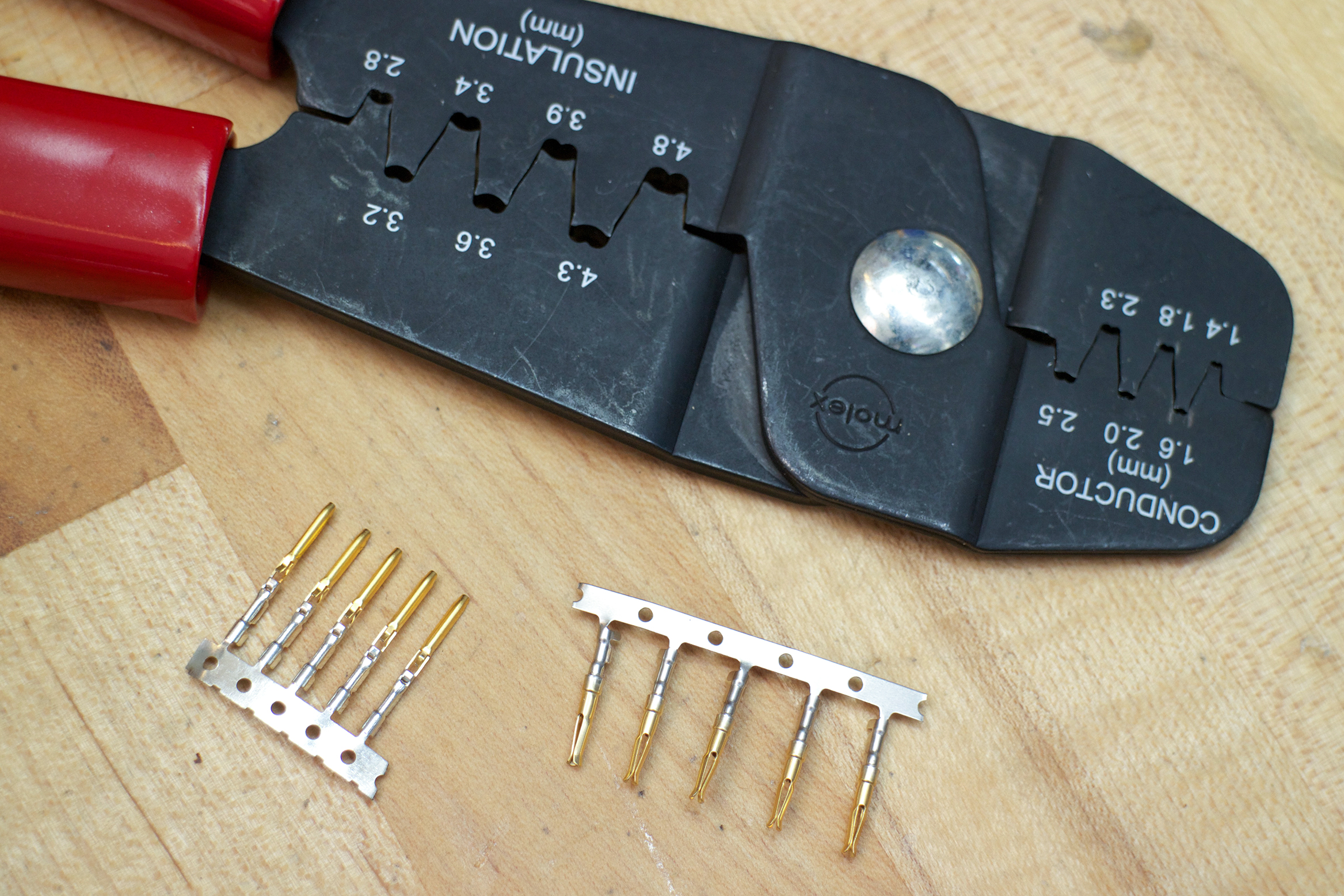

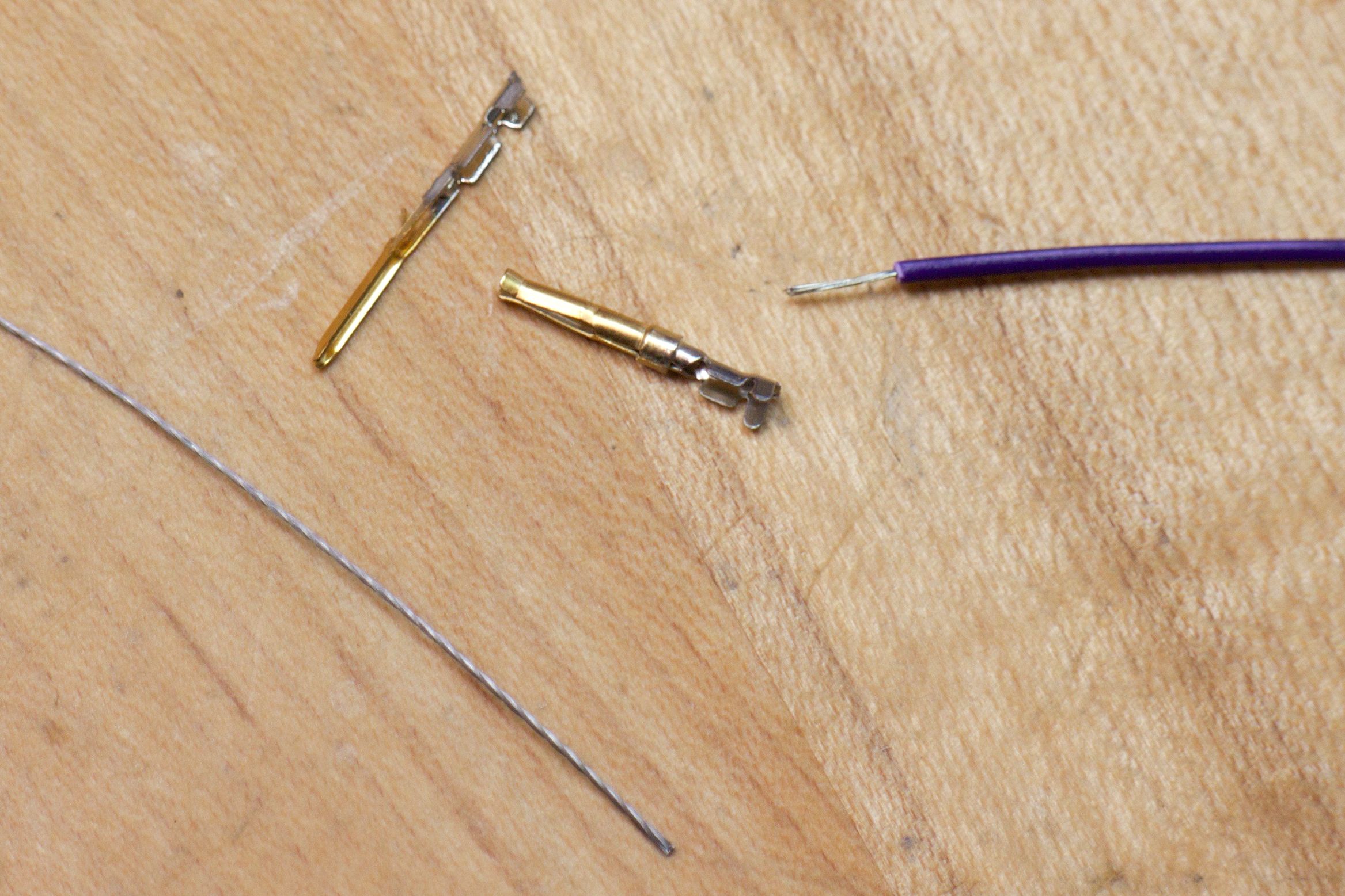

Step 8: Crimp Pins
Crimp pins and sockets are great for making wire-to-thread or thread-to-thread connections. You can use a crimping tool to crimp one on, or smash the Jebus out of it with some pliers. If you use pliers I recommend putting some strong glue on there as well.
Crimp pins with a crimping tool.
One male crimp pin with female crimp socket.
Crimping on a socket with a crimping tool.
Crimping on a pin with a pair of pliers.
The pin plugs into the socket to make an electrical connection.

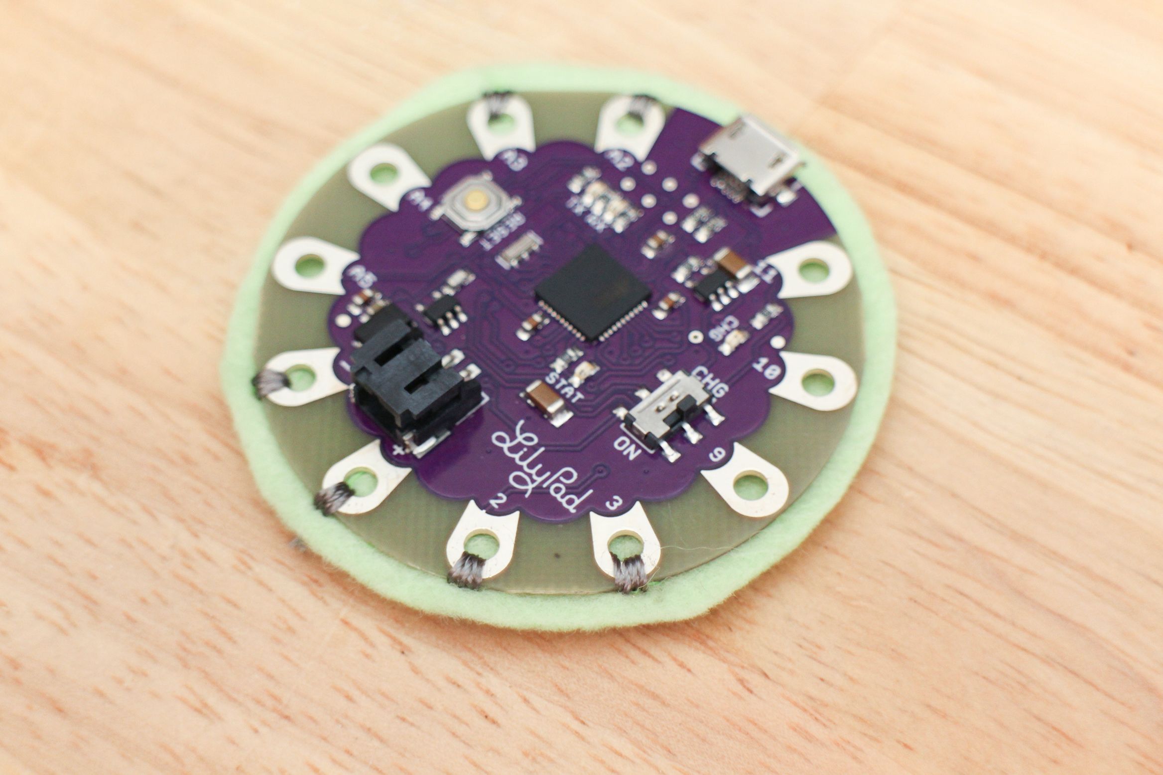

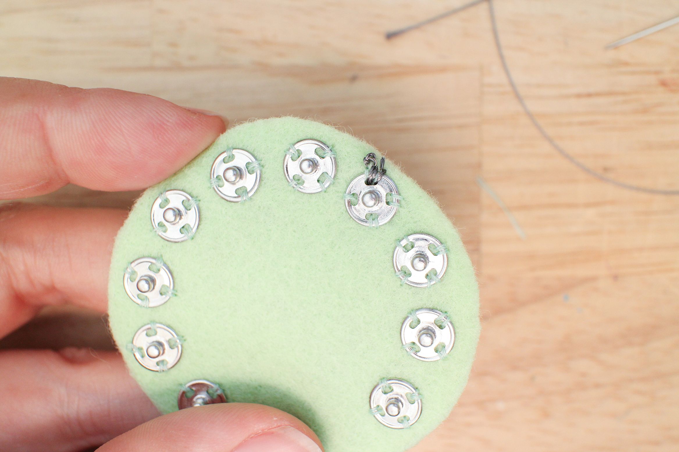

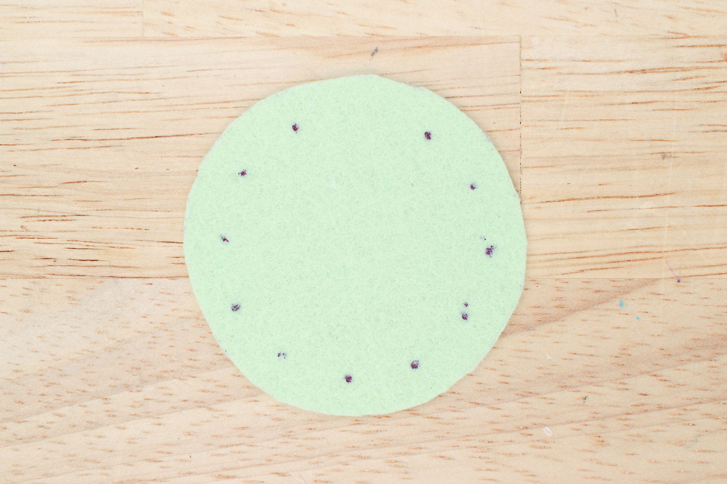

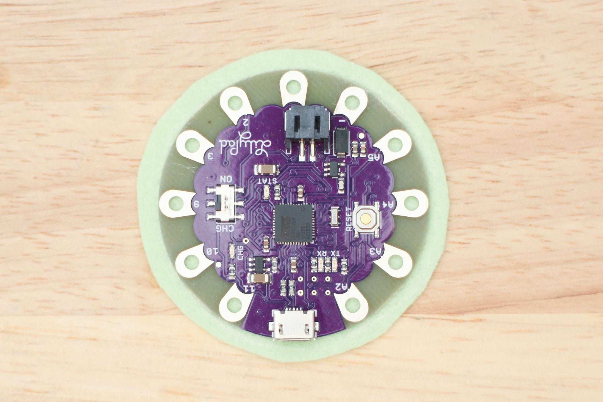

Step 10: Trace
Place the board face-up on some felt and trace around the edge. Cut 1/8" - 1/4" outside of the tracing, creating a circle of felt that is a little bigger than the board in size.
Step 11: Mark
Keep the LilyPad on top of the felt and mark the centers of each hole.

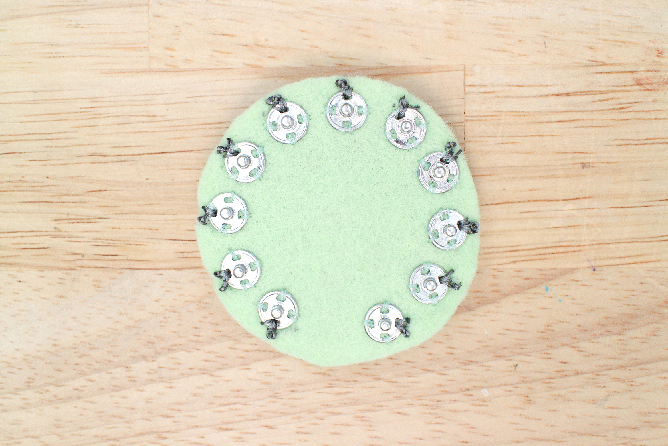

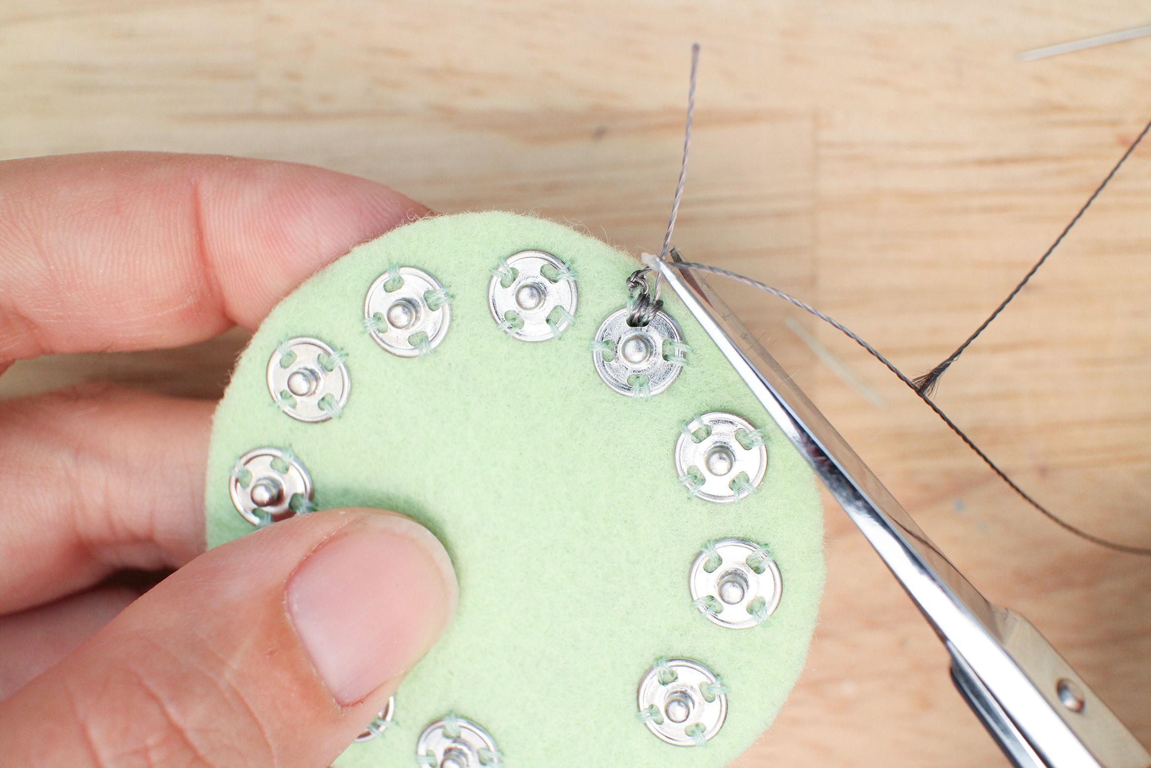

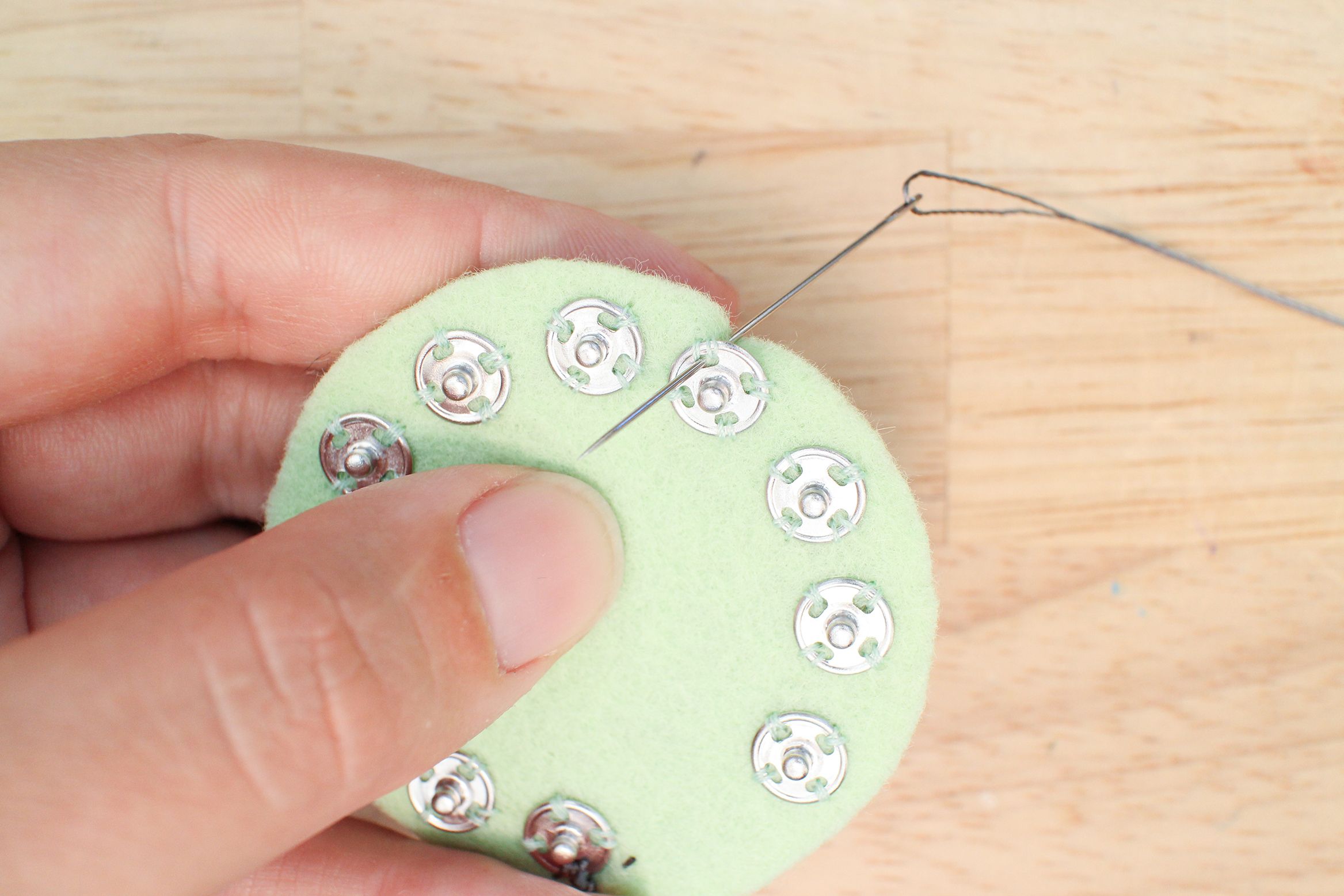

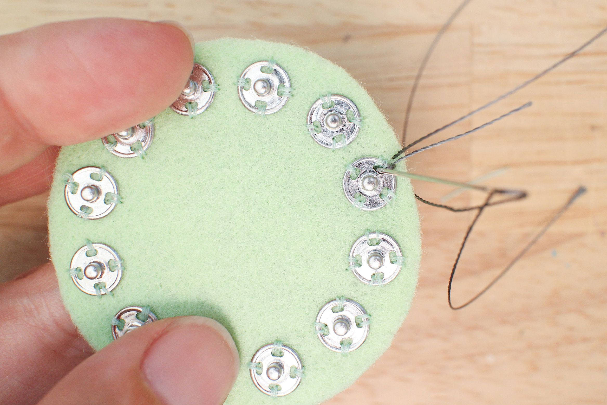

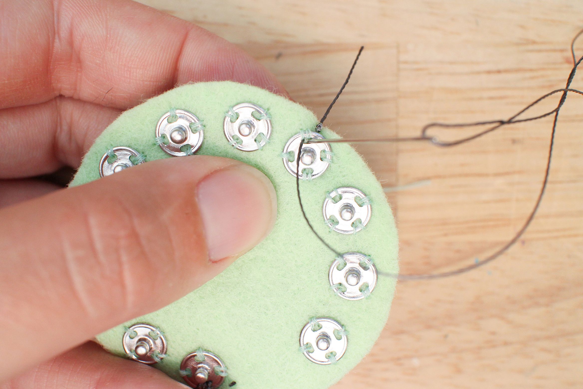

Step 12: Sew on Snaps
Before the snaps are sewn to the board's pins, it's easier to sew the snaps to the piece of felt using regular thread first. Remove the board from the felt and put it aside for now.
Thread a needle with regular thread and knot the end. It can help to lay all the snaps down on the felt to get a feel for spacing before you start sewing. It's important that the snaps are not sewn too close together.
Place the stud half of a snap on top of the first mark and thread the needle through one hole. Stitch down the snap by stitching at least twice through each of the four holes. Continue doing this to the remaining snaps until all are stitched on.

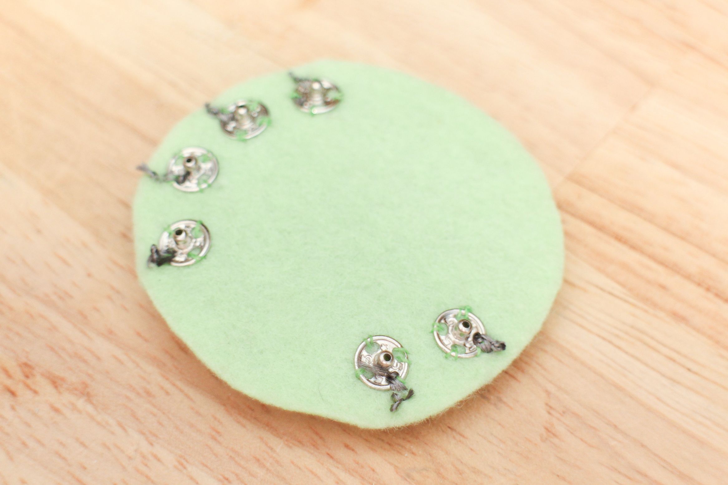

Step 13: Clip Tails
Turn over the felt and snip off all the tails to clean up.

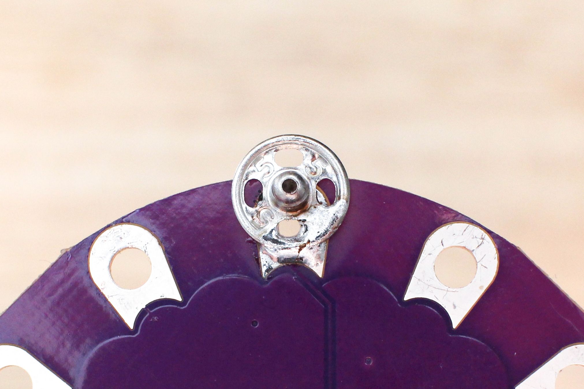

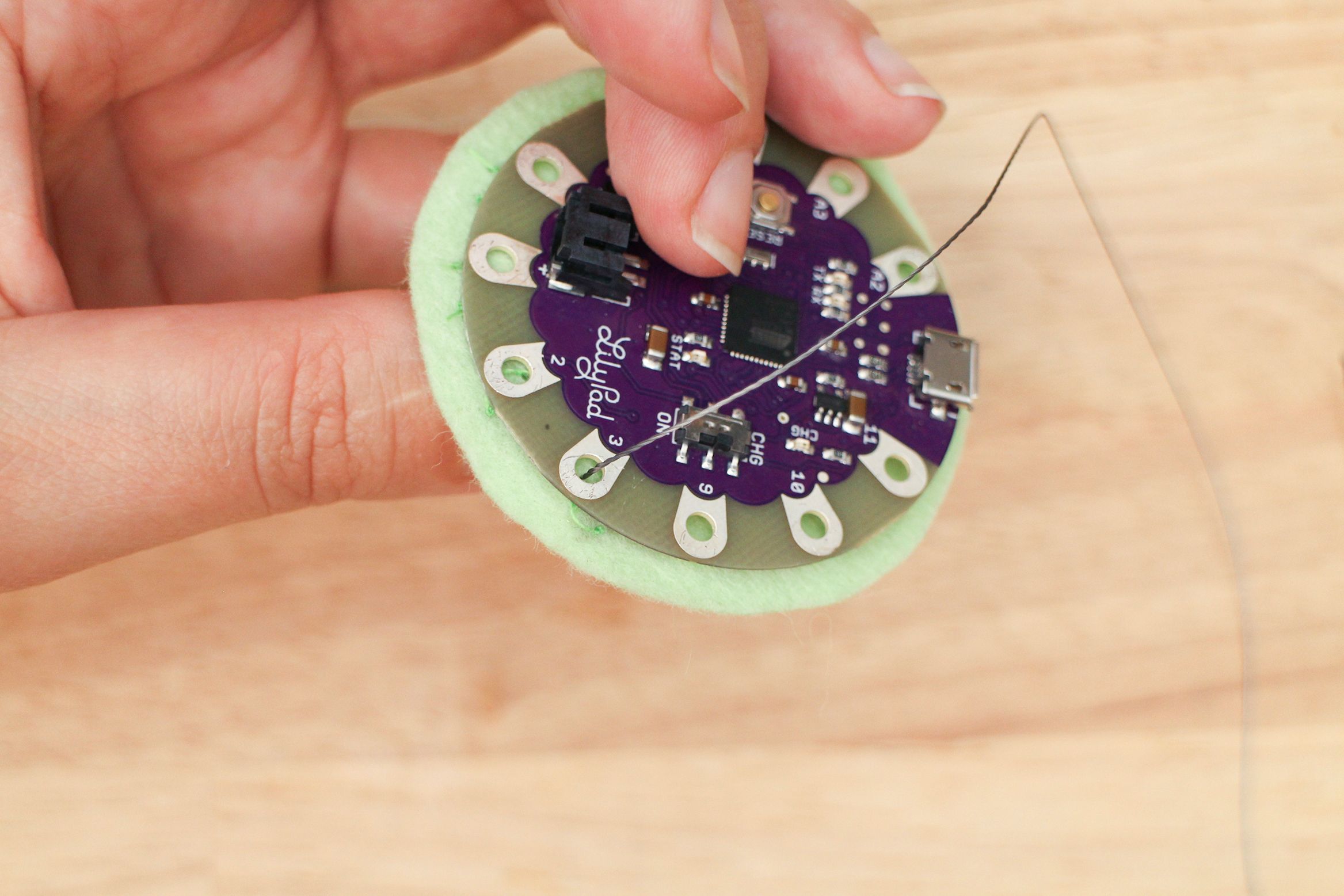

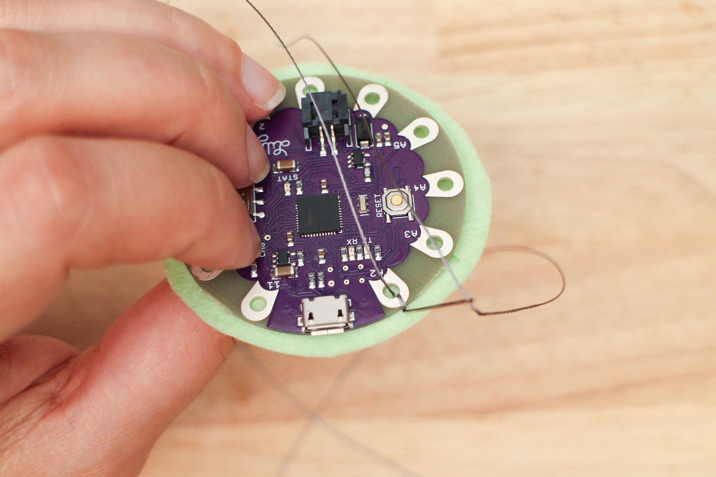

Step 14: Sew to Microcontroller
Once all the snaps are sewn onto the piece of felt, they are ready to be connected to the board. Put the felt with the snaps on the back of the board and line the snaps up with the pins.
Start sewing by pulling the needle through a hole in one snap so the knot of the thread is off to the side and out of the way. This also places the knot so you can put glue on it later to secure without interfering with the board or snap.
Push the needle back through the hole to the front of the board and through the hole of the LilyPad pin you are attaching it to.
Make at least 3 small stitches connecting the snap with the metal pad.
Knot when done, keeping the knot off to the side and away from any of the other snaps. I snipped off my tails as I went but you can leave them, glue the knots and then snip like you did with the sewn circuit. This way you can tighten the knots again before gluing them.
Continue to sew the remaining snaps to their matching pins.

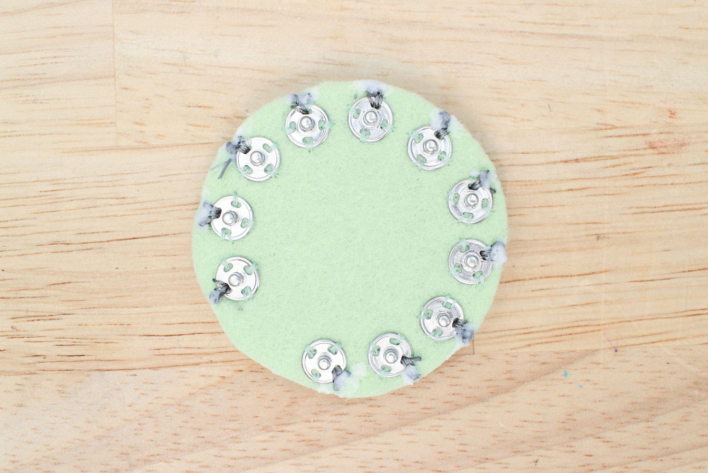

Step 15: Secure
Put a bit of fabric glue over the two knots on each snap to secure. Great job! You are now a snap-sewing wizard! You can now also securely snap your microcontroller to any project. Make sure to share your new snap-sewing skills below.
