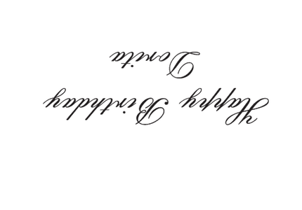

Use the letter tools in CorelDraw to add words to your window. If your bag is like mine (with a handle), it will be upside down so you probably want to put the words at the bottom and turn them around so they are upside down.
I used 72 pt "Commercial Script BT" font which was on the machine at the Shop. Unfortunately, it wasn't on my home machine so I saved it with a different font that looks similar.
