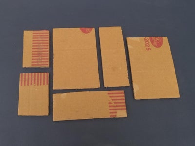

Step 1: Marking

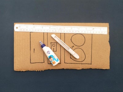

I began by carefully measuring the dimensions of all the components I planned to use: the two speakers, the on/off switch, and the USB port of the Bluetooth audio module.
Once I had the measurements, I transferred them onto the cardboard, marking the exact positions where each component would be mounted. This included neat cutouts for the two speaker units on the front panel, a dedicated space for the power switch, and an opening for the USB charging port of the module.
NOTE: Cardboard is forgiving, but clean cuts and accurate placements go a long way in giving your project that extra wow factor.

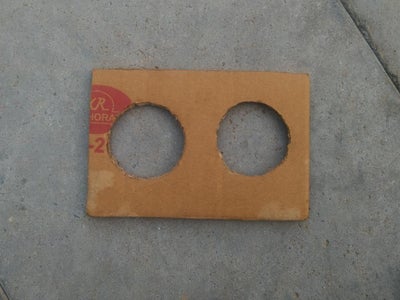

Step 2: Cutting
With all the measurements marked, Started by cutting out the required sections. Using a sharp utility knife (or craft cutter), I carefully followed the lines to make precise cuts for the speaker holes, the switch slot, and the USB port opening.
Clean and accurate cuts are crucial, especially when working with cardboard. They not only help the components fit snugly but also give the final product a neat and professional appearance. I took my time, applied gentle pressure, and used a metal ruler as a guide to keep the edges straight and smooth.
NOTE: while working with sharp knife, always take a look at safety first.
PRO TIP: Always place a cutting mat or a thick surface beneath the cardboard to protect your workspace and ensure cleaner cuts.

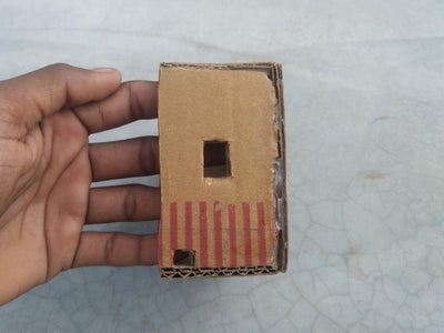

Step 3: Making Structure
I began shaping the structure by joining the cardboard panels using cello tape. This helped me temporarily hold everything together and check the alignment before making it permanent.
Once I was satisfied with the overall shape and fit, I secured the joints using Fevicol (Glue) for a stronger and long-lasting bond. The speaker enclosure started to take form — sturdy, neat, and surprisingly solid for a cardboard build!
I intentionally left the top panel open at this stage. Since all the internal wiring and component placement would happen next, keeping the top accessible made things easier.

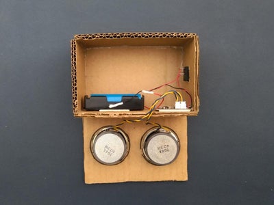

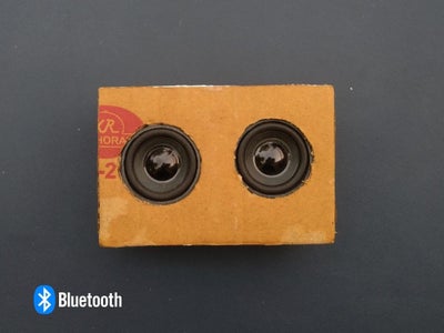

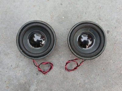

Step 4: Spekar Assembly
Now it was time to install the speakers! I carefully placed each speaker into its designated cutout on the top panel that I had previously marked and prepared.
Since Fevicol isn’t suitable for attaching electronic components like speakers, I used a hot glue stick for a strong and quick bond. However, I was extremely cautious — applying only a small amount around the edges. Too much heat or glue in the wrong spot could damage the speaker, so I worked slowly and precisely.
Once the speakers were firmly in place, I connected the wires with JST connectors, making the setup completely plug-and-play.

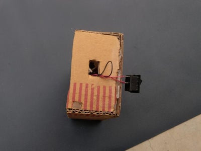

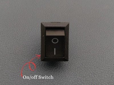

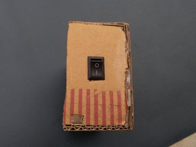

Step 5: Switch Assembly
I carefully inserted the switch into the cutout I had made earlier on the side panel of the cardboard structure. To ensure it stayed firmly in place, I used a hot glue gun, applying just enough glue from the inside to hold it securely without creating a mess.
Placing the switch on the side panel made it easily accessible without interfering with the front design, giving the speaker a clean and functional layout.

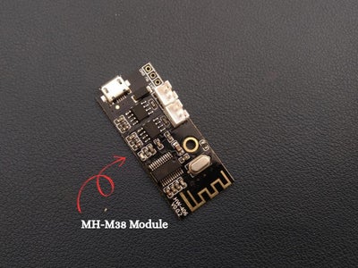

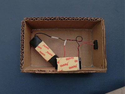

Step 6: MH-M38 Module Assembly
Now it was time to install the most important component of the entire project — the MH-M38 Bluetooth Audio Module. This tiny yet powerful module is what brings wireless audio to life in this cardboard speaker.
I mounted the module on the side panel, right next to the power switch, for a compact and organized layout. To fix it in place, I used double-sided tape, which provided a clean, secure, and non-permanent solution — perfect for delicate electronics like this.

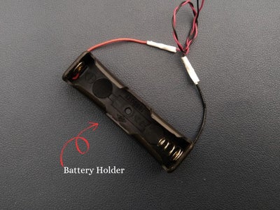

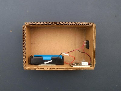

Step 7: Battery Holder & Battery Assembly

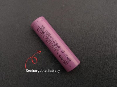

I began by mounting the battery holder inside the cardboard structure using double-sided tape. This method provided a firm grip without the mess of glue and allowed for easy repositioning if needed. I placed it in a way that kept the internal layout neat and prevented any strain on the wires.
Once the holder was securely in place, I carefully inserted the battery into it, making sure the polarity was correct and the connection snug. A firm and secure battery connection ensures smooth and uninterrupted power flow to the Bluetooth module and speakers.

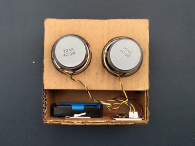

Step 8: Connection
Since I don’t currently have a laptop to draw a circuit diagram using Fritzing, I’ll explain the connections clearly in text so anyone can follow along with ease.

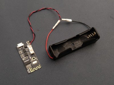

Speakers to MH-M38 Module: Each speaker has two wires positive (+) and negative (−). I connected the left speaker’s wires to the L+ and L− terminals on the MH-M38 module and the right speaker’s wires were connected to the R+ and R− terminals.
Power Connection: I used a battery holder with a 3.7V Li-ion battery. The positive wire (+) from the battery holder goes to the VCC or 5V input of the MH-M38 module (depending on your module version — mine supports 3.7–5V) and the negative wire (−) goes to the GND of the module.
Switch Connection: The switch is placed in-line with the positive wire from the battery holder before it reaches the Bluetooth module. This allows the switch to control the power to the module — turning the speaker ON or OFF easily.
