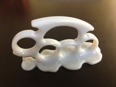

the first step in my process after some sketching is to refine the concept in 3d software and check the details for manufacturability.
My software of choice is solidworks.
the knuckle design was a few simple extrusion commands, the first from the front plane to build out the actual knuckle portion and the second from the ground plane to create the general shape of the melted puddle. I added a few chamfers around the edges of the knuckles and a lof of filleting to blend the puddle in to the knuckle portion in a convincingly melted manner.
after the 3d work was completed the file was exported to an objet 3d printer.
after a significant amount of high grit sanding and a light gloss coat i had a pattern ready for a silicone mold.

With my new molds, my process was as efficient as i had hoped.
i could use fast casting urethane resin and run 6 molds at a time to achieve an excellent cycle.
the parts require very minimal post precessing, i remove a small amount of flash, buff the bottom on a disc sander, sign them, wrap them in tissue and put them in a custom package that was designed and sourced the same way i did them for them fro my previous release.
