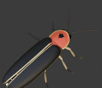

This tutorial will go over some of the character creation process for my (somewhat) realistic firefly here. I'll talk about modeling, texturing, and rigging my little firefly character, and make a small scene to show him off!

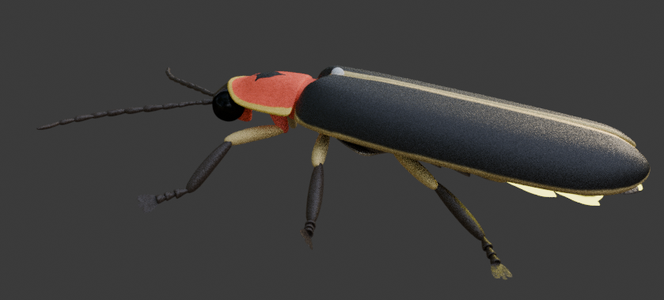

While making the firefly body parts, I kept thinking of those bandsaw videos where they cut the wood one way, then the other, sand it down, and have a finished statue. To model this firefly, I "cut" out one shape, extruded it up, and shaped it to what I needed by adding subdivisions, sculpting, and moving some vertices. Reshaping was the hardest part, but if you're careful it could be pretty easy. I repeated this process for each segment of the firefly body and its wings. I'm sure there was an easier way of doing it, but this one worked for me.
Of course, I duplicated some of them so that I wasn't remaking what I didn't need to, and I also highly recommend using mirror modifiers to save yourself a bit of work. If you want a tip, going back after you apply the modifier and roughing up/moving around the sides that were mirrored make it look more natural. Hard surface modeling is difficult, and I had a lot of trouble getting it all smooth looking.
The parts I found the hardest were the neck areas, and the spots where the legs joined with the body. For those, I added an icosphere with a few subdivisions, and sculpted it into shape. I think they could be better, but hopefully, it won't be very visible! I also used another icosphere to sculpt the little joints for the legs to connect to.
In the end, we don't have a perfect overly detailed model, but with some textures and posing, hopefully it'll work out!

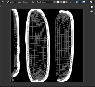

The first thing I do is apply all my modifiers - mirror modifiers and subdivision surface modifiers don't work well with unwrapping and painting on textures. Another thing that would help with some errors is applying location, rotation, and scale.
Once I got all this out of the way, I painted black and white textures onto the body segments so that I could map where I wanted the glow to be, and where I could separate different colors/textures. Above I have a picture of what all this looks like in black and white. This was done in texture paint mode - I unwrapped everything, added a new flat color texture, and then used the tools to paint pattern into it. This all basically just gave me a colorless version of what I hoped the final product to be. The only part I decided to paint color directly onto was the head, because it took multiple colors and only a single shader.
Now that I have the base of color and pattern, I added bumpy texture and smudged some of my colors together to make it look a little more natural and less like it was painted on with a solid brush.

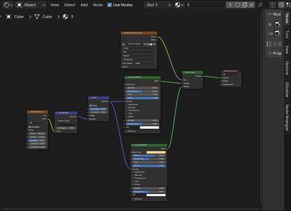

I put some of my texture trees above, so you can see how I set some of it up to get the look I wanted. There is definitely no one way to do this part, and you can easily change how it all looks as much as you want.

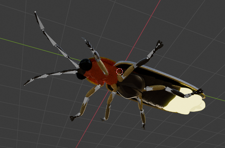

Rigging is incredibly annoying, so I won't go into a ton of details here. There's a bunch of different resources out there about how it's done, and many different ways to go about it. For the scene that I ended up going with, I didn't need much rigging, just a simple standing pose and antenna reposition. Since a firefly is surprisingly not super flexible and is very segmented, I only really needed a few bones.
If you're not intending to do much with this model outside of a standing pose, you don't need to do much rigging, but if you're really ambitious and you want to go for a flying animation, you'll need to have a complex rig. Go for it!
I started the process with applying any of my modifiers that are left unapplied. Then, I joined all the bug's meshes together and parented the armature to this big mesh with automatic weights. The most annoying part of rigging a character is definitely weight painting. Repainting the heat maps on all of the vertex groups definitely takes some work.

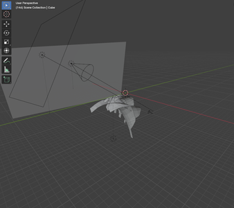

Step 6: Little Scene
I didn't do anything fancy here, I basically added a handful of lights to light up the scene, put a darkened image of a forest behind the firefly, and downloaded and duplicated a fern image that I found online. I rendered in Cycles, which meant that I needed to use a post processing bloom effect, which you can find tons of tutorials for online and I have a screenshot of above. After that, I put them all together and tried to make a nice composition. Lots of tweaking - I think I rendered a dozen times before I liked what I saw.
