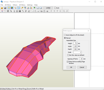

Step 2: Open Pepacura Software
Load the .OBJ on it, follow the instruction for no flip etc, then click
unfold and don’t forget to change the scale to 1 (it mean it will printed same scale as your 3D model).
Step 3: Click Unfold
The unfold result will be like this, u can adjust position of the paper as u want… after that print it…
