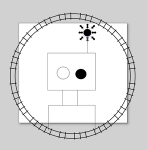

Test: robot sketch
Finally, I made a patch from a robot sketch that I drew. For the filled circles on the robot, I used the following:
- Reduce "spacing between rows" to 0.1
- Changed "fill method" to "circular fill"
- Increased "number of repeats" to 2 (eye) or 3 (antenna)
This worked very well even though the ball on the antenna is just under 4mm. It does, however, result in a raised bump rather than a flat circle.
