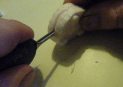

Pulling a mold with the wire is easy. Clay has a tendency to cling quite strongly to the vessel its in. the wire makes short work of pulling it up and out.
1. Using a sharp knife, cut around the perimeter of the mold, cutting straight down along the wall of the cup, going as deep as you can.
2. pull gently on the wire and the parts will come out cleanly, or at least more cleanly than they would if you didn't have a wire.
3. Peel the clay away from the silicon. The sprue, if it was a part of this half of the mold and the part will stay in the silicon portion of the mold. The wire needs to come out. You can either thread it back through the silicone or snip the silicone around the wire.
4. Toss the clay and thoroughly wash the silicon, getting it ready for the next pour. If the sprue sticks out beyond the surface of the mold, cut it so it sits flush with the silicon, or completely remove it and fill the hole with clay.
