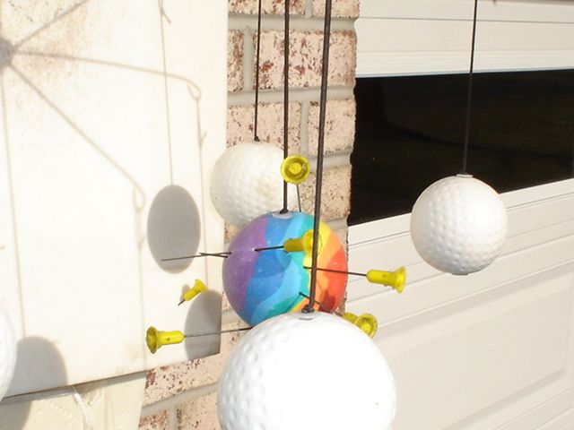

6. Paint the bolts to your choice of colors, allow to dry.
Step 9:
7. Attach the points to the tapered tips using the cyanoacrylate glue. Allow to dry. (Be careful NOT to glue your fingers together.)
You are now ready to use your pistol crossbow for competition target shooting or hunting.
