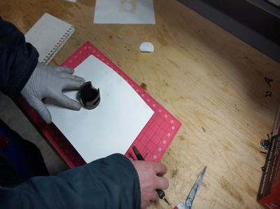

- The first thing I do is clean the surface where the gasket will go, this is needed to get an accurate template. There are several ways to do this from gasket remover compound, a brush that is softer that the cylinder, and a razor blade (While this works it is very easy to cut into the mating surface so this is the riskiest option).
- In the second picture I flip over the cylinder and lay it on the paper. Then I trace a circle along the outside of the cylinder skirt that protrudes from the cylinder.
- Next I cut out the circle I just traced. I get it as accurate as I can around the cylinder skirt but the rest of the circle doesn't have to be as perfect since that is where the transfer port cutouts will be.
- Then I place the paper on the cylinder and hold if firmly in place.
- In the fifth picture I rub the paper with a dirty finger, it is important to not let the paper shift at all while doing this. I got the idea to do this from grave rubbing which can be used to read engravings that are too weathered to read. I dirtied my finger by rubbing some rusty metal I had, most shop floors are dusty enough to get enough "ink" on your finger. I've ran out of dirt halfway through before so I got some more from the bottom of my shoe while in position and still holding the paper down so it didn't shift.
- The last image shows the completed rubbing. The lines are very sharp for using such crude and free tools.
