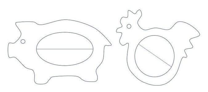

Step 1: The Animal Rattle Designs
Let's start with an easy rattle make first that anyone can do.
Since my new grandbaby lives on a farm with chickens and pigs, I thought that would be perfect for her. So I googled animal clip art, found some I liked, and then edited a bit to the size I wanted.
Next, just print out and wrap with packing tape over the wood board of your choice. Make sure you match the wood grain length to avoid the wood from breaking off if dropped.
Step 2: Prep for Scroll Saw
Here, just drill some holes for your scroll saw (or coping saw) blade to fit. Then carefully cut around the lines. But don't force the blade since that may cause you to go off the line. Just let the tool do it's work.
