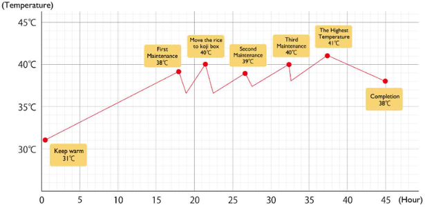

**As the aspergillus oryzae begin to grow and populate throughout the grains, they will start to form a network of mycellium that knits them together, and the koji will start to generate its own heat. That's a good sign the koji is healthy, however we have to prevent it from getting hotter than our target temperature range or the enzymes we are cultivating will die.
  1. When you notice a spike in temperature, you will need to open the fermentation box (working quickly so it doesn't cool down too much), unwrap the cloths, and use your hands to break up the koji so it can cool off. Break up large chunks and spread them out again on the cloth in the tray, reinsert the temperature probe, and cover with the other cloth again (you don't need to bundle them up in sacks anymore, just keep them covered and keep the cloths slightly damp). **I have attached a chart in the photos for this step that shows an example of how one koji company, Kawashima, monitors their koji production - you can see how the temperature rises as the koji grows, then falls after they break up the grains, then rises again... over and over, maintaining the koji in their desired target temperature range.
  2. At each spike in temperature, simply repeat this process. **These are also good opportunities to check your humidifier water level, and wipe up any excess water that may be pooling in the fermentation box or even in the koji tray
  3. **During this batch, I noticed the humidity was holding at a much higher range than I wanted, so at the end of day 1 I had to prop the lid open a bit to let some of the moisture out... I was concerned this would allow the temperature to drop too much, but thankfully the temperature inside the koji held steady. These are the kinds of adjustments you may have to make along the way
