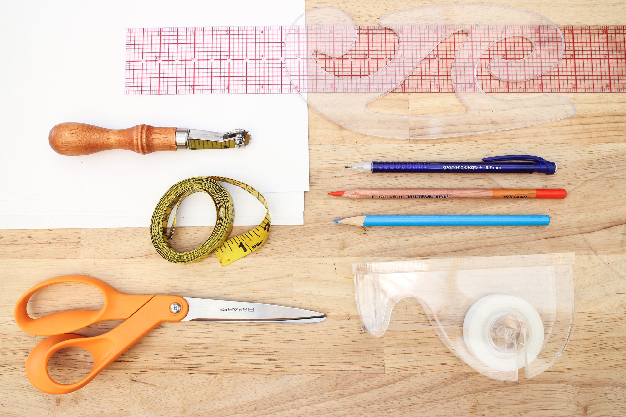

In this lesson I'll be using:

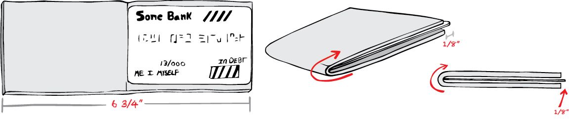

When you are creating a pattern to fit around an object, you almost never use the exact dimensions of that object, instead you need to add a little extra wiggle room or ease to your pattern dimensions.
The amount of ease you need to add often depends on the leather you are using. For thin leather you only need to add a small amount of ease, for thick leather you need more. For flexible leather that has a little stretch to it, you can add less ease, for stiffer leather you will need more ease.

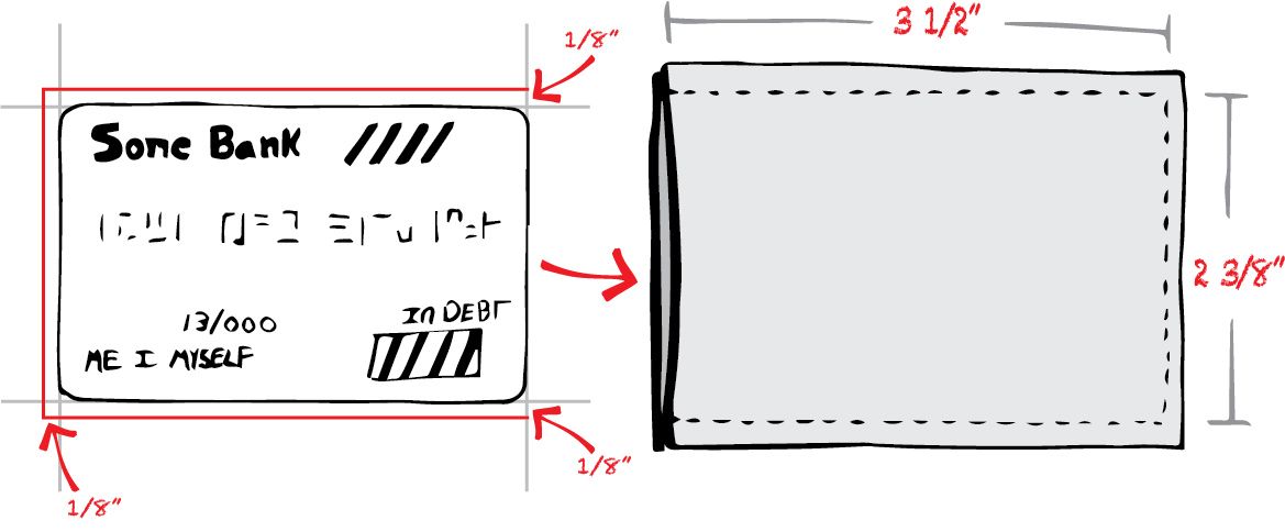

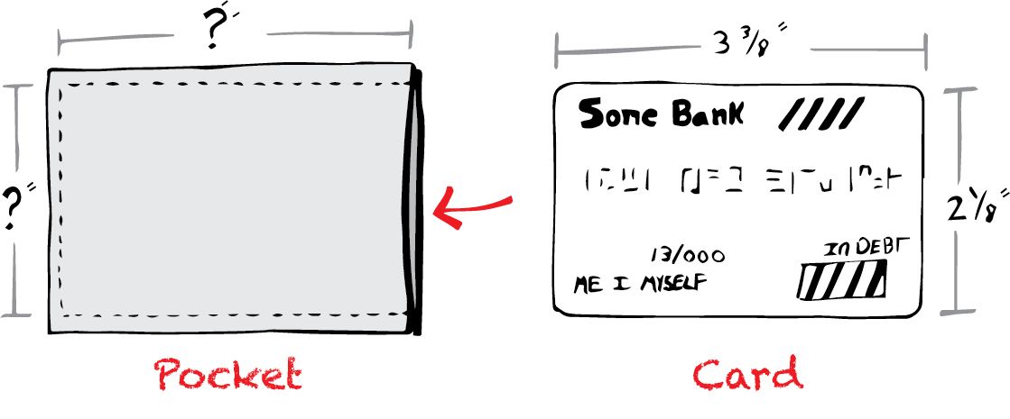

For example, say you want to design a flat two piece pocket that will hold a single credit card, how big does your pocket pattern need to be? The credit card is 3 3/8" x 2 1/8". If you were to make the inside of the pocket exactly the dimensions of the card, it probably wouldn't fit, or if you did manage to squeeze it in, you would have trouble getting it back out.
To add the right amount of ease, measure the thickness of your leather and add that amount of ease to each side of your pattern pieces, except on the side with the opening. If your leather is less than 1/16" thick just use 1/16" as your ease measurement. Let's say we're working with 1/8" thick leather, so the final pieces should measure 3 1/2" x 2 3/8" along the sewing lines.

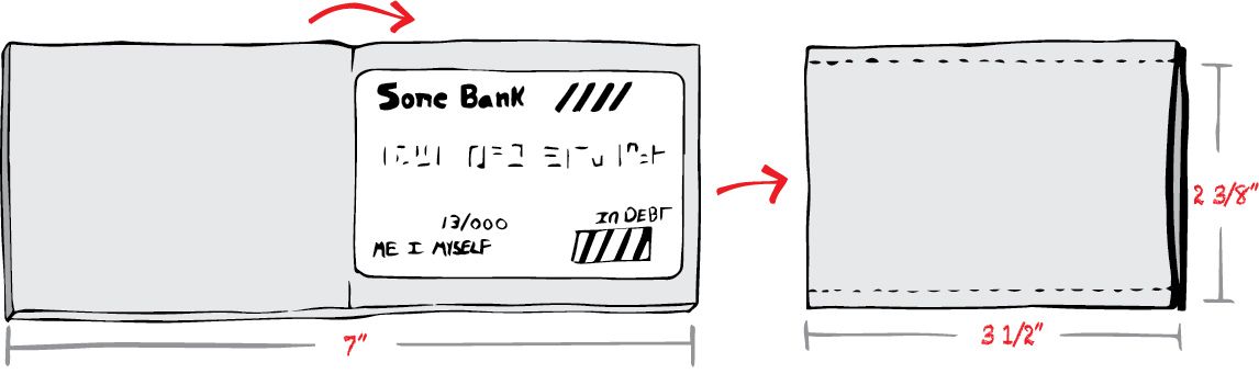

Ease on Folds: Now imagine you want to create the same pocket, but you want to do it with one folded piece of leather not two separate pieces. If you take a piece of 1/8" thick leather that is 6 3/4" long (double the length of your credit card) and fold it in half, will it make a pocket deep enough to hold the card? No it won't.
Why? The inner depth of this folded pocket will be 1/8" less than the length of the card because the thickness of the leather will take up that 1/8" at the fold. Therefore, if you want the folded pocket to be as long as the card, you need to add 1/8" to the pocket on each end for a total of 1/4" of ease on that pattern piece.

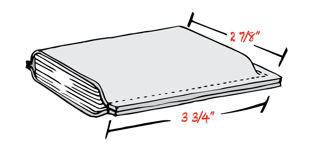

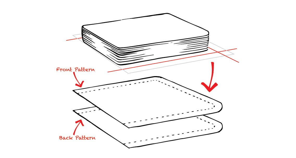

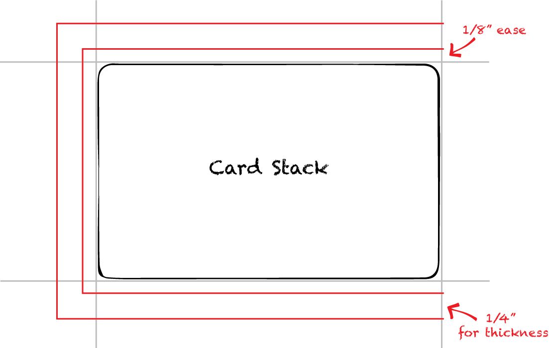

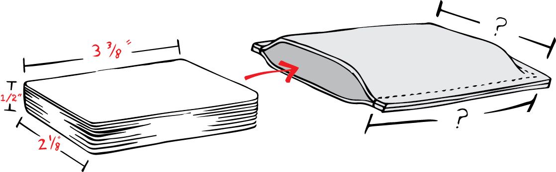

Patterning for Thickness Using Ease: going back to our card pocket example, now say you wanted to make a two piece pocket that would hold not just one card, but a stack of cards 1/2" thick. How long and wide does a flat pocket need to be to accommodate this thickness?
If you are working with 1/8" thick leather, first of all, you know you need to add 1/8" ease on the sides and bottom of the card pocket.
To make room for the 1/2" thickness of the stack, you also need to add half that thickness (1/4") to the sides and bottom of the pattern. Since you are going to be using two pieces to create this pocket, the 1/4" you add to each side will add up to the whole 1/2" thickness you need when the pocket is put together. You don't need to add that 1/4" to the top of the pocket because it doesn't need to bend around the sides of the stack of cards.
So when you're creating a flat pocket for an object with some thickness, the general formula is this:
Width of pattern without seam allowance =
width of object + thickness of object + (thickness of leather x2)
Length of pattern without seam allowance =
height of object + 1/2 thickness of object + thickness of leather

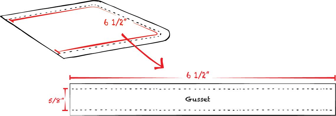

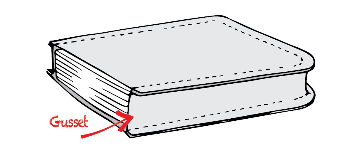

Gussets: One of the best ways to do this is to add a gusset to your design. Let's go back to our imaginary 1/2" thick stack of cards and create a different kind of case for it.
We'll start by taking the basic width and height of the cards and adding the 1/8" ease for leather thickness to the sides and bottom, this is the size of the front and back pattern for your pocket before you add the seam allowance.
Instead of making the pocket bigger so it will fit around the 1/2" thick stack of cards, we are going to add a side piece that accommodates thickness of the stack. This side piece is called a gusset. The length of the gusset pattern will be the length of the sides and base of the pocket combined (6 1/4") + 1/4" ease, and the width of the gusset pattern will be the stack depth of 1/2" + 1/8" ease.
To construct this case, these three pieces would be sewn together like this:
This is a basic gusset design, of which there are many variations. There are a lot of other ways to create three dimensionality in cases, but most of them are based on the same basic concept: If you are creating a pattern for a three dimensional object you usually need a seam where the angle of the object changes, the more seams you have, the more you can shape your design. There are also ways to create shape and volume with folding and pleating techniques. But for now we are going to focus on seams.

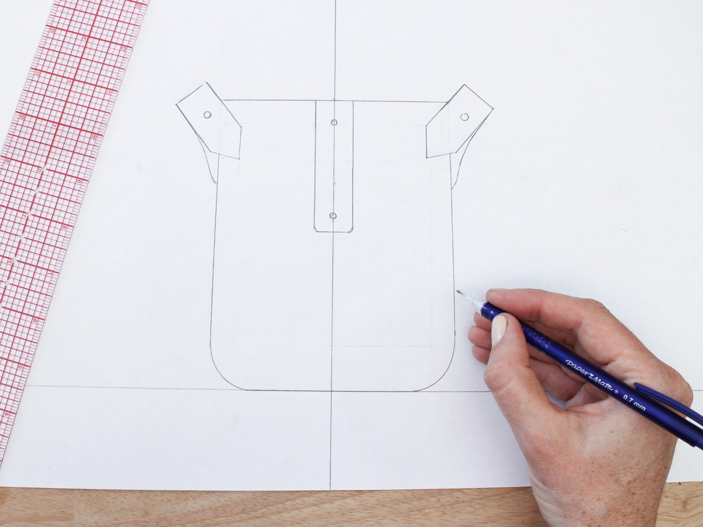

The first step in turning your design into a pattern, is to create what I call a pattern draft. A pattern draft is a full sized front, back and (sometimes side view) technical drawing of your assembled final piece with all the correct measurements, it doesn't necessarily show all the pattern pieces you need to create, but you will use it to determine the proportions and design elements, then trace pattern pieces from it.

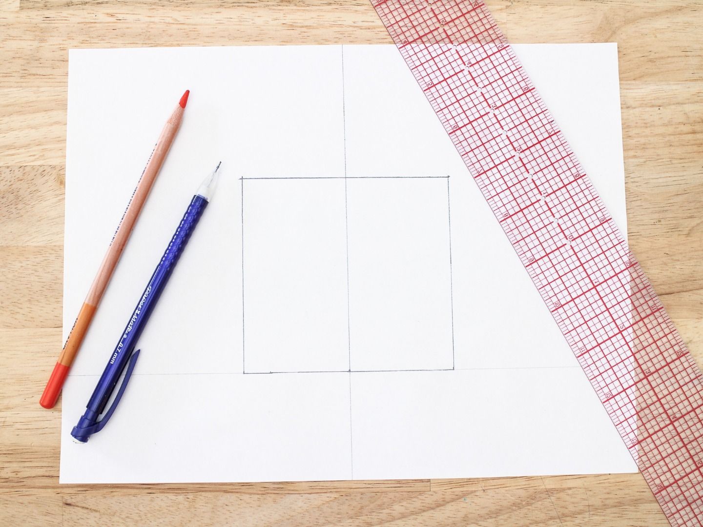

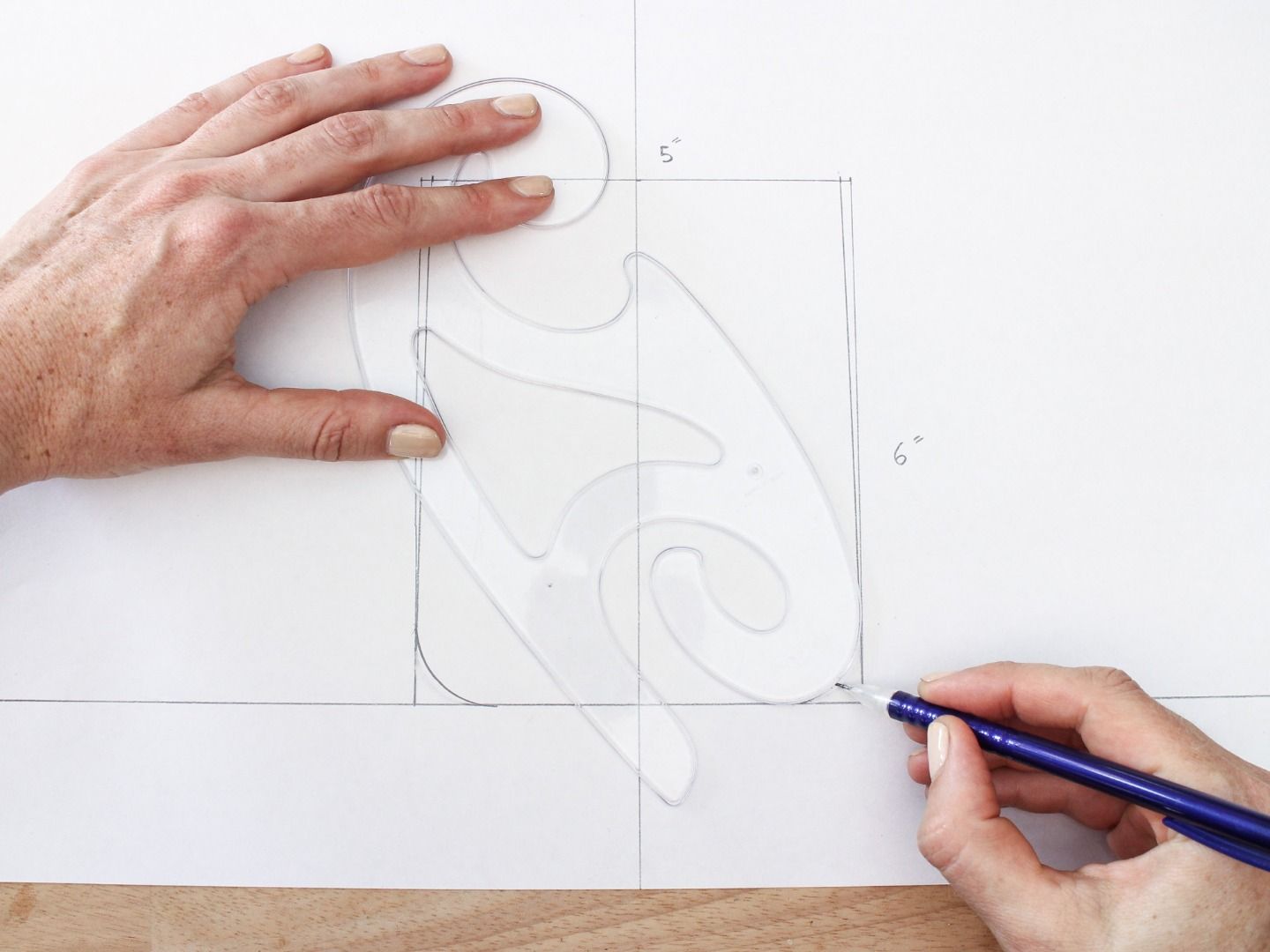

To create a draft, first draw a horizontal line near the bottom of your paper, then draw a perpendicular line coming up from the center of this line. This will be the centerline of your draft.

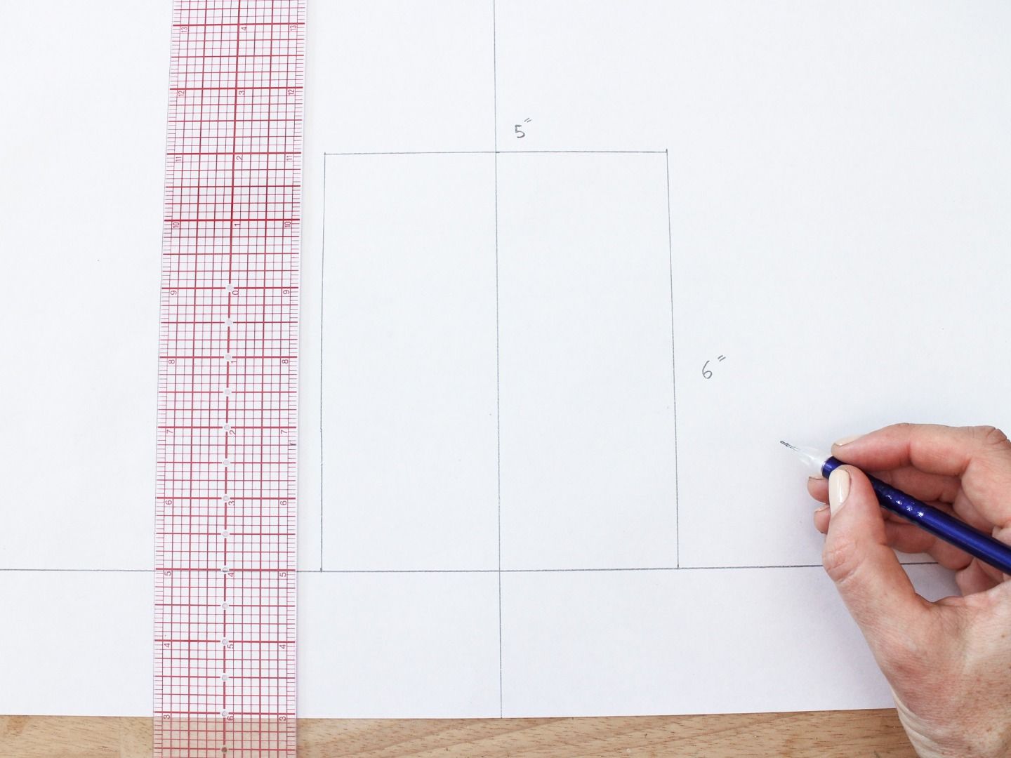

Now take your width and height measurements, and draw the basic outline of the bag from a front view around this center line. I made my bag 5" wide by 6" tall. If you are working with paper and pencil, use a ruler to draw your lines, if you are working in Illustrator, use the rectangle or pencil tool.
Take a look at the proportions of this outline and decide if you like the size and shape, if you don't, change it. Remember that the bag will end up slightly smaller than it appears here because of the ease that is taken up by the leather thickness. I decided to make the top of my bag slightly narrower than the bottom (I took 1/8" off each side) because I thought this created a nice shape. I also rounded the bottom corners because I liked the look and because curved edges will make it easier to sew in a one piece gusset.
Now add the details to the front of the bag. Draw in the flap as if it was closed add a pocket, buckle and strap and side loops. Make sure there is enough room for your buckle closure below your flap. Refer to your sketch, but alter your dimensions if you need to, so they look good on your draft. Think about what you will want to put in the front pocket and create its dimensions accordingly. I made mine 4" wide by 3 3/4" tall. If you want, you can draw these details on one side only, then fold your paper along the centerline and trace the details to the other side with an overstitch wheel. Below you can see what my front draft looked like when drawn by hand.
And this is what my draft looked like in Illustrator. Working this way is nice because you can easily test color combinations on your design.

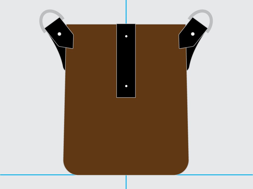

Now draw a back view with the same details. I made my strap come down the back of the bag about 2 3/4" inches and rivet in two places so it could be used as a belt loop.
Look at your final pattern drafts and decide of you like how everything is coming together, then make any small alterations. Remember that changes you make on the front might also need to be made on the back.

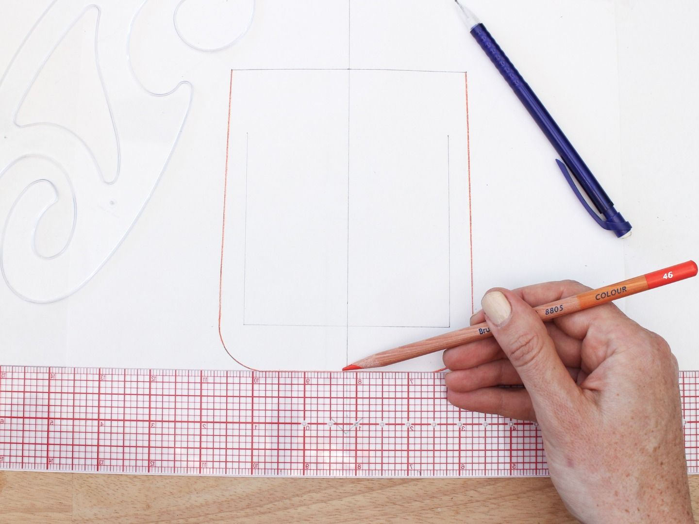

Step 7: Making the Front Pattern Piece
Now you are going to take the draft you've created and use it to create separate pattern pieces for each element of the bag.
If you are working in pencil and paper, you can trace off pattern pieces by placing paper over the draft (this is why it helps to have semi-translucent pattern paper). If you are working in a vector design program, just copy and paste different elements from the draft to turn into individual pattern pieces.

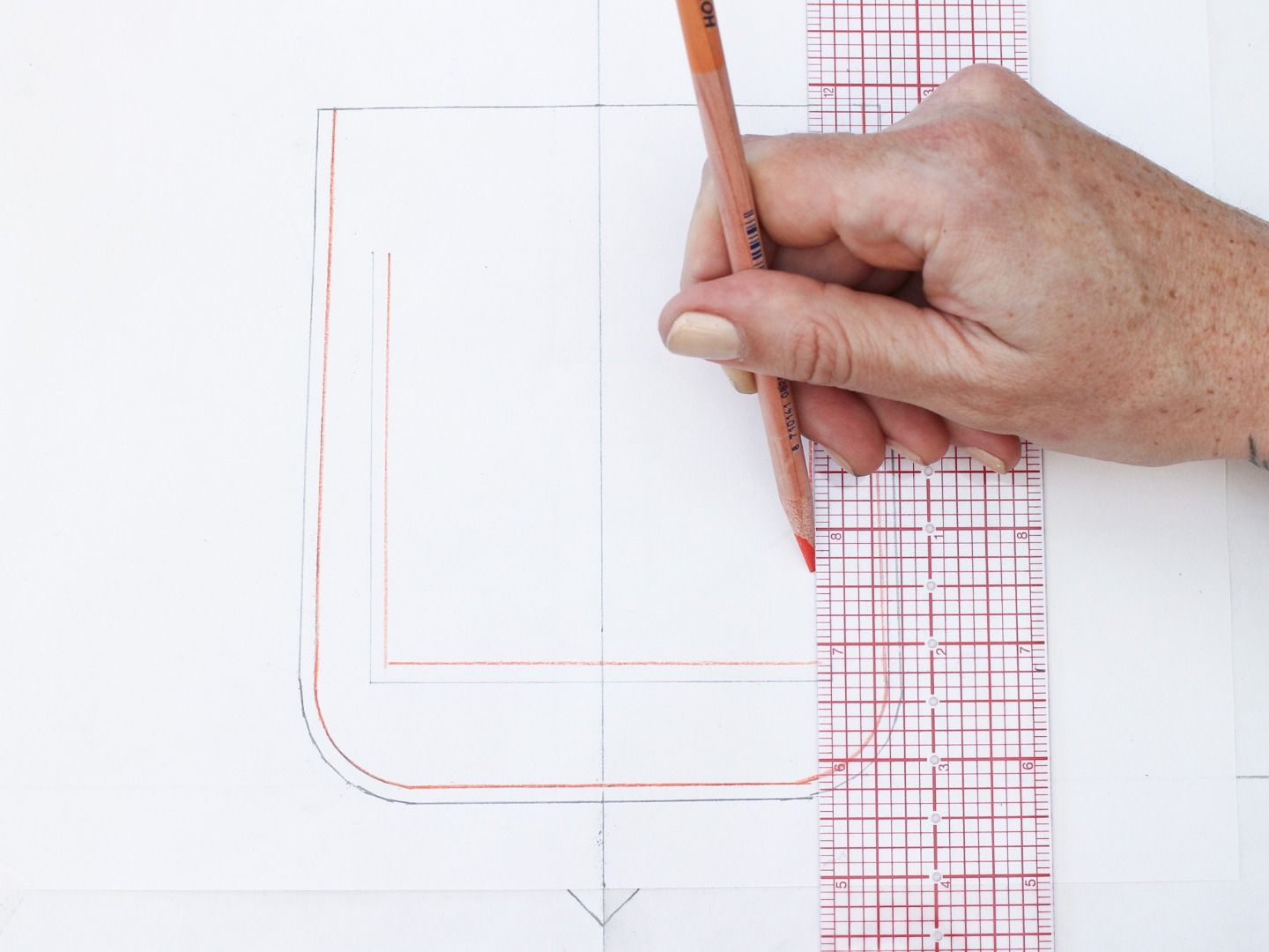

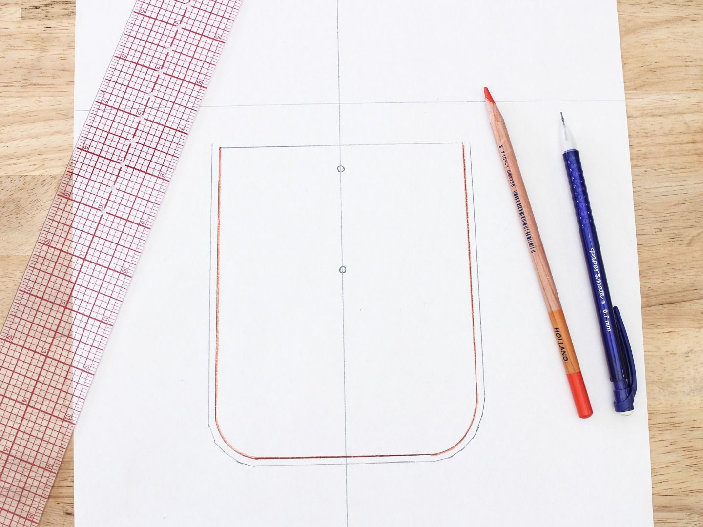

To create the front pattern piece, trace the front outline of the bag onto another piece of paper, also marking the shape of the pocket. Trace the sides and bottom with a colored pencil. Use your ruler to help you trace straight accurate lines whenever you can.

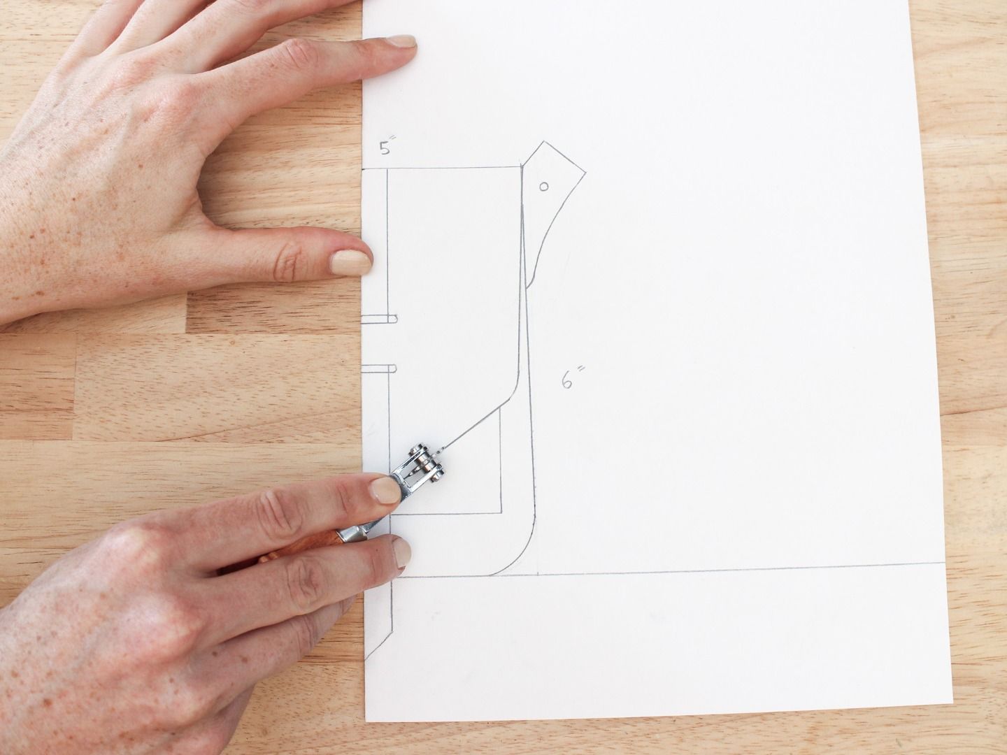

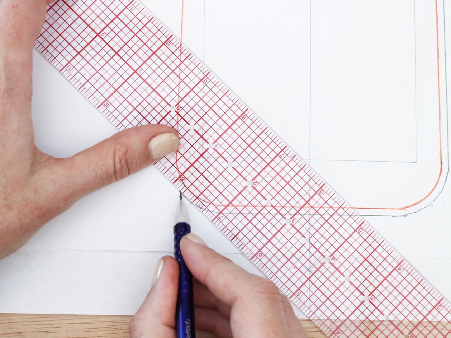

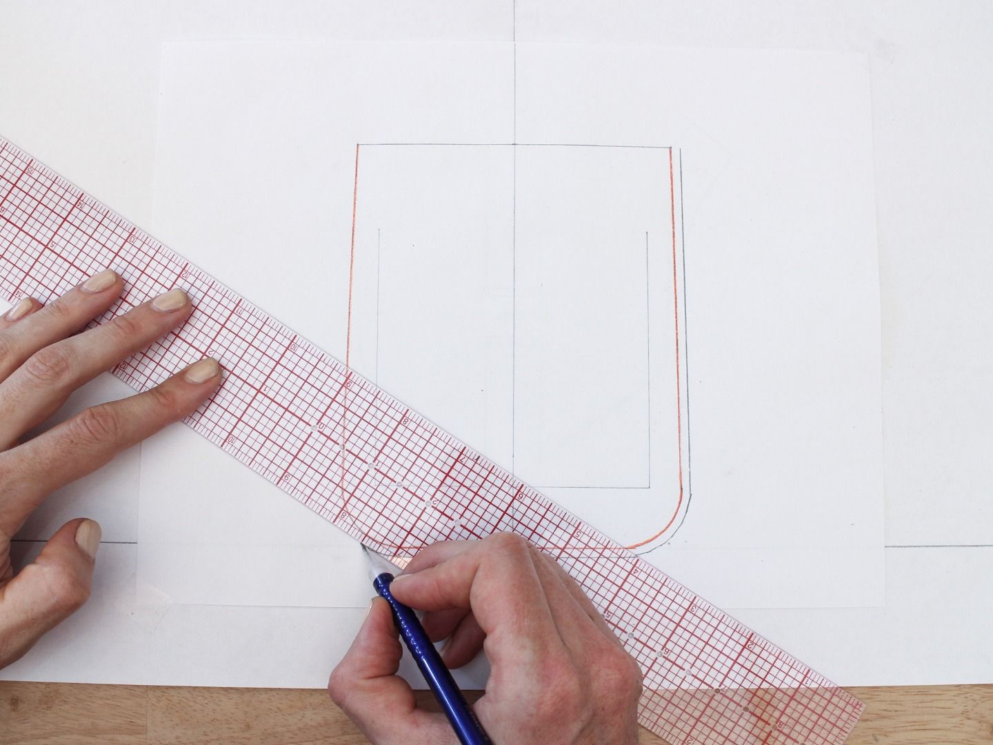

Now you need to add a seam allowance. To do this use your clear ruler to draw a second outline offset 1/8" out from the edge of the pattern on the sides and bottom. We don't need to add seam allowance on the top because there isn't a seam there. Seam allowances can differ in width depending on the project, but 1/8"-1/4" is a pretty good width for most leather projects because we don't have to worry about leather fraying like fabric.
Now we need to mark the sewing line where the pocket is going to be sewn on. To do this, mark a sewing line offset 1/8" in from the edge of the pocket. Mark sewing lines in a different color, or with a dotted line to differentiate them from cutting lines.

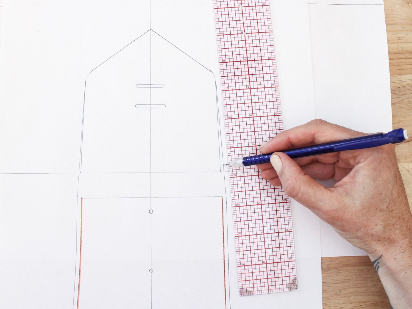

The front flap piece is an extension of the back of the bag, so we need to add that to this piece, but we also need to give the flap a little more length to account for the depth of the bag. To do this, take the gusset width measurement, divide it in half and draw a line this far above the top of the bag.
Why aren't we adding the entire width of the gusset here? If the leather we were using was stiff and the bag was going to hold its shape we would need to add the entire width of the gusset to the flap to make it long enough, but because the leather is soft, the bag will have a tendency to fold flat at the top unless it is stuffed full. We don't want the flap to be too long to buckle, or too short, so we will compromise by adding half the gusset width to the flap. This is another good example of how you need to adjust your patterns based on the kind of leather you are working with.
Now add the front flap to your back pattern piece by tracing it off your front draft. Take your ruler and extend the side cutting lines from the back up to meet the sides of the flap, blending the lines so they are straight. This may change the angle of the sides of the flap slightly, that's ok.

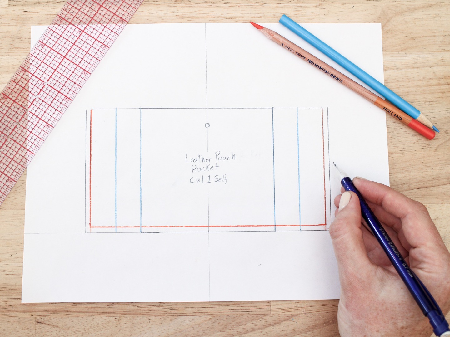

Step 10: Making the Pocket Pattern
To make the pattern for the pocket, first trace off the outline of the pocket from the draft (or just draw a new square the same size).
We are going to add accordion pleats to the side of the pocket so it will be able to fit more inside it. I decided to make the pleats 3/4" wide. There will be two creases on each side so I added 1 1/2" to each side, drawing lines on the pattern to show where the folds will be. Then I marked seam allowances 1/8" in from the edges along the sides and bottom.

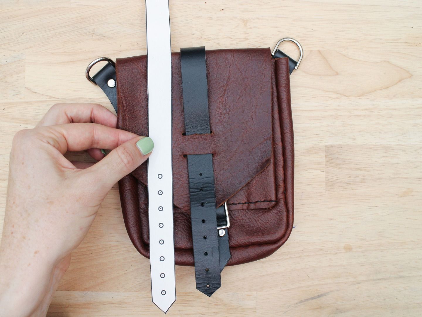

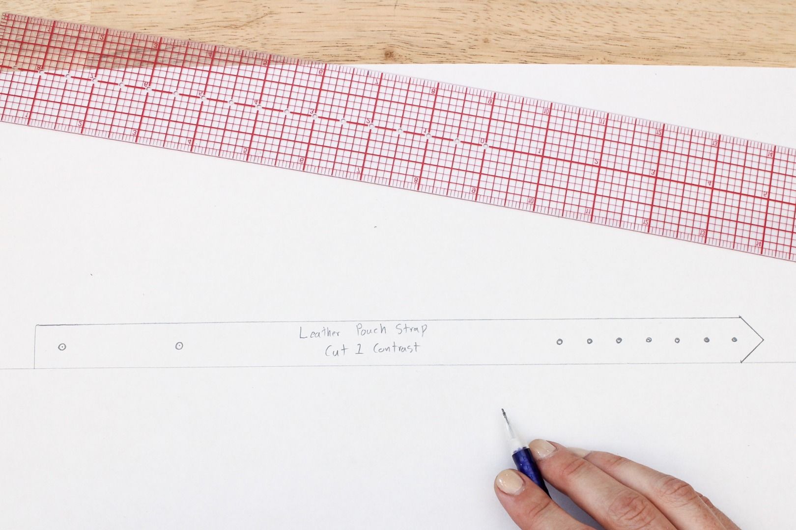

The last thing we need to do is make patterns for the straps. You can trace them off the draft, or just draw new shapes since they are simple ones.
To make the strap long enough, you also need to add the same half of the gusset width that you added to the flap between the back and front sections of the main strap. I made my straps 3/4" wide, and 12" long. Be sure to include the rivet hole positions on the back of the strap, and make 8 buckle holes 1/2" apart on the front of the strap. These holes and the buckle closure will allow the position of the flap to adjust a little depending on how full the bag is.

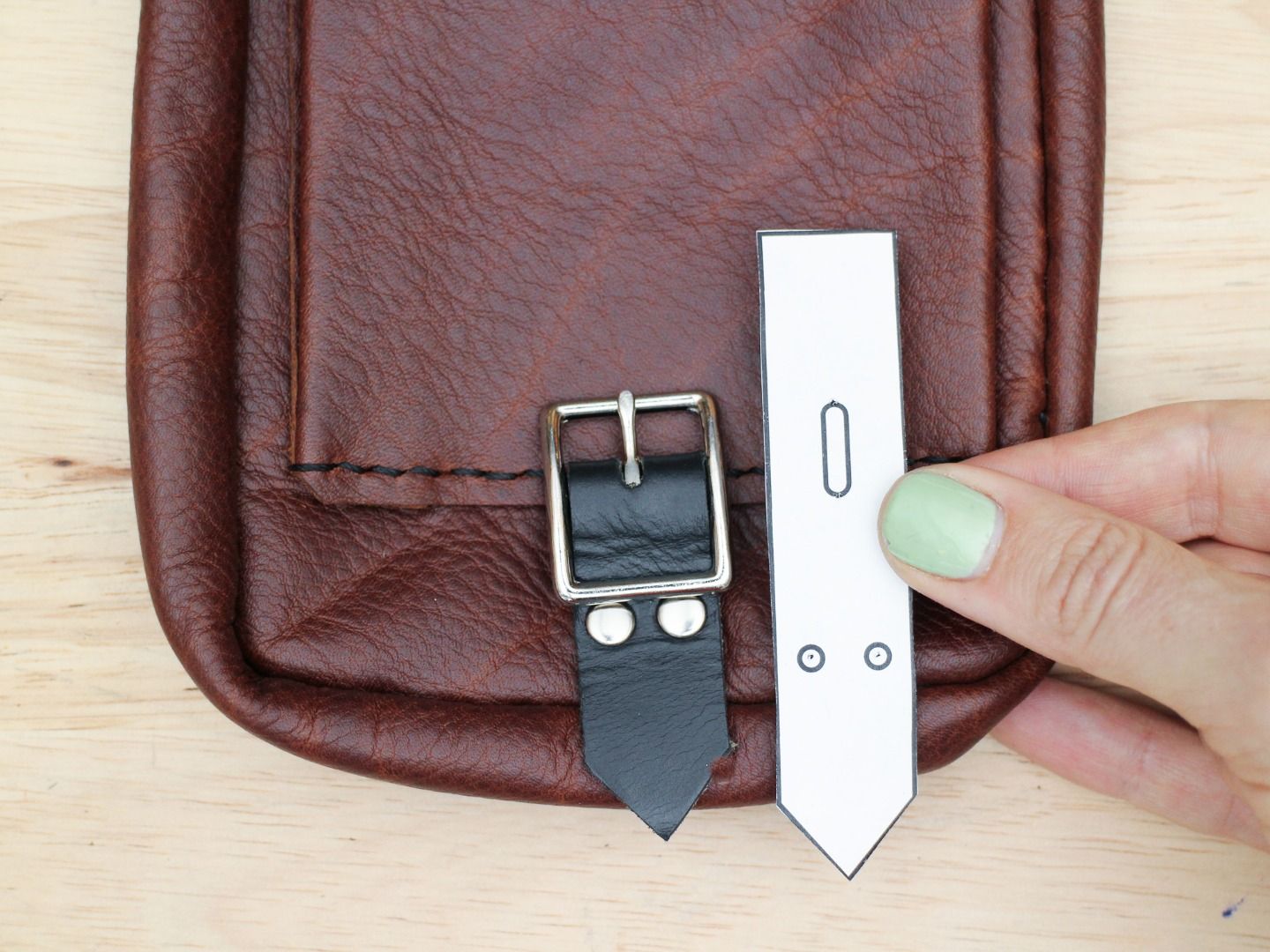

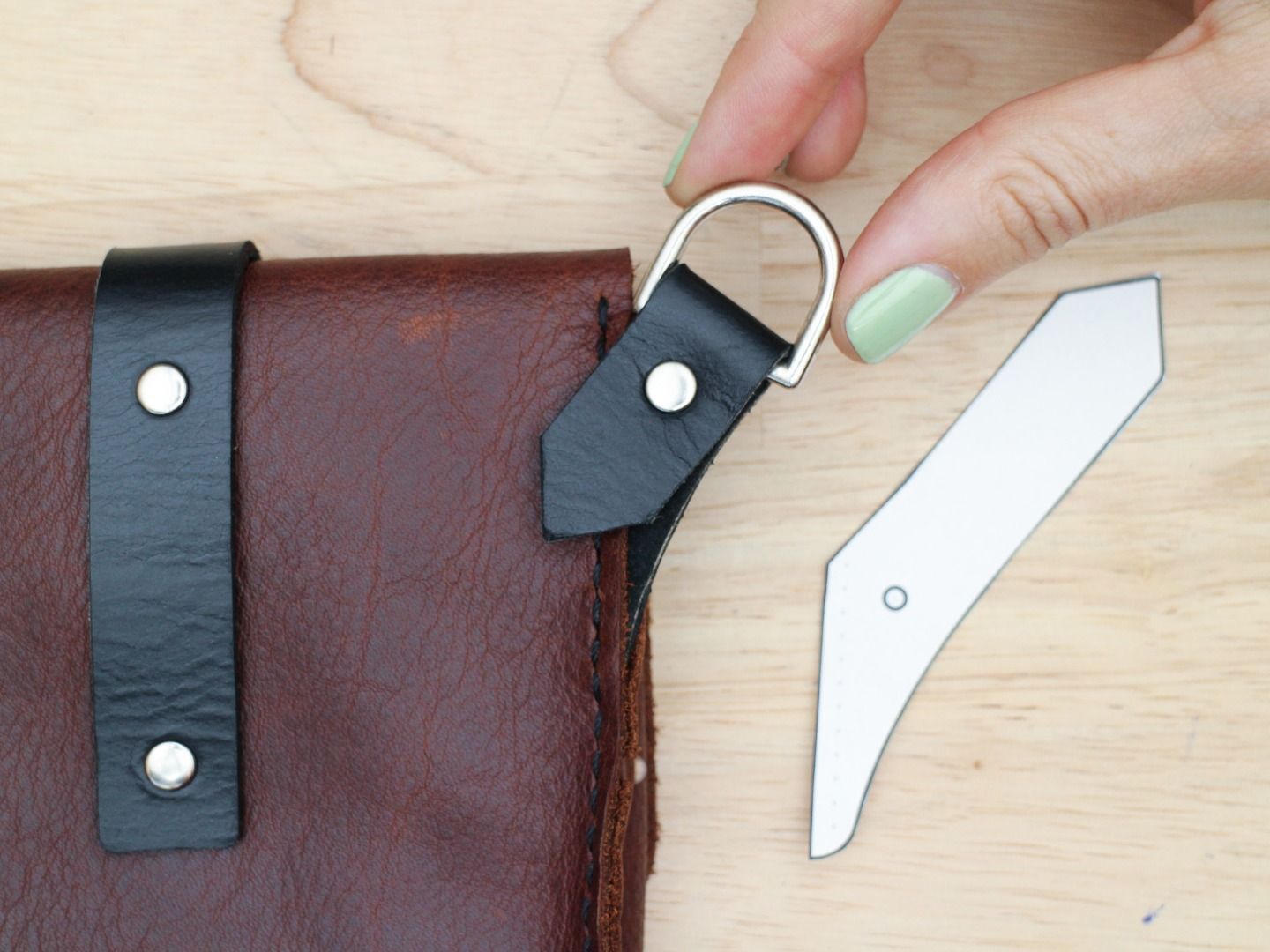

The strap that will hold the buckle at the base of the bag will be a loop that is riveted to the body of the bag. Make this piece long enough to form a loop that reaches from the bottom front seam of the bag to the point of the flap with a little extra and a pointed end on one side (mine is 3 1/2" long). At the point where the loop folds over there will be an oval shaped hole punched into the strap to attach the buckle.
The two looped straps at the top corners of the bag will be sewn in on one end and then looped around and riveted to hold D rings. Double their length to create the loops, add a rivet hole, and sewing lines 1/8" in from the edge.

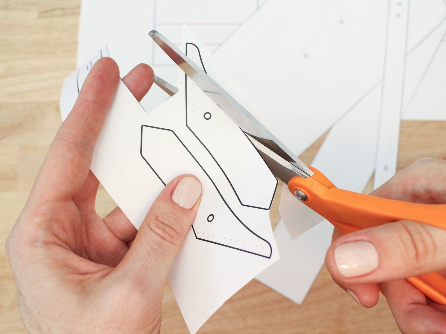

Step 13: Make a Mock-Up

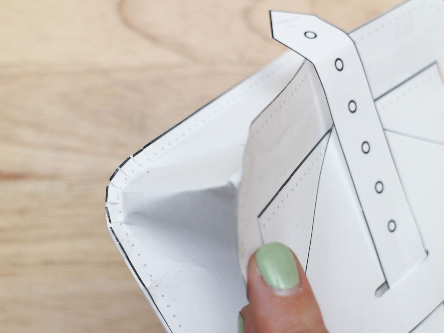

After I make a pattern, I usually cut it out and tape it together to see how it's going to look. This is especially useful if you've designed your pattern entirely on the computer because it can be a lot harder to get an accurate idea of scale in the digital world.
If you are taping together 3 Dimensional seams like the gusset on this pouch, you will have to snip the seam allowance so it will curve around the corners.
Keep in mind that your leather will fit together slightly differently because of its thickness, so not everything will work right in a paper mock up, but if you see any aesthetic or glaring technical issues, go back and correct them on the pattern itself before you move forward.
