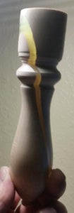

Introduction: Wood Turning: Ornaments Like No Other
This instructable describes how to combine two or three mediums (e.g., wood and plastic, or wood, plastic and copper) to make beautiful, eye catching ornaments that will stand out even along some of the finest ornamental art pieces.
This instructable explains how to make blanks, then how to shape, sand and polish them to produce ornaments such as those seen in the photos, above.
The ornaments in the photos were made by sandwiching colored, transparent plastic between two pieces of wood, turning them on a lathe, then adding a turned piece of wood I plated with copper.
You can use most any plastic, but solid colors will just look like the equivalent of straight lines of paint. For real impact, use clear or colored, transparent plastics. My favorites are the blues and greens, but, and as can be seen by the photos, the neon colors (e.g., orange, red, green and yellow), seem to capture and work with light to accent the ornament for a very unique effect.
Though not mandatory you incorporated it into your project, the addition of copper plated turnings goes almost indescribably far in complementing the wood-plastic laminated portion of the turnings.
This instructable does not got into the process of creating such turnings, since the process is a significant instructable in itself. Until I get around to writing and posting how I do that, you can find information on the electroforming process on line.

1.10.1 To make the blank easy to mount on a lath, or in a drill press, you need to find center on each end and drill shallow mounting holes.
1.10.2 If not already square, square the ends. This can be done with a miter saw, by pressing them against a sander, cutting them on a band saw using a miter gauge, using a sled and your table saw, or even using a hand saw and a fine tooth blade.
1.10.3 Measure half way across and as close to center as you can on the plastic and make a mark for center. I use a combo square or a marking gauge and check for center from both sides, then mark the center point, at the center of the plastic, using an awl (see the photos).
NOTE: Normally, I find center by drawing an X by making lines from corner to corner, but this works only if the blank is square. Since seldom worry about subtracting half the thickness of the plastic from each wood side or even worry overly much about insuring both sides were of an equal thickness, this will give me a center that lands center of the plastic.
1.10.4 Once you’ve marked center, drill a small hole for the drive and live ends of the lathe or other item that will hold the piece for turning/shaping the blank. About a 1/16th inch (.0625") bit, give or take a little, should be sufficient, and you need only drill about 1/8" deep.
1.11.1 Mount your blank on your lathe, on your drill press, or clamp it in a soft jaw vice (e.g., wrap it in cloth or foam) and begin shaping it.
1.11.2 If using a lathe:
(a) Keep your knives sharp and take light cuts.
(b) Experiment with different knives to see which one(s) give you the smoothest cuts. For example, I find roughing gouges rough blanks to cylinders well, and detail gouges do great for intricate shaping. I limit my use of skews to detail lines, and scrapers seem to be better for rough shaping than finishing.
(c) When near the final shape, take light cuts and keep your knives sharp to avoid chipping the plastic.
1.11.3 If using a drill press:
(a) Mount a drive center. If your drill press accepts Morris tapers, use one sold for uses on a lathe. If your Drill press uses a screw mounted chuck, a spur or Forstner bit may do the job of acting as a drive center.
(b) For the table end, you need something that will allow the blank to turn, without generating heat. A common live center (the pointed head turns freely because it is mounted using a bearing), that will accept a bolt on the end would suffice, though you’d have to mount it through 2x scraps to support it, before bolted to the table.
(c) Since the drill press turns slow, compared to a lathe, you’ll have to use files and rasps to shape your blank. I have used a Rotozip or a router and a LIGHT touch, but those will only be good for roughing in the shape.
(d) Keep in mind, your drill press was engineered for downward and not side pressure, so, if using it for these processes, try to avoid putting anymore side pressure on the chuck/drive than required to get the job done. In other words, it’s the usual advice “let the tools (e.g., rasps, files, sandpaper) to the work and be patient.
1.12.1 To finish your shaped blank, you’ll have to sand and polish it. When you do:
(a) Use a light touch with sand paper, meshes and so forth.
(b) Keep moving around the piece AND around the sandpaper, to avoid building up heat either.
(c) If you have trouble getting rid of lines, consider slowing the lathe or drill press down.
(d) While the piece is mounted on a lathe or drill press, you can stop the machine and sand in the opposite direction (i.e., end to end). Often, this will remove even significant scratches quickly.
1.12.2 Usually, 150 grit sandpaper will get you very near where you need to end up. If it doesn’t and is taking too long, back up to 100 grit, then move to 150 grit again.
1.12.3 Though other turners I know work through sandpaper grits, to around 1,500, I never bother going over 320 grit. Even then, I don’t work my way to 320 by first using 180 and 220. I just go straight to it, then move to buffing. Of course, if you desire to work through the grits and up to the higher grits, nothing prohibits it, but I think you’ll be surprised and happy with the results you get from my approach.
1.13 Once sanding is complete, buff your piece using a buff compound of your choice on a soft, spiral sewn buff wheel to bring out the high optical impact of the plastic, and smooth up the wood:
(a) At about 1,500 RPM [and even slower], you MUST keep moving, or you will melt the plastic. If you melt the plastic, it will still shine, but the melted areas will be conspicuous and will detract from the end product.
(b) You can use swirl mark remover for automotive paint jobs, which is sold at auto parts stores, to bring the plastic [and resin] back to crystal clear from a 320 grit and better sanded surface.
(c) The ornaments in the photos were buffed, while still on my lathe, using buff compounds I made using wax from toilet rings sold in hardware stores mixed with diatomaceous earth (my favorite), pumice and rottenstone thinned with just enough turpentine (paint thinner might work too, I haven’t test driven it yet) to allow me to mix the ingredients.
NOTE: Home made buff compounds using beeswax and diatomaceous earth, pumice, cerium oxide, baking soda and so on are cheap, easy to make, and can speed your project to a final, high shine. However, be aware rotten stone makes the mix dark, so can pose a problem when buffing light, porous wood.
1.14 Apply the final finish of your choice:
(a) While the beeswax left by the buffing processes, initially, looks nice, it fades VERY QUICKLY and has no durability. The sheen from beeswax can fade in hours. As such, you need a more durable finish, like lacquer, shellac and so on.
(b) Since the beeswax based homemade buff compounds leave a film, and do not provide an ideal end finish, clean the turning with a rag dampened with turpentine or paint thinner, then applying a final finish. However, merely buffing the finished piece with a clean rag seems sufficient to achieve a good finish with spray or dipped lacquer.
