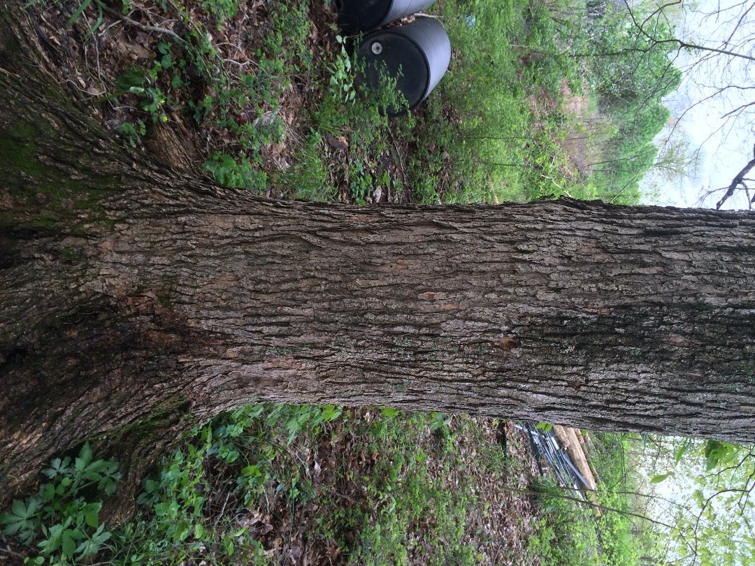

When selecting the right Mapletree you should look for a tree 14 to 28 inches in diameter. If you select a tree too small you could harm the tree. There are A variety of different maple trees preferably you should use a rock maple tree. If a rock maple tree is not available you may also use a white maple, the only downside to this is that the sugar content in the sap is slightly less than that of the rock maple sap.

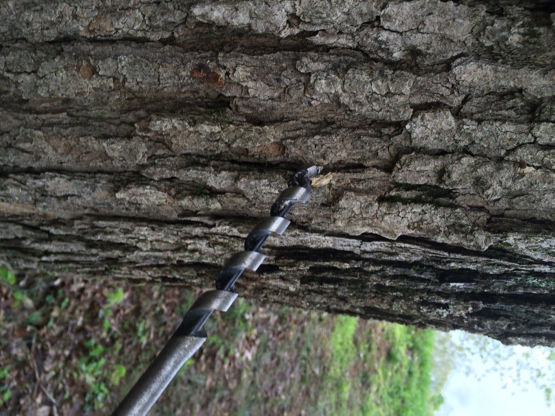

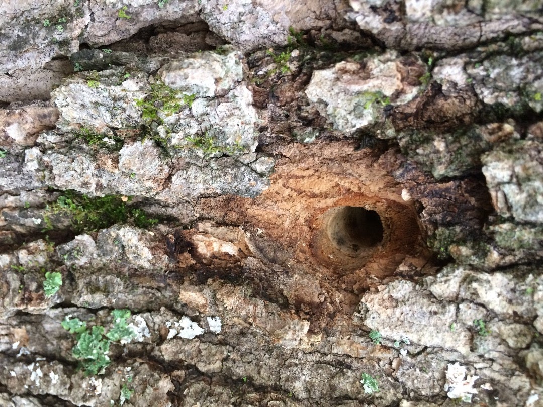

When you find the right tree to drill be sure the tree is large enough to safely drill. Next you want to put the drillbit up to the tree at a slightly upward angle, this allows the sap to flow down out of the tree through the tap. The ideal depth is 1 1/2 to 3 inches into the tree. After you have drilled into the tree be sure of the whole is clear of all debris. After this step move on to step 4.

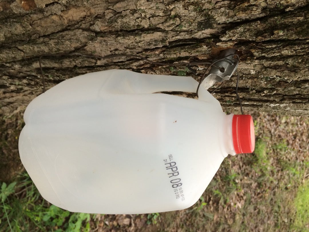

Once you have drilled the hole in the tree for the tap. You must them lightly hammer the tap into the Mapletree. After this step be sure to wire a old milk jug to the tap. To wire the milk jug to the tap cut a slit in the top of the handle on the milk jug to put the lip of the tap in. Please note the sap may not run as soon as you put the tap in the tree. Let the temperature drop overnight then let it rise allowing the sap to run the next day.

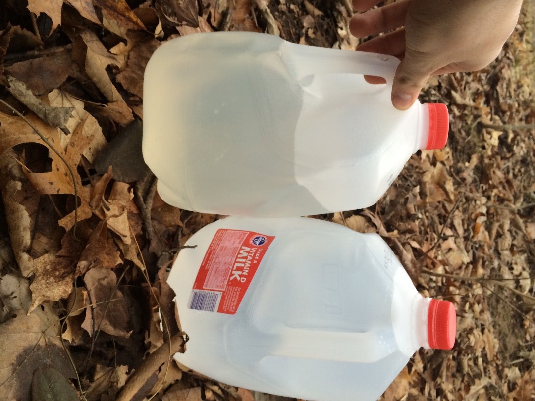

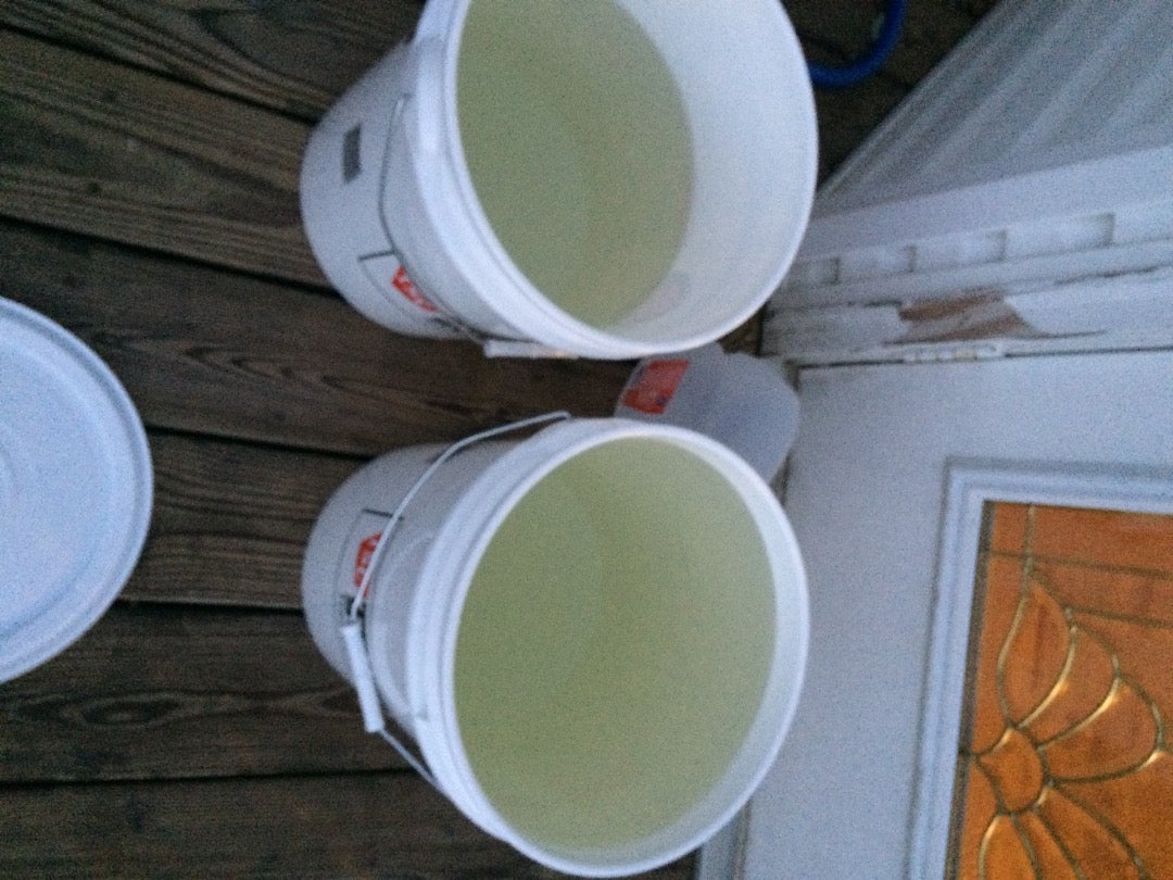

After you have let the sap run collect it when the jobs are full. If your sap is running well then it should be checked once a day. The sap should look a slight yellowish color and taste like sugar water. In the picture above notice the comparison between sap and water. The left jug is sap the right jug is water. Before you start your first batch of syrup be sure to have at least a 5 gallons of sap to boil down, this much that will produce 1 pint of syrup
