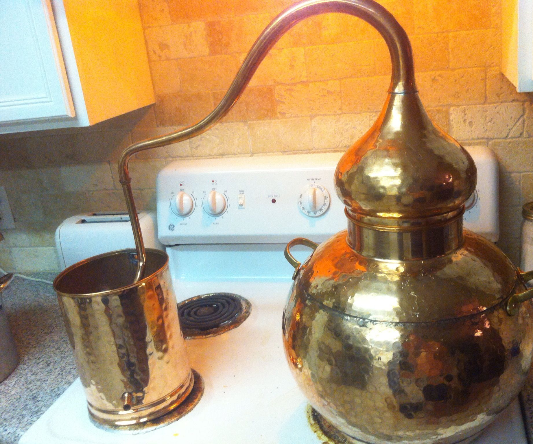

1. Set the base of the still on your heat-source.
2. Pour in mash, but take care to keep the sediments that have settled in the bottom of the container from going into the still since they can cause off-flavors. Additionally, leave approximately 4” of space at the top of the still to prevent boil over into the top section or worse, the swan neck and condenser.
3. Place and seal the onion top. The sealing can be done using a thick water/flour mix and pushing it in and around the seam where the top and bottom meet. Another option is wrapping the bottom of the onion head with plumber’s Teflon tape before setting it in the bottom part of the still.
4. Attach condenser.
5. Keep the condenser cool. This is done by filling the condenser body with water and continually adding ice (frozen water bottles work great too) or using a continuous stream of cool water from a kitchen faucet or water hose. Just put the supply hose into the condenser and either let it overflow naturally or use the outlet nozzle to direct the flow to a kitchen sink or flower bed.
6. Set a container at the outlet of the still to catch the moonshine. Keep in mind that while some plastics are fine to use, most are not able to safely handle high concentrations of alcohol. Play it safe and use glass, Mason jars are excellent for this.
