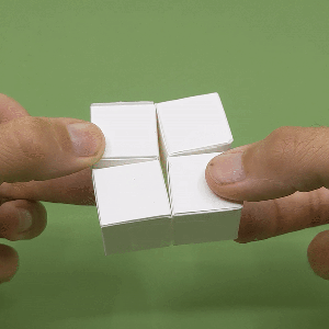

These cubes have so many names! I found the name Flexicube in Paul Jackson's Book "Cut and Fold Techniques For Promotional Materials". According to him it was already know as a marketing gimmick in the 1960's and it's hard to tell where it originated.
The basic Flexicube is composed of 8 cubes connected in such a way that you can rotate them and stack them to reveal different faces, reminiscent of a flexagon. It's a really fun toy and it provides a lot of opportunities for additional surface graphics.

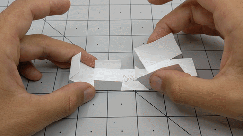

Step 3: Folding the Building Blocks
Once you've cut your blocks, start by pre-folding all the scored lines then close them with all the short tabs inside, a bit like a packing box, secure it closed using the shorter tab, no need to use glue at this step. The end result should be a neat cube with a long tab sticking out of one vertex.
We'll use the bigger tab that is marked with a triangle to connect the building blocks together.
Repeat 8 times :)

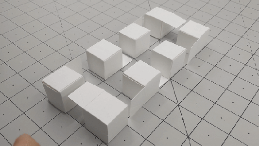

Step 4: Assembling the Flexicube
Use the above diagram to guide your assembly. I found it helpful to lay out all the cubes as in the diagram and work one at the time, always keeping an eye on it.
As you insert the tabs in the available slots, add a bit of glue as you go and push them as far as you can.
This is an exercise in spatial orientation so try to keep track of your cube order and orientation as you work your way around the assembly.
