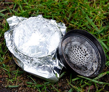

- Resin Burner
We used a small tin can (2″ diameter), turned the lid into a sieve using a hummer and a nail to pierce it. Make sure it’s plain uncovered tin inside, otherwise the coating substance would melt down and spoil your rosin.
- Aluminum Foil
Step 2: Getting the Resin Burner Ready
Line the inside of the tin can with aluminum foil.
Step 3: Burn It
Assemble the resin burner and place your resin into the ‘sieve’. Fire it. Crude resin does not start burning right away, be patient.
The high and quite impressive flame is produced by turpentine. All unneeded inclusions will burn out. It melts, smokes and boils, and your pure rosin leaks down through the holes onto the foil.

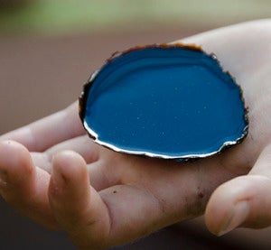

Step 4: Enjoy!
Here is your finished product. HOPE YOU ENJOY!
