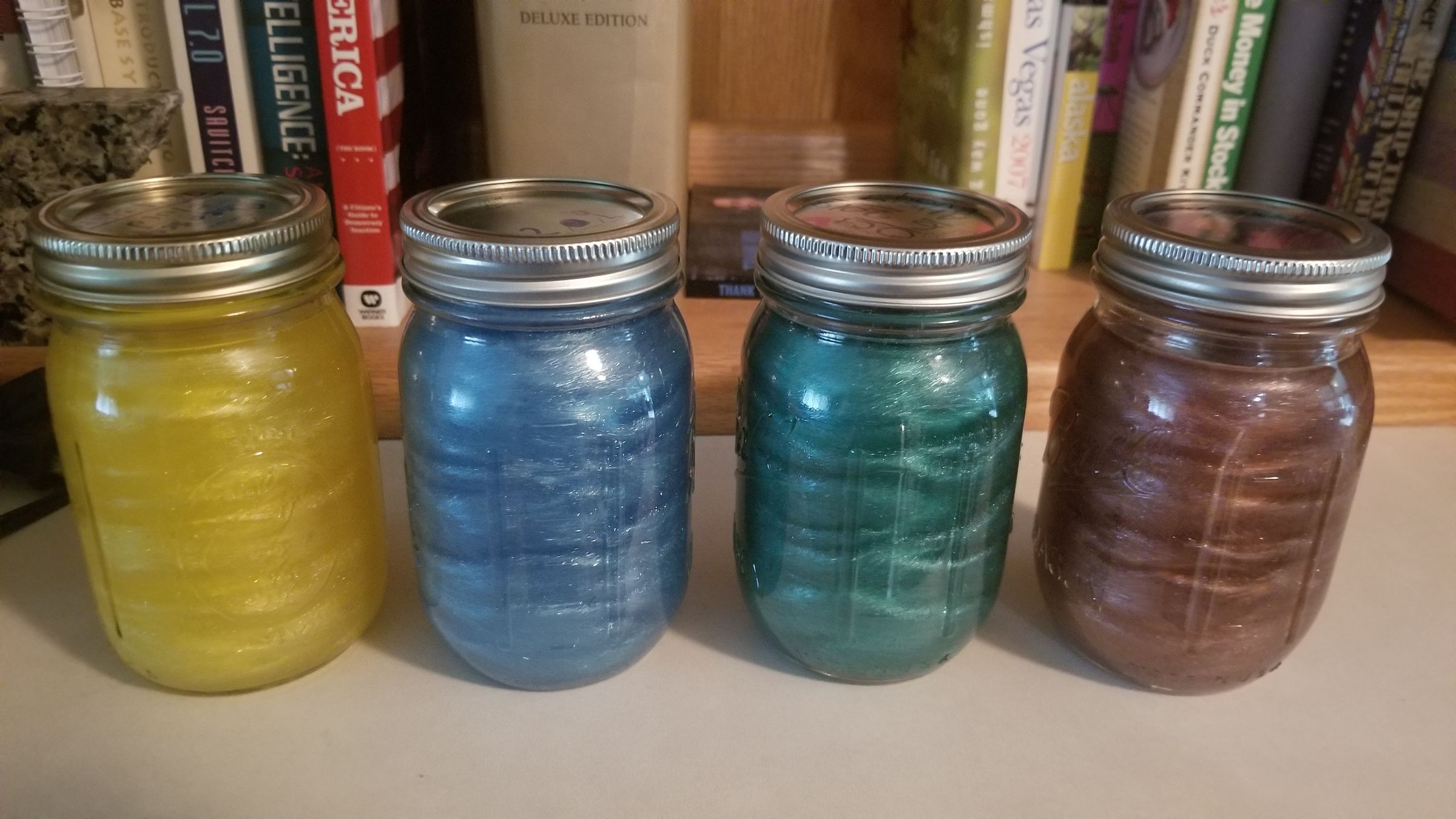

I took 1/4 tsp of mica and mixed it with 1 liter of tap water! It yielded a very nice flow visualization and suspension of particulate. After several minutes it will settle to the bottom, but when you maintain even the slightest movement it will remain. Also, I think it's quite possible to use less powder to yield still impressive results. 1/8 tsp per liter didn't have quite the definition of currents as Paul Matisse's table or kalliroscope, but it's still was pretty nice.
Simply adding a drop or two of food coloring per liter will give you great colors without diminishing the effect. You don't want to make it too dark a shade or it may block out light from reaching down into fluid. If you do make a darker fluid, you will need to add more mica to offset the occluded water. You can see in the photos that the plain white mica shines very bright, but is can be clouded substantially with (red) food coloring if used liberally. I am working on a ratio for darker mixtures and will update if I succeed.

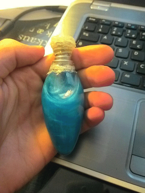

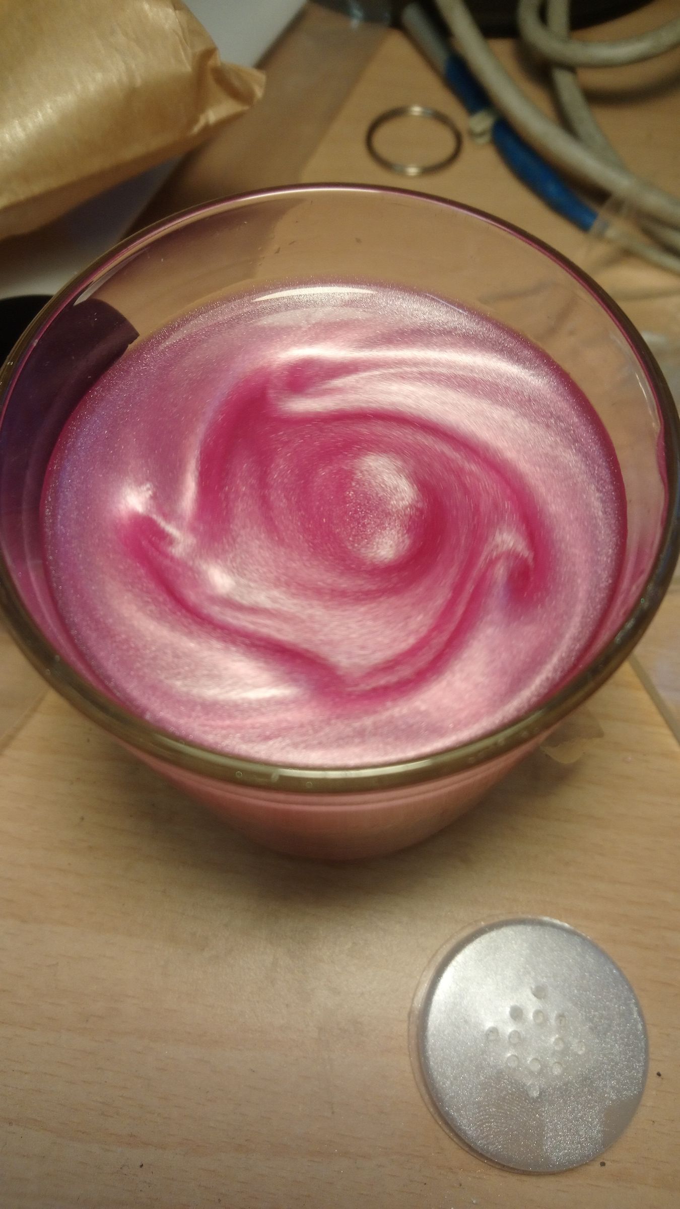

Great instructable! I'd used "PearlEx" (available at amazon.com: http://amzn.to/1ee2sP5) and it worked quite well - a little went a long way. Also added blue food coloring. Looks great with an LED lighting it from below. Thinking about making a small steel sphere inside of a very smooth sculpey losenge to put in the bottom, then setting it atop a small motor with a magnet to swirl it automatically, but haven't gotten to that one yet. Too many projects, too little time.

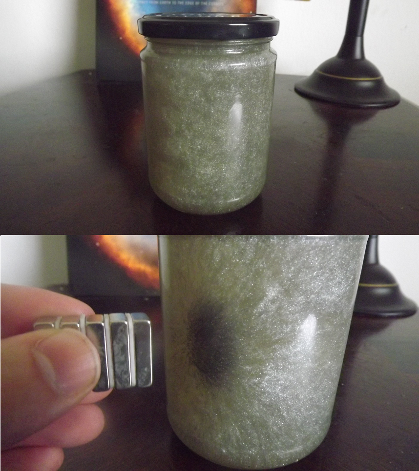

Hey, get out of my head haha! I just put some mica in a old magnetic viewer I made.
Another member asked about using oil (which didn't work sadly) to make a thicker fluid. I opted to use corn syrup mixed with water which I used for my magnetic viewer in the past. Instead of making a new batch, I just sprinkled mica into my mag viewer.
To make the magnetic field viewer, take steel wool, cut as small of shavings as humanly possible with scissors, add to water, mix in corn syrup til desired consistency. Next time I won't use as much steel wool or mica for more transparency. I'll have to put this in my additives section...
As for the tubing, I had some 8mm clear vinyl tubing I ran it through. The flow became pretty laminar/boring and it was really transparent. Still, I think with bigger diameter tubing and more mica, it would look cool. Sorry no pics; battery died :(

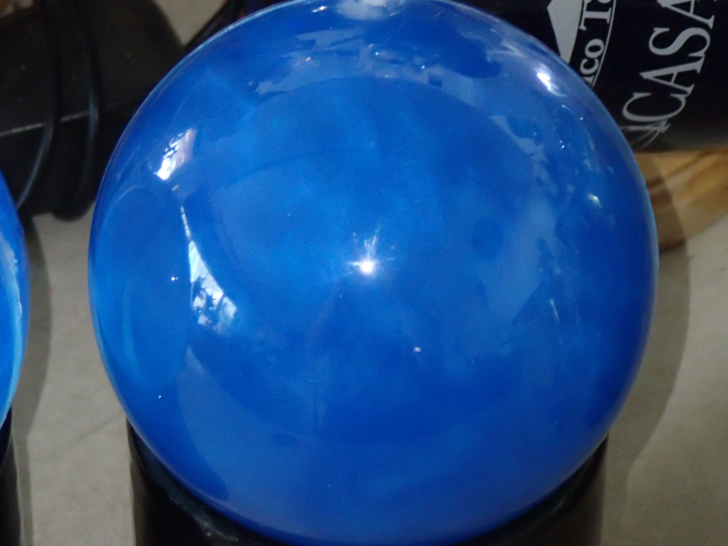

The Perc is a dense fluid and has almost the same density of guanine crystals (about 1,62 g/cm-3) so the guanine crystals will never go to the botton. Fish scales have a lot of guanine, but denser minerals too, so fish scales are good bot not optimal. Graphite has a 2.2 density so fish scales, mica, or graphite will go to the bottom slowly (but the cost of guanine is really high. it is a genetic lab reagent)

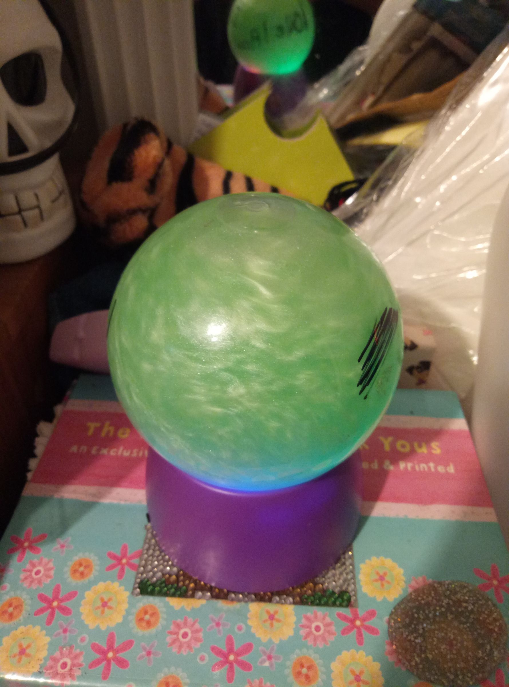

3 years ago

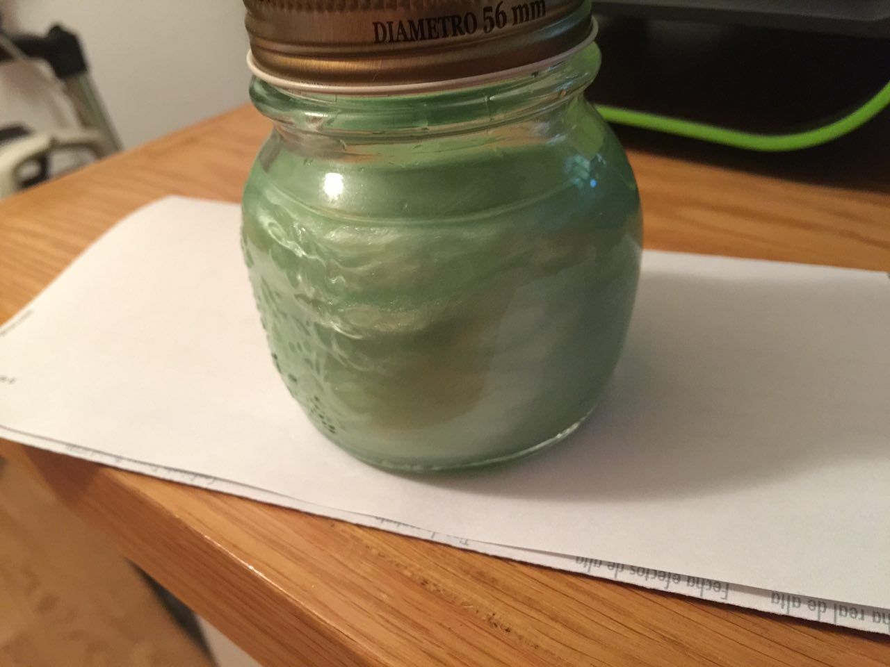

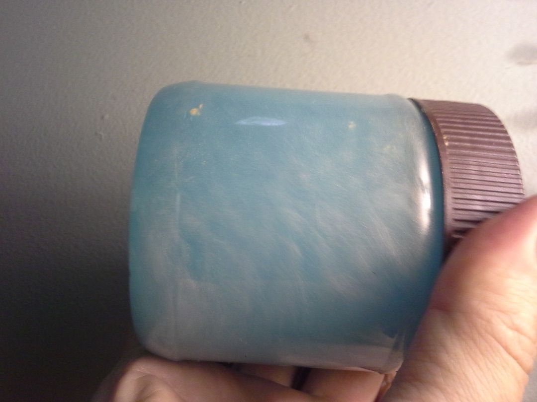

I've done this with pearl acrylic paint just put paint color of choice in water, had same effect, made sensory bottles this way, came across it by rinsing paint brush in a cup of water, what was left was pearly water.
