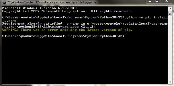

For making this project we are going to need the following modules -
1:) pygame - It is the module with which we are going to make our game
2:) random - Used to make random numbers
3:) sys - This module is used to work with python interpreter
Both random and sys module all already installed by default but we need to install the pygame module to install it open the file location of python and open cmd( command prompt ) and enter python -m pip install pygame

Step 5: Some Doubts or Problems With the Code That You Might Encounter
No 1:) Size being to big or small
  • You might need to change the coordinates according to the need increase them if the size is too small and decrease them if the size is too big in line 8 and 9
No 2:) The code not working
  • First you might need to check whether the pygame module is downloaded or not if not download it using the above steps
