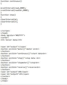

Step 4: The Mobile App That Controls the Fan
Sensor data
The motor on , stop and reverse button are to control the motor and start data and stop data are to start the sensors to sense whether the fan is on or not

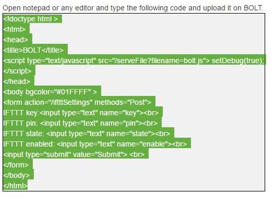

Step 5: Ifttt Used to Connect My Fan to My Mobile
In IFTTT,
1)create an account
2)in the statement "if this then that"......this=maker , and that = gmail
3)then create the recipe
4)goto chose triger then create trigger
5)then write the html code given
6)then submit and upload in bolt
Step 6: The Code

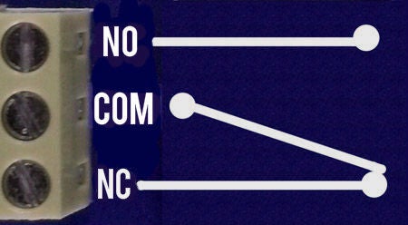

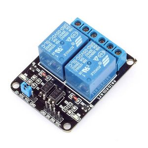

Step 7: Relay Connection Informations
COM-common connection
NO-normally open
NC-normallyclosed

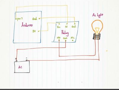

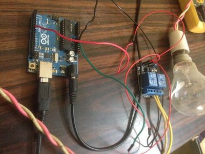

Step 8: Light Controling Circuit
steps:
  • connections
1)the pin 7 in bolt to in1 in relay circuit
2)5V to vccof relay module
3)gnd of bolt to gnd of relay module
  • we are using NO in relay,so that it can trigger on and off the light
  • Hot line from supply is connected to COM
  • Supply line to AC is connected to NO.
  • Gnd in light is connected directly.
