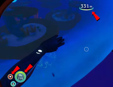

To do so we're going to put together a python script that monitors certain aspects of the game. For this, we're monitoring the health, oxygen levels, and depth. Depth will just be to increase immersion. I tend to avoid spoilers so I can fully enjoy the given game, but I did look into what the maximum depth vehicles can go to for exactly this purpose and set the deepest depths I expect to be red. On the way down, we'll flow from one color to the next such that we can visualize how deep we are with color in the room!
Next up is oxygen. If we're going to induce panic, there's nothing quite like the Sonic Music that plays when you're near drowning from <redacted> years ago. It gets us right in the childhood and gets the adrenaline pumping like nothing else. If the oxygen percentage drops below 15% we play the music. If the oxygen levels start going up, we stop the music.

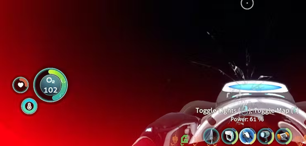

Last is health. Subnautica has a nice display when you get hit, mixing a red backdrop with a cracked screen, but adding a real life element really makes it hit home. As we'll get to momentarily, we're using an ESP32 for the led's and the buzzers. When we get hit, we pass a message to the ESP32 and make it buzz us so we feel it in real life.

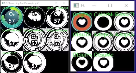

The majority of the code is in a python script that monitors the display with pytesseract. I also included a calibration program, which was super nice. Last time I dabbled in this type of thing, it took me way too long to hone in on the part of the screen I wanted to read data from. This time, the calibration program makes it a quick visual process. Much less painful.
The full python program for adding immersion does a lot. For oxygen and health I ended up doing different processing methods to visually interpret the data. It was a pain but eventually the result was pretty good. The depth is just text and that worked pretty well very quickly.

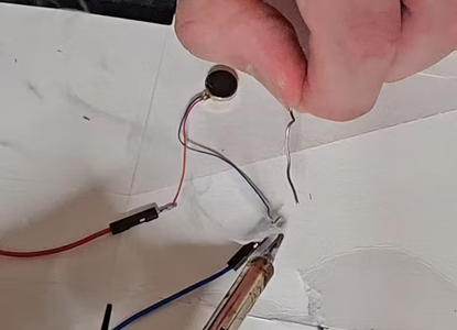

The last part of the process is the ESP32 side of things. The python program still handles the bulk of the processing, but we continuously listen for commands on the arduino side as well. Depth is passed ongoingly, anytime we get good values (which should be the vast majority of the time). A "buzz" is only passed when we take damage, and the arduino orchestrates playing a buzz through the coin buzzers.
To wire to the ESP32 is pretty straightforward. Here is a simple pinout:
D5 --> LED data
VIN --> LED power
GND --> LED GND
D14 --> buzzer red
D2 --> other buzzer's red
GND --> both buzzer's blue
