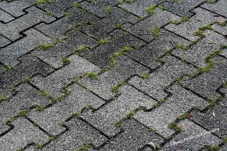

A tessellation is a type of tile placement and a great intersection of math and art. An easy example are bricks. You can fill a 2D plane with an infinite number of bricks. They are rectangles which makes them simple to place next to one another. Bricks can even be more complex like the H tile photo (Or even Texas shaped bricks!). There is a lot of math that can go into making a tessellation but the core principles can be replicated using a custom template in Inkscape.

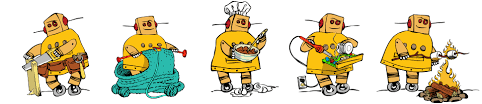

For my demo I will be making the Instructables Robot. I found the above image on google images and added it to my Inkscape Page.

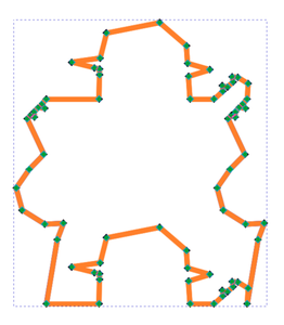

In this step you will need to manipulate the top and left most lines to make an outline of your shape. This is a frustrating process since any change you make will affect the other lines.
I wanted to make a basic robot but quickly got side tracked into adding a guitar. This will happen to you. You might be making a cat but think it looks more like a dog, embrace it! Play around with your designs and go down a path that seems easy but still fun!
Remember that you are only making the outline! Don't worry about details.
The guitar I added was just the soundbox and tuning pins. But when I color in the shape I will be able to draw it on in more detail.t

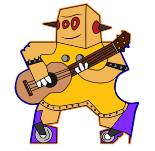

You can have fun here too. I often will color in duplicated objects differently to make them stand out (fisherman below). Here I decided to go more poster-like and made every other robot all black or black with gray outlines. Now my tessellation is done! I have demonstrated how a complex shape, the Instructables robot, can fill a plane.
