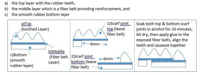

The GT2-3M belts are neoprene belts with built in lubricant, and a fiber reinforcement layer in the middle. The top layer has rubber teeth, the middle layer is a fiber layer, and the bottom layer is a smooth layer. To make the belt loops, I used a scarf-joint / lap-joint. I used a blade to trim away approximately 6-9mm of material from the top side (2-3 teeth from end #1) down to the fiber layer. For end #2 I trimmed the same length of material (2-3 teeth from end #2) from the smooth bottom layer, down to the fiber layer. These are the scarf joints on the ends of the belt. I prefer using 3 teeth length for a scarf joint. --EDIT: I have also been told that this is also called a lap joint. ---
Now I used IPA (Isopropyl alcohol 100% concentration) to wash out the lubricants that had been baked into the neoprene rubber. Let the exposed scarf-joint ends soak in the IPA for roughly 20 minutes. Now pull the scarf joints from the IPA, and let the alcohol dry away. Now apply Neoprene contact cement onto the exposed & alcohol cleaned ends of the scarf joint, and push the overlapping ends together (use a toothed spacer (either an oiled piece of GT2-3M belt, or use the 3D printed jig included in this tutorial, lightly covered in oil) to maintain the 3mm pitch spacing between teeth.

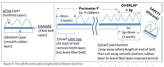

Measure the length of timing belt needed to fit your application. Cut this length plus 3-6 teeth (9mm to 18mm of extra length) depending on your confidence level with making the scarf-joints). You need to be within +- 1 tooth or +- 3mm max deviation.
Ex, if your belt is going to have a perimeter of 300mm (100 teeth), then you need to cut 309mm minimum (100 teeth + an overlap of 3 teeth/9mm).
People sometimes bungle making the top-cut of the scarf joint. If you think that you might make a mistake and get things wrong, then add an additional 3 teeth/9mm of extra length in addition to the overlap so now your 300mm belt now requires a strip of belt 300mm + 9mm overlap + 9mm extra = 318mm.
Step 2: Cut the Belt to the Required Length
Cut the length of belt. Cut between the teeth. The belt length needs to be the length of the perimeter of the belt plus a 3-tooth overlap (9mm in this case for a belt with a tooth pitch of 3mm) + 3 extra teeth in case of a mistake when doing the top scarf-cut. .
Ex: If the belt has a perimeter length of 300mm, then
a) we would need 300mm + (3 teeth* pitch between teeth) = 309mm exactly, (includes overlap)
b) to be safe, we add an extra 3-teeth in case we make a mistake on the top scarf-cut so we cut a length of
= 300mm + overlap+buffer length = 300mm + 3 tooth overlap + 3 tooth extra
= 300mm + 9mm overlap (3 teeth) + 9mm extra (3 teeth)

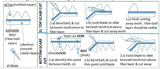

It can take a few tries to make good scarf cuts that go down to the fiber layer, but which do not cut through it. This means that it would be useful to practice both top scarf-cuts (where you cut away the teeth, cut away 3-teeth/9mm), and bottom scarf-cuts (where you cut away the smooth bottom layer, cut away 3-teeth/9mm) on a spare length of belt, without cutting through a lot of the middle fiber layers.
Practice doing a top scarf-cut, and a bottom scarf cut until you are confident that you can do it reliably over the length of 3 teeth (9mm), while leaving the middle layer mostly intact.
--EDIT: Once again, I have been informed that this type of join is actually called a LAP-Joint--
Step 4: Cut the Top Scarf Cut Over 9mm/3-teeth
If we know the required length of the belt (ex: perimeter length of belt)
Make the top scarf-cut by removing the top 3 teeth (9mm) down to the fiber layer. Remember that the belt was sized with a 3-tooth overlap/9mm longer than needed
(ex: belt length is supposed to be 100mm, then the exact belt length is 109mm (exact length needed) or
118mm (with 9mm overlap, and 9mm extra length in case we make a mistake doing the top scarf cut, and need to cut away the botched 9mm length). I find the top scarf-cut to be the hardest cut to make, this is why we include the extra length. It is trivial to trim away extra belt length if needed.
Step 5: Trim the Belt to the Exact Length, and Do the Bottom Scarf-cut Over 9mm/3 Teeth
If the top scarf-cut (the one that cuts away teeth) was done correctly the first time, then the safety length needs to be cut away before making the (easier) bottom scarf-cut. Trim away the safety length (now length = Perimeter length P + 3p of overlap. Ex: if Perimeter length is P=300mm, and belt pitch is p=3mm, now belt length should be 309mm.
Now after verifying that the safety length has been removed, make the bottom scarf-cut. It should be 9mm long. Remember NOT to cut through the fiber layer (some scraping is OK).

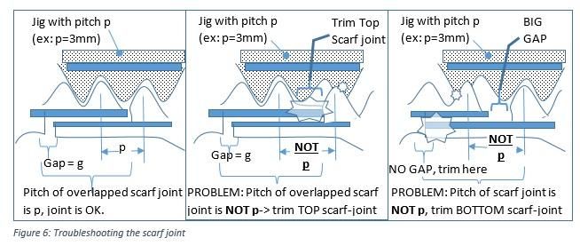

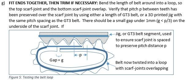

Step 6: Fold the Belt Into a Loop to Test If It Needs Trimming
Fold belt into a loop and use the jig (either 3D print, or length of belt) to verify that a pitch of 3mm can be maintained between the teeth of the belt over the scarf-joint. The teeth of the belt loop over the scarf-joint should easily interlocking with the teeth of the jig.
it is OK if there is a small gap where the smooth sides join up.
if the teeth of the belt will not fit/interlock with the teeth of the jig over the scarf joint, then the end of the top, or bottom scarf joint will need trimming. See wherre the belt has gaps, or collisions, and trim the problem-end accordingly. (please use pictures as guide). Trimming should be less than 1mm worth of trimming.
