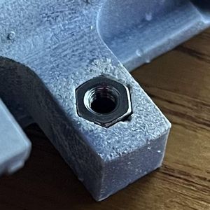

Step 10: Now to 3D Printing: Finally Time for Production Printing
SLA with production data.
The XY side of the print area is full with this data size. When I generate a support, it's a little out of the print area, but I think I can print it out somehow.
First of all, from the front parts. Then the rear parts. At this stage, the stacking accuracy is set to 0.05 mm. If the printout is successful, we plan to improve the stacking accuracy. It would be ideal if the stacking accuracy could be increased to 0.01 mm, but I will do it after considering whether it is really necessary.
As you can see in the picture, the ideal printout was completed. SLA, the highest grade excellent.
Anyway, I feel great!
Secondary curing. At first, it was secondarily cured with natural light, but it was not efficient, so I switched to UV light. Due to the limited frequency of use, I bought only an inexpensive UV light and put aluminum foil on the inside of the small box for secondary curing. Although the curing effect was obtained, the amount of UV light was low and it took a long time to cure. So, when I switched to a full-fledged curing device, I was able to obtain the curing effect in a short time. (Of course, I returned the cheap UV light)
* There are some points to note. The resin used in the initial stage gave good results, but the other resin purchased after that had low reproducibility and was fragile, so the joints such as dowels were chipped.

Finally, insert the M3 hex nut, which is necessary for connecting to the rear part, into the hex hole at the bottom of the front part and fix it with adhesive.
This completes the installation on the front part.
