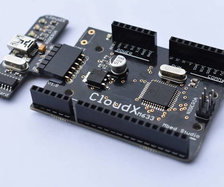

Step 1: FOUR WAY TRAFFIC LIGHT WITH CLOUDX MICROCONTROLLER
Using CloudX development board for traffic control is as simple as ABC; its as eazy as "Every one can do It".
On this project, i have implemented functions in this project for both educational purpose and industrial use. None the less, it is better as a programmer, it helps in debugging. The code is simple to read, modify and implement.
NOTE: for more info on CloudX follow this link
So it goes thus:

Step 2: Steps You Should Follow
Having your CloudX board and 12 LEDs(4 red, 4 green, and 4 yellow), connect the every thing as shown
1. Open the CloudX IDE,
2. Start a new project with an empty ,
3. copy the above code and paste it into the empty page,
4. compile and upload to your board.
