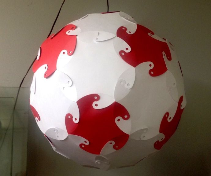

In the first picture there is a piece of white card stock and a piece of yellow card stock,
half of each was treated with the polyurethane. They are laying half on white and half on black.
You can see how much more translucent the treated part is.
The other picture is the white card stock with sun light on it.
The bottom part is the treated part, and you can see how much more light is transmitted.
