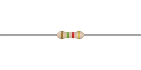

  • Two resistors (I'll explain that later) - about 680 ohms or 220 ohms

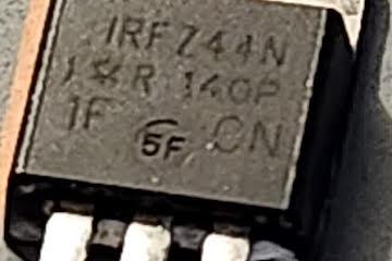

  • *Optional* a IRF44N

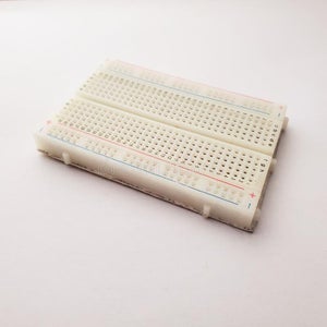

  • Breadboard

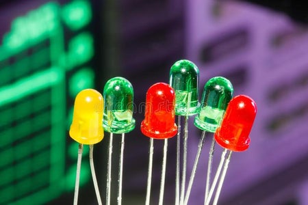

So, what is special about this project, you may ask? The purpose of this project - and why it's so special - is to demonstrate how we can take two regular LED's and create a bi-color LED. This is great because you may not be able to find a specific color you like, such as pink and blue. *NOTE - the bi-color LED ONLY allows one color at time.* Take this as an... experiment, if you will.

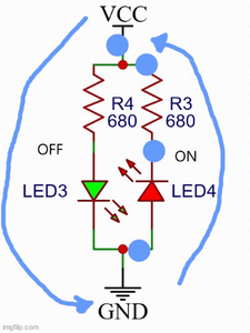

How does it work? This is the more of the "theoretical" part of the project. The video (right above this text) shows the calculation to the theory behind it. The theory behind this is a thing called, "parallel circuits." But, here is the catch: this circuit works with even reverse polarity! Isn't that cool?! Anyways, the thing about this is that it works almost like a switch of some sort. The most basic way I can describe this "flip-flop" process is that this switch-like device actually can, again, change polarity and have one LED on while the other is off!
I marked up a schematic (shown above - as a GIF) that crudely shows the inner workings of this process. Also, keep in mind: only, and I mean ONLY, one LED can illuminate at one time!!! Also, the resistors are REQUIRED. I'll explain in the next step.

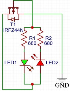

Of course, those were a few applications - and they were random - but, we should just dive into the topic. I mean, after all, I only have your attention for so long. Any who, the schematic. Yes, the schematic! Okay, so the first thing I did was get a 12V "adapter" or power supply. The second thing I did was use the IRFZ44N (the transistor). Wait! Hold up!
Why are you using a IRFZ44N? Easy. I am using this because of the fact that my stepper motors (future tutorial), on my claw machine (also, in another tutorial), shouldn't be reversed polarity. This means, if I connect the power backwards, my stepper motors would be fried! Anyhow, moving on...
The third step is to connect the LED's in parallel (as described in Step 2). Positive of Green LED is on the negative of the Red LED. Hopefully, that made sense. If not, then, comment down below. (Yes, I know they are both red). And, please, please, please, DON'T FORGET THE RESISTORS WHEN USING 3.3V OR MORE!!! The last step is to make sure power is connected.
