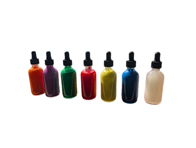

I decided Aniline dyes were not a good idea especially as we have modern materials so I made a simple change and decided safer artist oil inks will be much better vibrant and "light safe". Historically turpentine or benzine we're used, now alcohol is a much safer item. I want to make a uv/blacklight one later on. [made a uv one works great!]

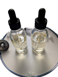

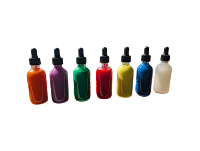

I chose 2oz eye dropper glass vials [These make a good amount of ink that makes a nice display piece]
A 1" foam/sponge brush for each color we wish to make
10mL Syringe for liquids with good increments which will make measuring much easier we need one for each liquid. one alcohol, one ink and one caster oil

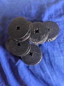

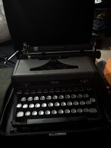

You will also need a spool, I used the file from here and printed new spools: https://www.thingiverse.com/thing:437149
They worked fairly well on my Royal Quiet Deluxe :)

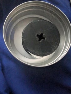

4oz 120ml tins for the spools when they are done
[ I recommend these as they will help keep ink fresh ]

  1. Print Your Spools
  2. Use your 3D printer to fabricate two matching spools: one feed and one take‑up.
  3. Make sure the hub fits snugly on your typewriter’s ribbon pins.

Step 2: Measure Out Our Ingrediants
Sanitize & Prep
  1. Wipe all tools and containers with alcohol; let evaporate.
  2. Wear gloves to avoid contaminating pigment.
Measure Castor Oil
  1. Pour 40 ml into your cylinder or draw to the 40 ml mark with a syringe.
  2. Transfer the oil into the mixing jar.
Dispense Oil Paint
  1. Squeeze or scoop pigment to the 20 ml level.
  2. Scrape it into the jar, using the stirring tool to get every bit.
Combine & Emulsify
  1. Stir slowly at first to avoid splatter, then briskly for 1–2 minutes until the paint fully disperses in the oil.
  2. You’re aiming for a smooth, homogenous paste.
Adjust Viscosity
  1. Add 1 ml alcohol dropwise, stirring after each drop.
  2. Stop once the mixture flows easily off the stir stick without running too thin—up to 3 ml maximum.

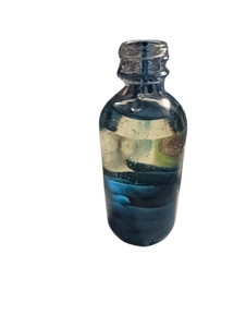

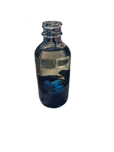

Shake to mix the ink
  1. I shook the vials for a few minutes each to mix the paint as it was rather thick and the alcohol needed to break down and combine the materials especially for the uv ink.
Strain Out Lumps [I didn't need to do this but might help]
  1. Pour the ink through a fine‑mesh strainer or coffee filter into your storage bottle.
  2. This removes any undispersed pigment or skin.
Step 3: Label Your Containers
Label & Rest
  1. Label your storage bottle with “Typewriter Ink,” the preparation date, and the recipe ratio.
  2. Rest for 12–24 hours so air bubbles rise and pigments settle slightly. [I didnt bother but the instructions from the reading material covered this]

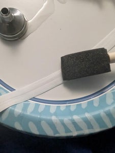

Step 5: Application
Prep & Tension
  1. Anchor the ribbon ends with clips or pins on a clean, flat surface so it’s taut but not overstretched.
  2. Ensure no wrinkles or twists—this gives an even coating.
Light Coating
  1. Dip a fine‑bristle brush or small foam sponge into your ink.
  2. Remove excess ink by brushing once on the jar’s rim: you want a thin film, not a puddle.
  3. Glide the tool along the ribbon’s length, applying one light, even stroke per section.
Avoid Over‑Saturation
  1. One thin layer is all you need; heavy brushing will soak through and gum up the type guides.
  2. If you see beads or drips, blot gently with a lint‑free cloth before moving on.
Drying
  1. Leave the ribbon stretched and flat in a dust‑free area.
  2. Allow 2–4 hours (depending on humidity) until the surface feels dry to the touch but the ribbon remains flexible.

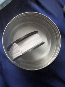

Re‑Spooling
  1. Once dry, release the clips and carefully wind the ribbon back onto your spools.
  2. Keep tension even as you rewind to prevent loose loops or tight spots.

Post‑Dry Storage:
If you’re not installing the ribbon immediately, seal it in a dust‑free, airtight bag or container—this preserves flexibility and prevents dust from sticking.
