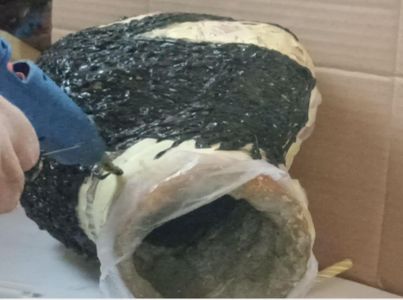

Step 2: Adding a Black Hot Glue
Ok the mummi Mannequid with drawing venom eyes and mouth is ready, now for put some black hot glue in top oh the mannequin surface, we start by making a line on the image of Venon's eyes and mouth, before that, wait for the hot glue gun to heat up with the right temperature, when pouring the hot glue don't press too much so that the surface of the glue has an irregular texture layer so that it looks more natural.
Do this all over the surface, head, neck, slightly inside the mouth except for the eyes, leaving the eyes empty.
