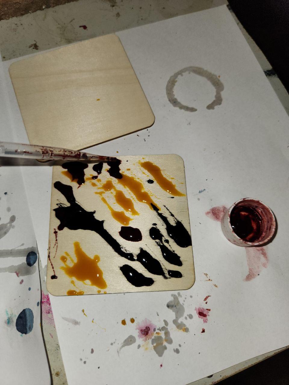

Step 1: Applying the Soap Dyes to the Wood.
For the soap dyes we have 36 different dyes each 10 ml of dye. We just add a small amount of the dye to the wood and use a pop stick or pipette to move the dye around the wood. I would recommend a plastic pipette since it avoids absorbing the dye with it.
For example, you could mix some soap dye blue with soap dye red with the pipette.
Another method is the bubble-wrap method of adding soap dyes to the soap dye. Wear gloves. I recommend it and apply the soap dye (any of the colors you want) and apply the bubble wrap method. Dabbing the dye on the wood and letting it dry for at least 5 hours.

Step 3: Allowing the Rit Dye to Dry on the Wood.
A notice that Rit dyes that are pre-made (Salt, dye, water) can be added fresh and pipetted on the wooden board or diluted. I haven't worked with the diluted method that much but a 1:1 ratio (Rit dye to water) will work nicely. You can blot dry or bubble wrap this dye just like the soap dye.
Keep in mind i strongly recommend that you allow the dye to dry for 20 hours before adding the epoxy. Otherwise the epoxy may transfer the dye to one wooden board to another.
This happened once in the next step i will show that result if i would have waited a few more hours (3+) this could have been minimised.
Altho you can order the Rit pre mix and add the water itself it may be a lot easier to just buy the Rit dyes.
