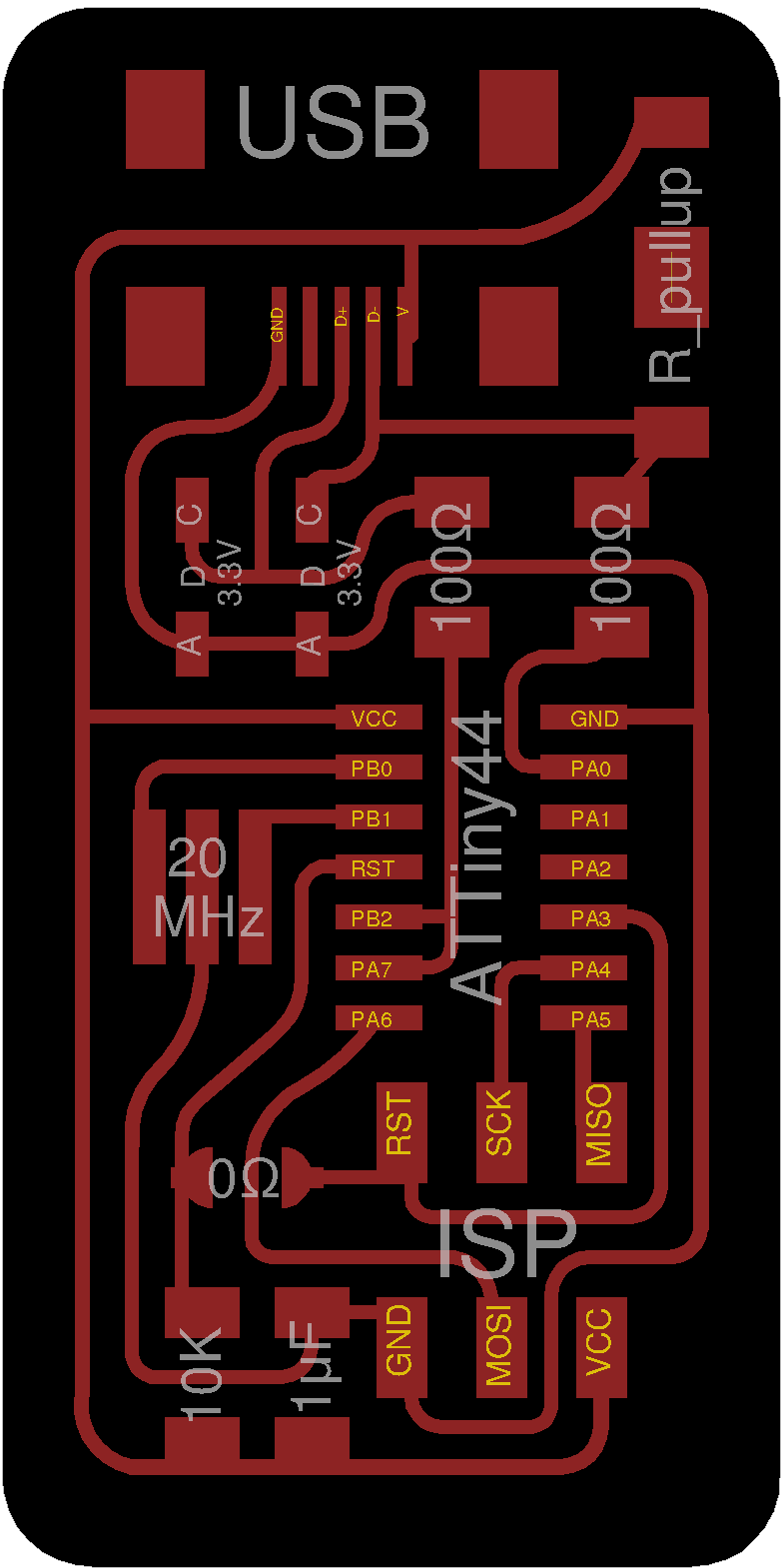

This page arose after the observation that there are plenty of resources on the web explaining how to build and program your own FabISP, but almost none which explain in detail the purpose of each component on the board, and how the board actually works. The aim of this page is to provide a comprehensive explanation about the design of the FabISP, to show where the need for each component on the board originates from, and to explain the chain of reasoning for designing a FabISP from scratch without referencing an existing design. The Prerequisites section contains resources for all of the topics you must first learn in order to fully understand the FabISP. Thus, the content is suitable for beginners, experts, and everyone in-between because the assumption is that you would begin by learning all of the prerequisite topics first.
You will also find here my own version of the FabISP, which I designed as a reference board for the content on this page. The board is similar to Neil's version of the FabISP, but with a few key differences. There are no jumpers on the board other than the 0Ω resistor required for programming the board. The two series resistors (1KΩ + 499Ω) have been replaced with a single resistor R_pullup in one of the versions (more on this later). And lastly, the components and traces have been laid-out in what appears to be the most optimized way possible, that leaves no underutilized space on the board, leaves more clearance between traces, and results in a much smaller profile. Hence the name FabOptimus. (If you find or come up with a more optimal layout that does not sacrifice trace width, let me know.)

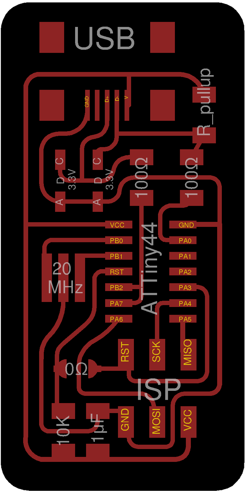

There are two versions simply because in the inventory we don't have 1.5K resistors (nor resistors whose parallel combination is 1.5K), but we do have 1K resistors and 0.5K resistors. Thus if relying only on the components in the inventory, you must use the version where R_pullup is 1K+0.5K. But if you have a 1.5K resistor, (or the means to create a 1.5K equivalent resistance by stacking 2 or 3 resistors in parallel), then you can use the version where R_pullup is 1.5K.
Design Files (R_pullup=1.5K): traces.pngoutline.png, FabOptimus.brd, FabOptimus.sch
Design Files (R_pullup=1K+0.5K): traces2.pngoutline2.png, FabOptimus2.brd, FabOptimus2.sch

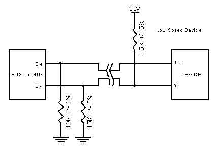

USB Electrical Characteristics - http://www.beyondlogic.org/usbnutshell/usb2.shtml.
https://www.fairchildsemi.com/application-notes/AN/AN-5052.pdf ← look at pages 3 and 5.
  • USB uses a differential pair for data transmission. The complementary signals are D+ and D-.
  • The signaling on the D+ and D− lines is within 0V to 3.3V rails, while the host-supplied Vbus is 5V.
  • The USB Specification requires 15kΩ +/- 5% pull-down resistors on D+ and D- on the host side. These pull-down resistors will condition the data pins LOW, indicating that data transmission is not possible in that condition.
  • A USB device indicates its speed to the host by pulling D+ or D- to 3.3 volts with a 1.5kΩ +/- 5% resistor. From the voltage divider equation, it follows that the voltage on the data line that is pulled high becomes 3.3V(15K)/(1.5k+15k) = 3V
  • If the device pulls D+ HIGH (D+ – D- = 3V), it identifies itself as a full-speed device to the host.
  • If the device pulls D– HIGH (D+ – D- = -3V), it identifies itself as a Low-Speed device to the host.
  • If D+ nor D– is pulled HIGH (D+ – D- = 0V), the host does not see the device.

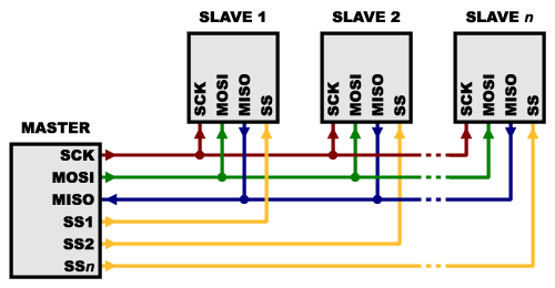

Serial Peripheral Interface (SPI) - https://learn.sparkfun.com/tutorials/serial-peripheral-interface-spi
  • SPI devices communicate in full duplex mode (separate send an receive lines) using master-slave architecture. There is always only one master (usually a microcontroller), but there can be multiple slaves.
  • There are 3 lines (MOSI, MISO, SCK) common to all devices and one line (SS) specific for every device.
  • MISO (Master In Slave Out) - Slave line for sending data to the master.
  • MOSI (Master Out Slave In) - Master line for sending data to the peripherals.
  • SCK (Serial Clock) - Clock pulses synchronizing data transmission generated by the master.
  • SS (Slave Select) - a pin on each device that is used for waking up / selecting the slave with which the master wishes to communicate. SS is active low, meaning that a device is awaken when its SS line is pulled low. This enables multiple devices to share the same MISO, MOSI, and SCK lines.
  • Only the master side generates the clock signal.
  • The master must know in advance when a slave needs to return data and how much data will be returned. This isn’t a problem, as SPI generally talks to input devices with a very specific command structure.
  • You don’t want two slaves activated at the same time, or they may both try to talk on the same MISO line, resulting in garbled data.

20MHz resonator – provides an external clock signal to the microcontroller.
1uF capacitor – connected between VCC and GND for noise filtering<
10K resistor – pull up resistor for the reset pin
R_pullup – 1.5K pull up resistor on the D- line identifying the USB device as a Low Speed device to the host.
3.3V diodes – together with the 100Ω resistors, they form voltage clippers on the D+ and D- lines.
0Ω resistor – jumper that controls whether the board can be reprogrammed by another device.
NOTE: After you program the board, you must remove the 0Ω resistor, and you must also cut the trace leading to the VCC pin on the 6-pin programming header.
Let's now look more deeply not just at what is the function of those components, but also at how the need for those components arises. That is, how would we reason about designing this circuit if we did not have the board as a reference.
We are interested in creating a programmer. Thus we need to first be able to program the board, and then disable the possibility of reprogramming it once it has been programmed. Reprogramming the board requires that the RESET pin be pulled LOW, which means that at other times that pin should be pulled HIGH. In other words, we need to design the circuit in such a way that the reset pin is HIGH by default, but when a programmer is connected to the board it can pull the pin to LOW. Hence we need to connect the RESET pin to both a pull-up resistor and also the RST pad. The value of the pull-up resistor in this case is irrelevant. Any resistor between a few KΩ and a few hundred KΩ would suffice.
Once we have the board programmed, we want to disable the possibility of an external device reprogramming it. By severing the connection between RST and RESET, 0V can never be applied to the reset pin, and therefore our board cannot be reprogrammed. For this, we could use either a jumper (0Ω resistor) that can be removed once the board has been programmed.
When programming the board, an external device is supplying the reset signal. But when we are using the board as a programming, it is this board that needs to provide a reset signal to another board. Thus, our board must be able to control the voltage at the RST pad. Hence we must also connect the RST pad to an I/O pin.
To reduce power supply noise, we can put one or more decoupling capacitors between VCC and GND. To suppress noise of wider frequency ranges, we can use several decoupling capacitors in parallel, each with different capacitance value. The usual choices are 1uF, 0.1uF, 0.01uF.
While the ATTiny has an internal clock, we can use achieve higher speed and accuracy by providing an external clock signal using either a resonator or an oscillator.
The USB data lines should never go above 3.3V as per the USB specification. However, since the ATTiny will be powered by the USB power line (5V), the output of its I/O pins will be ~5V. Hence we need to regulate down to 3.3V the maximum voltage at the I/O pins that would connect to D+ and D-. One option would be to use two 3.3V regulators. But a cheaper solution is to create two voltage clippers, each consisting of a 3.3V diode and a resistor.
To identify our board as a USB device to the host, the USB standard requires that a 1.5KΩ pull-up resistor be connected between one of the data lines and 3.3V. This 1.5KΩ pull-up resistor on the device side overcomes the 15KΩ pull-down resistor on the host side, thereby pulling the corresponding data line HIGH. If D+ is pulled HIGH, the board would identify itself as a Full Speed device. If D- is pulled HIGH, the board would identify itself as a Low Speed device. On the FabISP, On the FabISP, the D- line is the one being pulled HIGH with a 1.5K resistor connected to 5V. On the FabOptimus, this is R_pullup. However, we notice that there is a discrepancy between the USB specification and the FabISP, because according to the spec, the pull-up resistor should be connected to 3.3V, yet we are connecting it to 5V. The proper approach for resolving this discrepancy would be to use a 3.3V regulator or clipper between the pull-up resistor and the 5V line. However, we can get away without this extra step. If we follow the USB spec, then the voltage on the pulled-up line should become 3.3V*(15K)/(15K+1.5K)=3V. If we don't follow it, and connect the R_pullup to 5V then the voltage divider equation yields 4.55V, which may damage the host. Nevertheless, because we have the 3.3V zener diodes connected to the data lines, the voltage on each data line can never exceed 3.3V. Thus we can get away with connecting the 1.5K resistor to 5V directly. Since the voltage cannot exceed 3.3V regardless of what resistance we use, and since we don't have a 1.5K resistor in the inventory, could we simply use a 1K resistor? Trial and error shows that if we use a 1K resistor then we do often run into errors when reading data from the device. Therefore, R_pullup must be 1.5K +/- 5% as the USB specification demands.
A lingering question from the previous paragraph is why is R_pullup connected to the D- line and not the D+ line? In other words, why is the board identifying itself as a Low Speed device to the host, rather than as a Full Speed device? The V-USB package only supports Low Speed (1.5Mbaud). Full Speed is 12Mbaud. (There is also High Speed at 480Mbaud, which is 40 times faster than the nominal max speed of the processor, and clearly a non-starter). Full speed would require hardware support or much faster software emulation - it may be achievable with overclocking and very clever code.
The last question to be answered is why should the VCC pin on the 6-pin header be disconnected once the board is programmed? The expectation is that any board that we want to program with the FabISP would supply its own power, rather than drawing power from the FabISP. By disconnecting the VCC pad from the FabISP, we are ensuring that the FabISP will not attempt to power a device that is connected to it. If we don't do so, then both the FabISP and the device being programmed will be drawing current from the same USB port, and the port may not be able to supply enough current.
