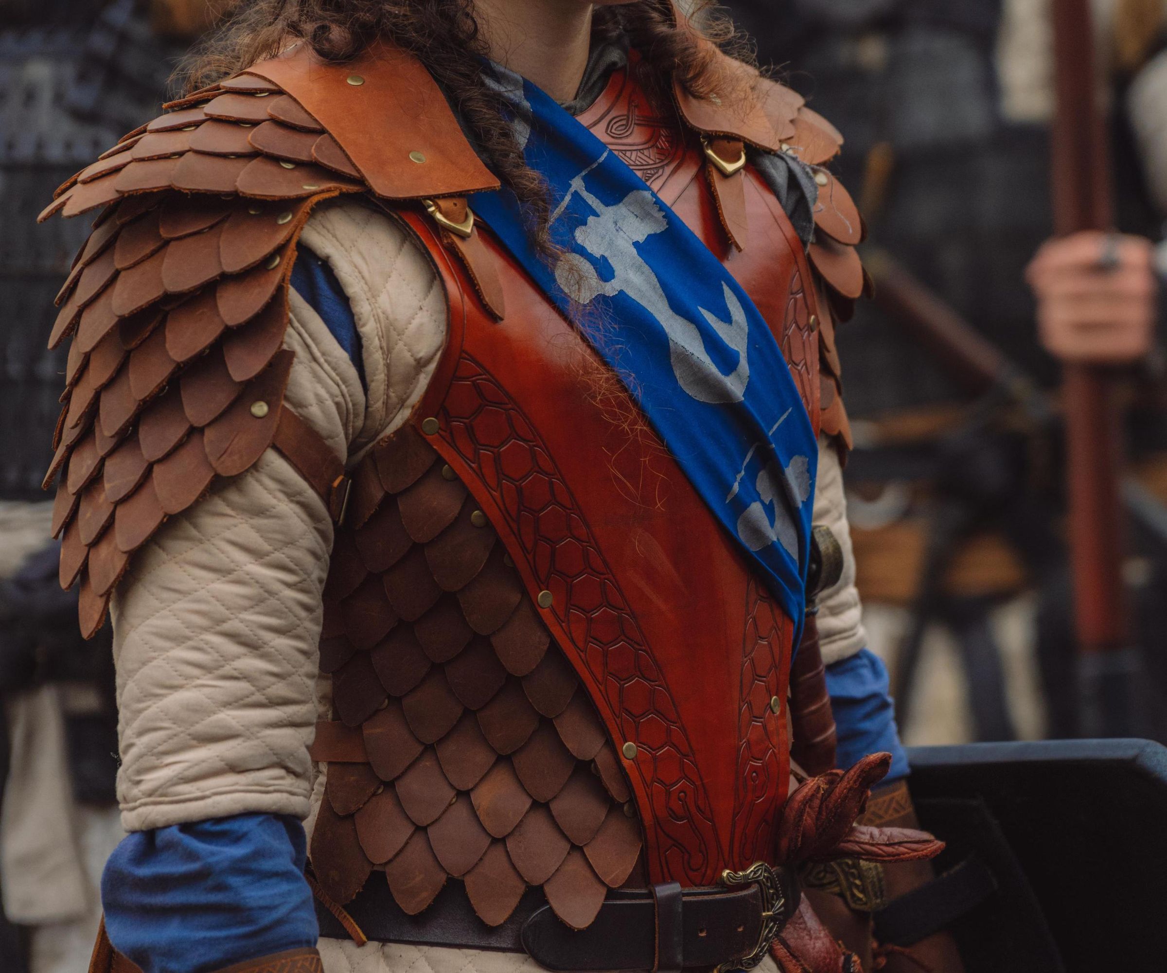

You made it! There were definitely difficulties along the way and hand sewing it all gave me new calluses, but I'm very happy with it and surprised at how well it turned out. I might make and add sleeves eventually, but right now I'm happy with how it is.
A few learning points:
- If I make this kind of thing again, I'm definitely going to research proper dart methods before just launching into the deep end head first. I probably should have put a dart in the middle back as well, because it bunches a bit.
- I should have put the buckles up a bit higher, the last one now sits a little below my belt which isn't a huge problem, but the top gaps a bit.
- I finally figured out what I was doing wrong with my sewing machine so I need to practice using it to make larger scale projects like this.
It's done! It feels really nice to wear, it's warm and comfortable, and has great mobility. I went to a fight event and wore it fighting in the shield wall for two full days, and it wasn't bad at all (it also didn't break which was a plus). I also felt extremely cool.
Pair it with a sword belt, armor and a cloak and you're ready to go!
