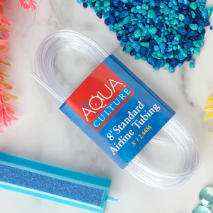

Aquarium pump airline hose (Wal-mart 8’ $1.88) Note: oxygen tubing at Ace Hardware is a better choice because it is rated to handle volatile oils.

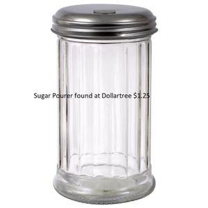

Sugar pour jar (Dollartree $1.25)

1. Connect the glass piplette to the end of the air hose. Depending on the size (width) of the pipelette, you may need to modify it so no air escapes around the pipelette seal where to two meet. I used a hot air gun to heat the end of the hose so it would fit inside the pipelette to seal it. I also wrapped the pipelette and air hose with aluminum foil to add protection from the essential oils. At full strength, EO's can melt plastics. (see image)
2. Run the other end of the air hose thru the sugar jar lid hole where the sugar comes out (SEE, NO DRILLING). Use caution as NOT to break the pipelette while working with it. It is very fragile.
3. Connect the air hose to the air pump.
4. Add your essential oil to the sugar jar (about one inch depth should do it). The sugar jar will be your combustion chamber.
5. Turn on air pump to lowest airflow setting and adjust pipelette so it is touching the bottom inside the sugar jar and bubbling (aeration) the essential oil. As the oil is bubbling, the aerated oil particles (1-3 micros) will escape thru the space/hole in the sugar jar lid you just ran the hose thru. You will begin to smell STRONG essential oils immediately.
