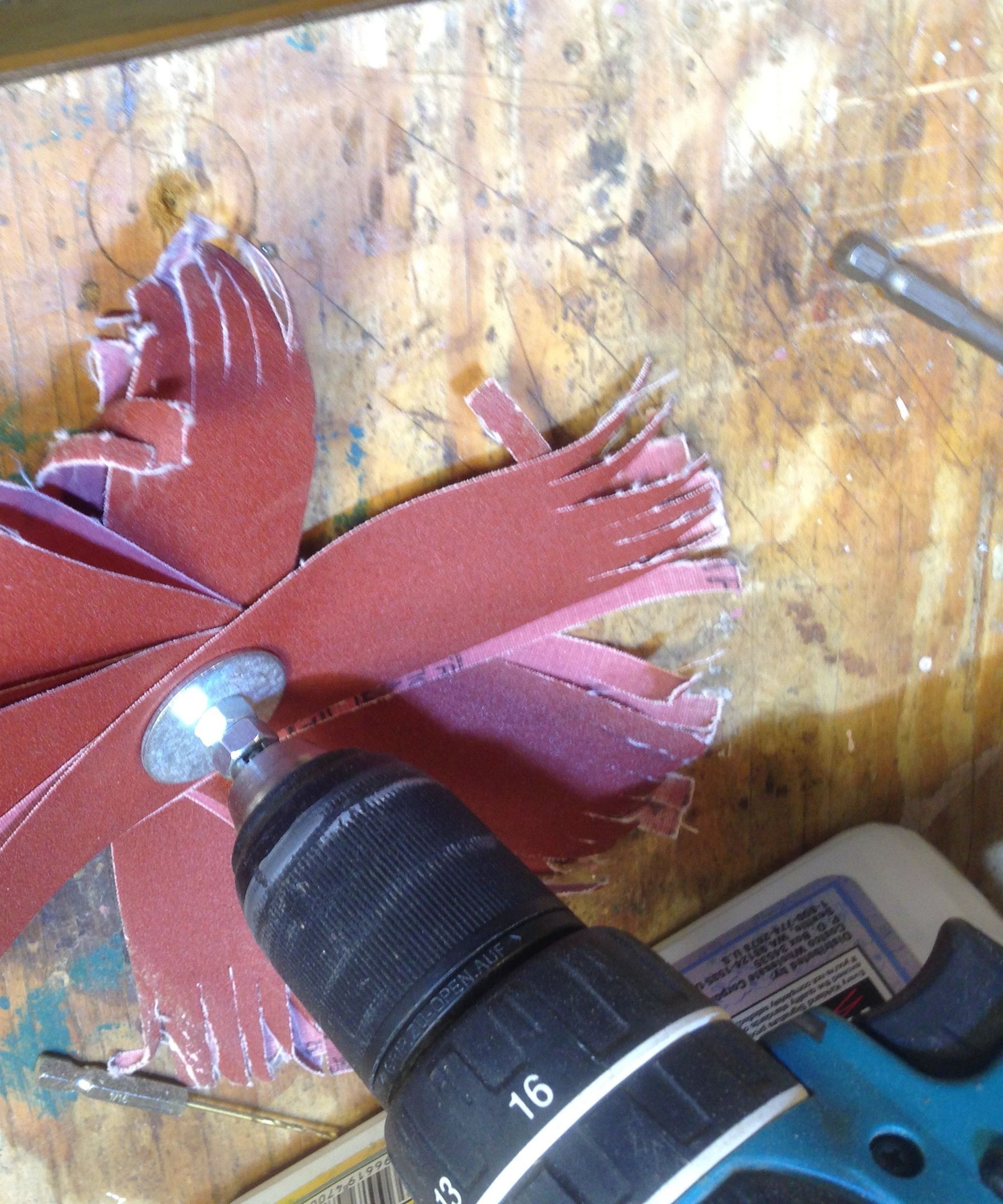

- I started out trying to use velcro on the sanding head with velcro backed sand paper - expensive and didn't work out really well.
- Then tried a regular roll of sand paper and the threaded rod on a nut (see the photos above) to hold the sand paper in place - it worked for a little while then I got a little rip in the sand paper and it was all over.
- Ended up using self adhesive sand paper - seems to work best. Need to use a heat gun to remove it though, but it doesn't tear itself apart nearly as badly as other methods seem to.
