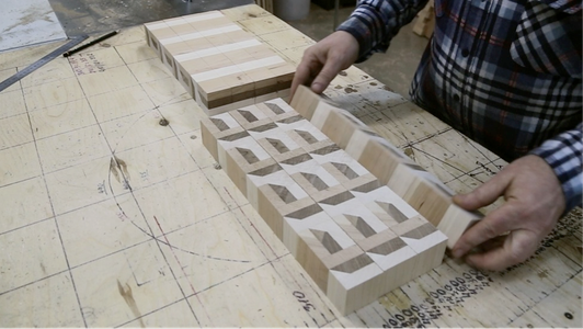

Step 6: Making Two Boards
The next step is making two boards. These boards consist of two types of the blocks you just made.
Glue the boards.
Next day plane the boards. Pay attention to another one walnut corner.

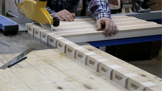

Cut off four strips from each board.
Rotate all strips 90 degree end grain up.
Assemble the cutting board.
Glue the cutting board.
Glue also sacrificial rails. These rails will protect the cutting board edges while planning. Front rail is necessary to ensure a smoother entry the board into the planer. Back rail is needed in order to prevent tearing out the grain at the exit the board from the planer.
